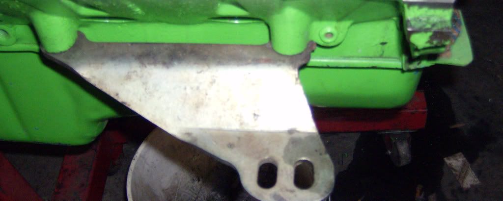

thanks for the info hotrod i have the motor mounts done i used dirt track style mounts in it and i mocked up so mustang shorty's too im going with a c4 trans an a s10 rearend for now i had one laying around with 3.42 gears in it

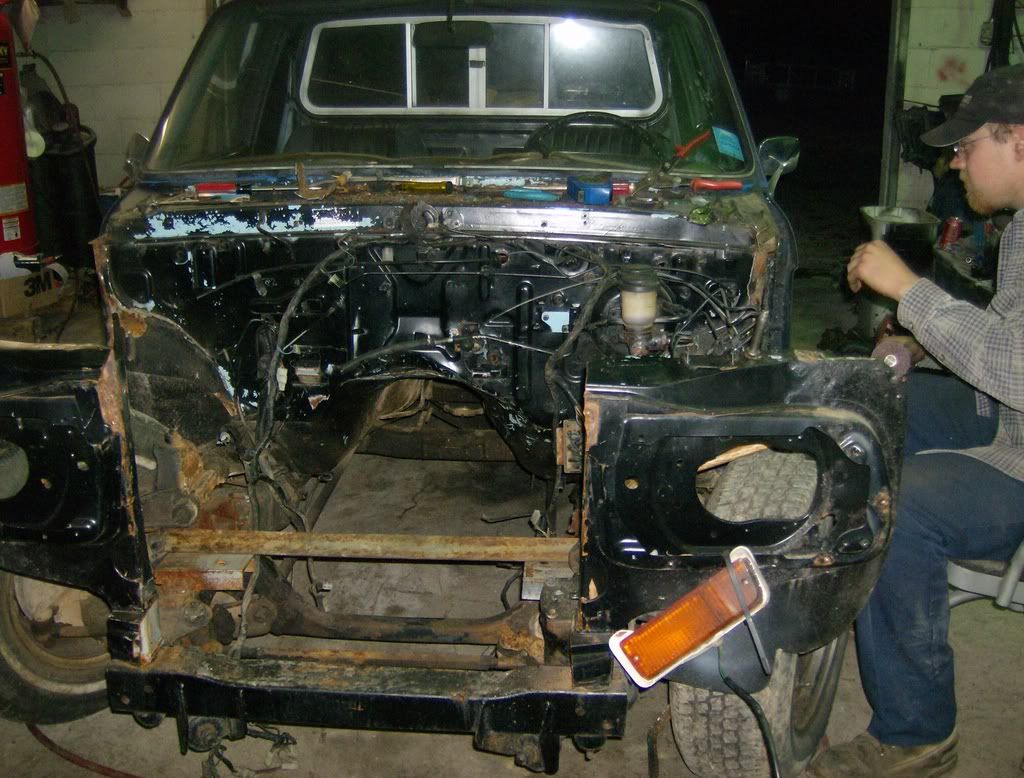

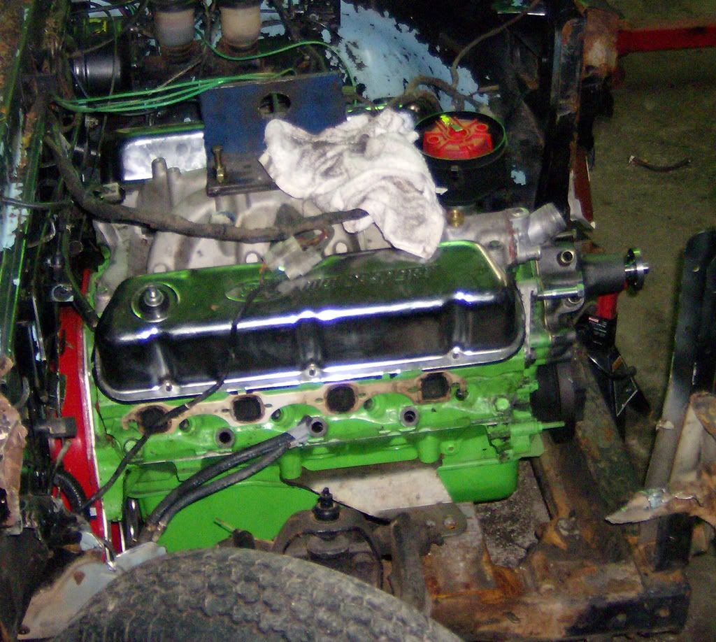

testing posting pictures if it works this is it in the truck

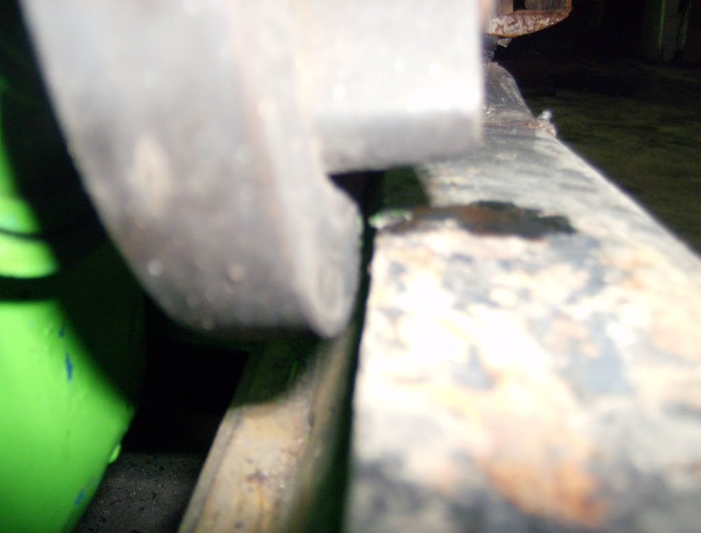

ok heres the clearance on the balancer to the crossmember

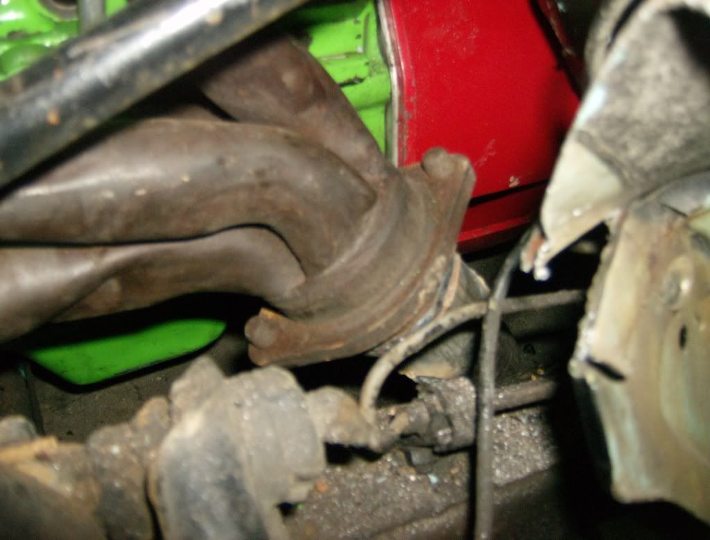

ok heres the mustang shortys mocked up
motor mounts

PostPosted: Sun Jan 06, 2008 8:47 pm
8) Looks like the water pump is gonna give ya fts...

it as far back as it can go the driver side heads is 1in away from the firewall

oh and the water pump should clear im going to run a Griffin aluminum radiator with Electric Fan and make the hood a pin on
