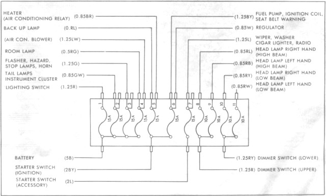

does anyone have a drawing, or can explain how the wires are situated in the fusebox. (ie. acc goes to wipers, ect and power goes to fuelpump, ect). when i got my luv the wireing was all butchered and im to the point to fix it. i will hopefully get pictures of it up by next week.

thanks ben, only have to get the blinkers working now. sounds like a great project for tomorrow

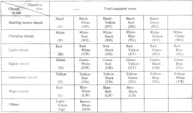

I have an official Chevrolet shop manual for a 76 LUV. Bought it years ago from some guy at a swap meet here locally. Unfortunately it's showing it's age but it still comes in handy.
Most of the book isn't too special but the electrical section is superior to anything in the cheaper Chilton or Hayes manuals.
Let me know if you want a scan of any other pages.
