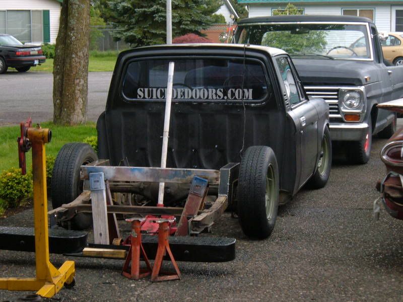

35% is very easy to see through I have 20% on mine right now but after its finished Im putting on 5%.
Heres mine

That lowered Ford F100 in the background is beautiful. Got better pictures of that?

Here ya go
http://forums.luvtruck.com/viewtopic.php?p=105087#105087
