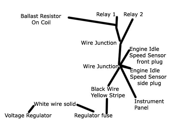

I created a wire diagram from the wires off the Regulator Fuse (see below).
I used a voltage meter and checked for continuity in all the wires from that fuse.
I also unwrapped all the tape around the wire harness in the engine area, and traced the wires to make sure nothing is grounding out. The wires going to the Engine Idle sensor and the instrument panel are in good shape.
Since the fuse blows after the truck warms up. Usually it blows after I take it for a test drive and not just idling in my driveway. I'd prefer to replace just the damaged wire, but I may end up going with a wire harness. Could something else connect to the instrument panel blow the fuse after it warms up?

If you open that part of the harness up back to the little junction box right along the fender well on the passenger side, there are little silver boxes that if i disconnect them my truck dont work right or work at all, but there should be a black and yellow wire there in part of that junction i think that part runs back to the coil and another runs straight either to the ignition switch or runs to the fuse box first:
""" "" http://www.luvtruck.com/PDF/Series9&10.pdf "" """
I dont know if the link will show up but its un the info section under wiring harness the black and yellow in one way or another runs to the regulator psrt of the fuse box, if you want to know if you are going to have any problems with it then run another wire straight to the botow side of the fuse box and run a temp hook up to the place where the black and yellow wire meets up, make sure you dont jump the fuse though, and disconeect the old wire from the coil and hook you new temp one, if the fuse blows then your relay might be shot and over loading the circuit, or you got somethign grounding out along there some where....
thats all i got for now just let me know hoe it goes

The problem with hooking up a temp wire to test each wire, is that the black-yellow stripe wire conects into plugs on Engine Idle Speed sensor, and on the relays. I'd have to cut the black-yellow stripe wire to islolate it from the other wires in the plug.
I was also thinking of buying the two relays, it may be simpier than splicing the wirse with a temp wire.
What are the two relays called? Napa has two of them on their website.
One is called the "Accessory Relay Connector" and
The second is called the "Blower cut off relay". Then again those two could be under the dash somewhere.

Well i understand not wanting to cut back any wires or anythign like that, but i asure you that the only thing slightly resembling a relay under the dash are just the flasher units and some cut off switches for the neutral start type stuff... But if the relays arent too expensive then i would suggest getting themwho knows it could cure the problem
