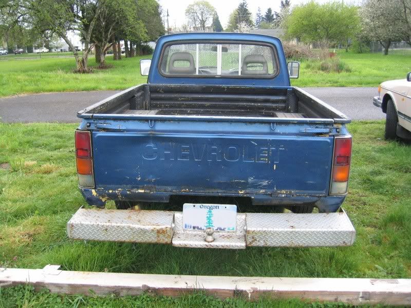

I started out with the bumper sitting on a box behind the truck in about the right spot. Here it is, with the nuts & bolts on it ready for insertion.
Then I lifted it into place and held it up with my knees while getting things started. At which point I realized thet the 7/16" bolts are a smidge to big for the upper holes... I got 4 bolts in the lower holes and all tightened up, and bought the extra two 3/8" bolts on the way home. Those will go in first thing tomorrow morning.
In the mean time, here's how it ended up looking:
1978 shortbed fleetside, th350, Fireball 231 Even Fire V6, Edelbrock 500CFM Performer with Edelbrock intake. Workin' Truck.

nice...looks 10 times better then the bumpers i see around on the luvs here

It has a few fresh coats of Rustoleum on it to make it shiny, I went over it wit a wire brush in my drill before spraying it - had a little surface rust on the frame bars and the back. Other than that the original paint was just a little faded.
We'll see how the Rustoleum holds up to general abuse. :)
Mainly wanted to follow up so that others could get the right bolts ahead of time, and not have to waste the time test-fitting - that thing is kinda heavy and hard to hold in place while sitting on the cold cold ground.

Thanks much for posting the bolts needed for this. The bumper I got from ctmandu yesterday is on today becuase of it! Not quite as nice as yours, but then, neither is the truck :lol:

You should see it in person.... the pictures are a little misleading... ;)

It looks good Stephen.
You don't see too many straight front or rear bumpers on these trucks. I don't know what it was about these LUVS... people that bought them liked to hit things I guess. :roll:
