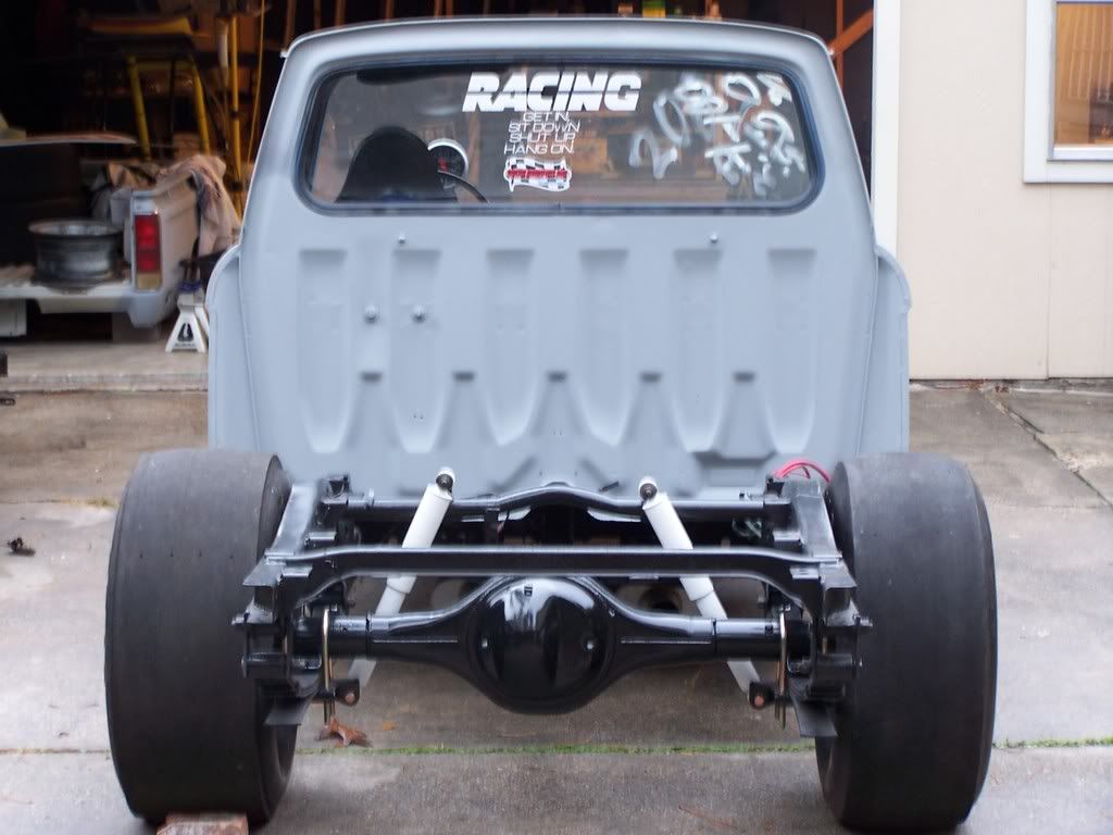

ok here is a picture with a 10.5 left side and a 9 on the right, this is a 15x8 with 4.5 inch back spacing.....notice the gap from frame to tire.
this is a 15x8 rim with 4 inch backspacing wheel and the tire tread was even with the outside of the bed, i never had it hit the tire at all

4.25 " is the most backspace that will fit in a stock set up . I also run 15x8 4.50 with a .25 spacer . A 10" rim will just move the tire out further . Just to make sure we are talking about a true 10.5 tire , not a 10.5W . It is pretty close as you can see by the pictures .

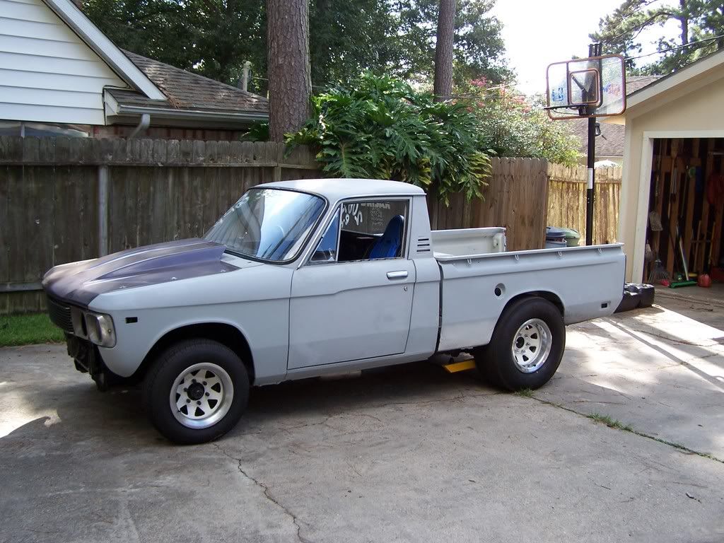

28/10.5/ 15 slick with 8.5inch rim and 4.5 basckspacing will work u have to grind the frame smooth all the way across, fold the inner fenderwell lip in, and bea the ineer tub so the tire its then frame first
here is an old pic of mine
