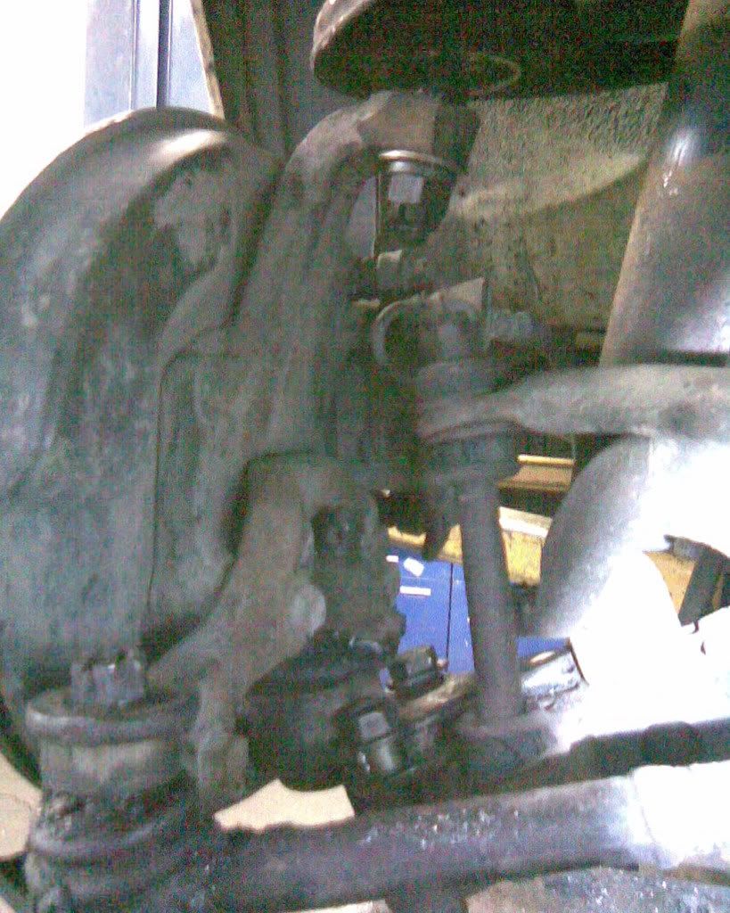

ok, here's the update...
Got the toyo spindle assems on, but it was actually kind of a pain. First you mount the toyo BJ on the LUV lower control arm, so you have to drill a hole thru the arm for bj hole #3 and some other little things. Anyways, maybe if more people are interested ill go into more detail, but it works great! I slapped some stock jeep rims on there with some thin tires. All my clearances look great, no prob turning. I aligned it myself on my machine and everything was adjustable just like stock.
I kind of feel like a did a little bit of a hackjob, i mean, it took: the bench grinder, my die grinder, my cut off wheels and a couple spot welds. With a lift it took 3 hours for the first side and 2 for the second. I dont like the LUV upper control arm tho. I'm doing some research into SPC to see if i cant find one that will actually come UP front the mounting position, but bring the ball joint to enter the spindle square and even.

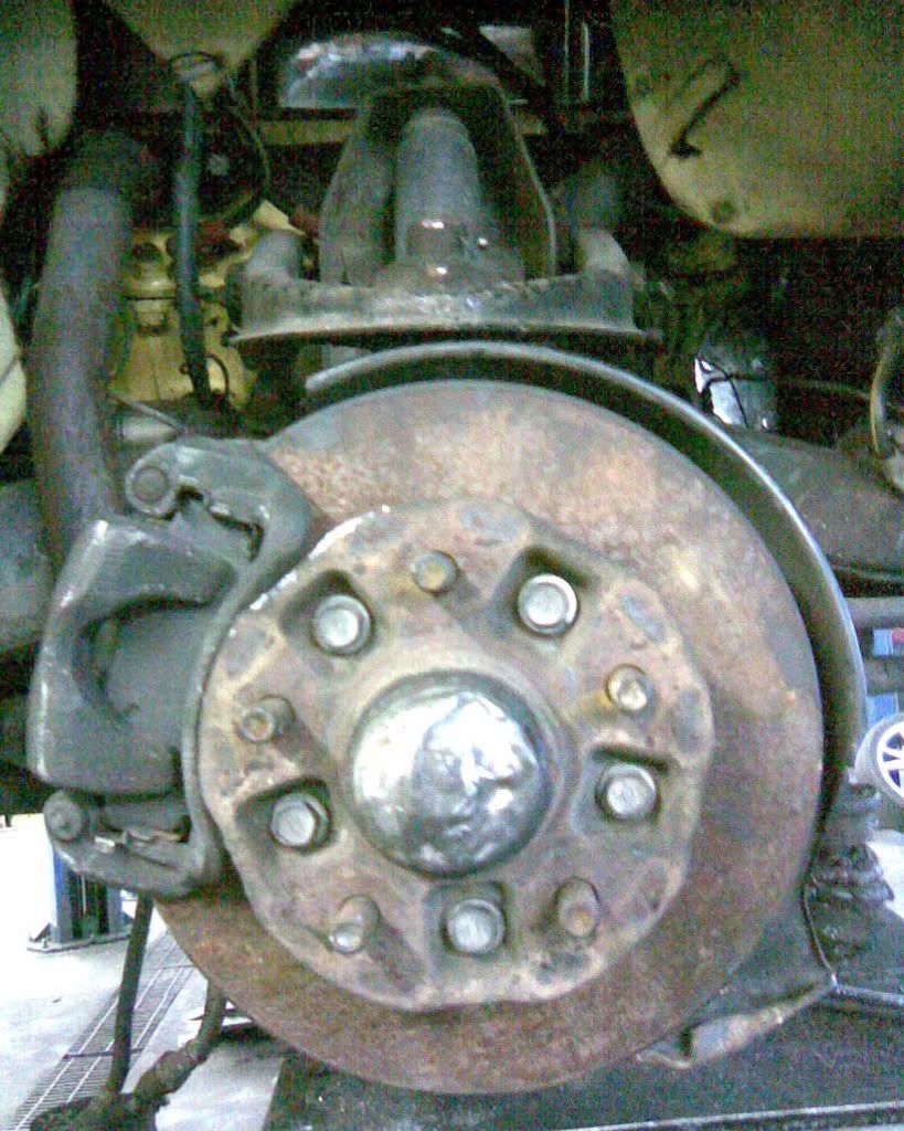

look ma, 5 lugs! All done with the conv, bought some craigies for the front and found some old tires in my basement. I'll have to go with a thinner tire, then I can knock down the tortion bars. I'd like to streamline a procedure and a parts list but no one really seemed interested.
wow, thats kind of a bad pic, sorry. What you cant see is how nicely they tuck into the fender well and its on an incline
1975 LUV with a caddy 500ci, 12.5-1 comp, 850CFM holley sucking E85 through 110 jets and torquing the hell out of a TH400. Currently @ 6mpg

It's been raining here since last night and i;ve been trying to get out to pull a wheel off and take some detailed pics. Im unfortunatly not very good at taking pictures during a project. I tend to "zone" a lot, you know, not even threats from your wife can get you to come home from the shop.
I think the one step that needs some outside ideas is my lower balljoint setup. Its stout, but i was trying to think of how to do this for all you LUVERS out there who may not have a lift or a welder, or a big selection of tools for that matter.
The TOYO B/J will mount on top of the lower control arm with 3 holes and the stud goes up. The Luv b/j mounts on the bottom of the lower control arm with the stud pointing up, not to mention the strutbar (or strut arm) is held to the lower control arm with the 2 inner bolts of the b/j. so i drilled a hole through the arm just south of the weld for the lower shock mount, this serves as 3rd hole for the toyo b/j and you can still mount the strut arm ontop and use the original bolt holes for it too.
I'll stop there and post some pics. A helpful hint for those who want to do this too, is get some 3/8 i/d steel piping to cut for shims. Like i said, ill post some pics and you'll know what i mean.
