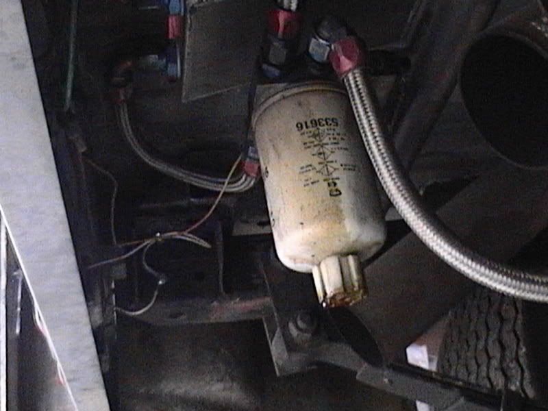

look at the frame where i rImageelocated the mount

This mod will set the pinion angle a bit more negative than before. If you're running alot of power to the tires, this may benefit you. The pinion angle will want to angle downward because of the load to the tires. Some adjustments may need to be made to the rear (traction bars, slide-a-link or what have you). If there's some kind of adverse effect, going back to stock shouldn't pose too much of a problem. Tell us if it works out.

Did you narrow the stock frame rails? I run the same size tires 31X18.5 and had to narrow my frame to 17 1/2 inches and because of the ladder bars travel I had to use aftermarket rails.

I narrowed the frame 14.5"s using the frame rails out of another luv truck now i'll probably catch it for cutting up another luv.I have some pic's of how i boxed the tow frame rails i will try to post them. blue meanie you are right about pinion angle but i ladder barred the rear so on mine that was taken into consideration. On a stock type rear i think a 2-4 degree pinion shim would take care of any problems. I well try and post some pic's of the frame.
