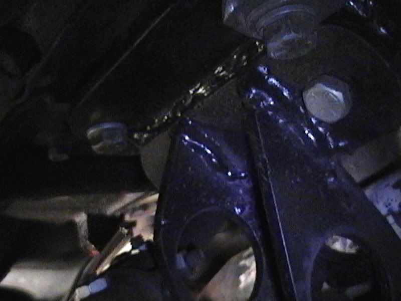

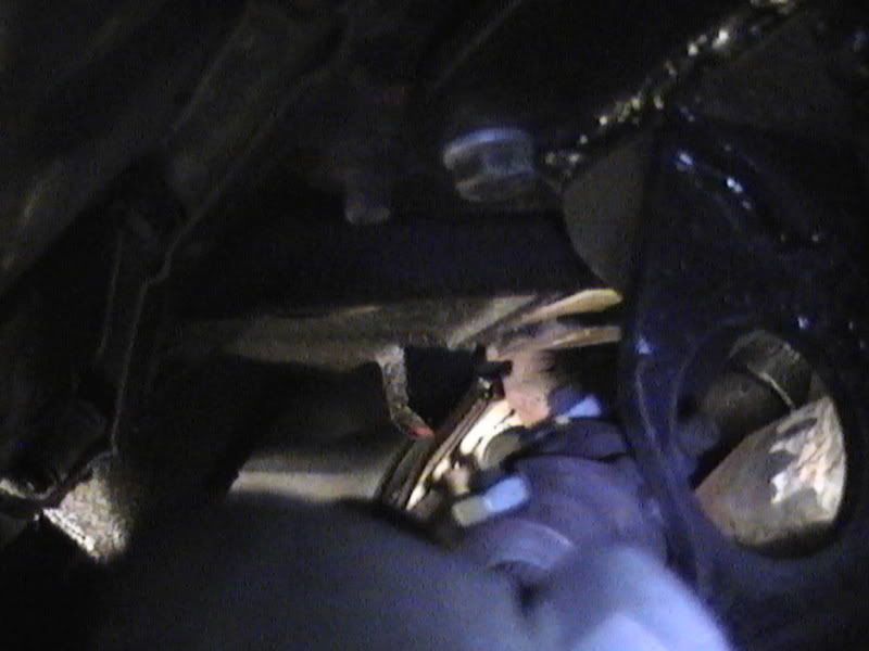

Due to inquiries i took some more pic's of the steering and toyota brake conversions on my truck the rack come off a 78 pinto then i machined off the mounts ( hang to lImage
ow ) and made my own

HUH :? I lost something with your terminology,but i will try, the rotor as you are looking at it is still mounted and the pic. is the way it looked when i took it off. The reason for the pic is to show how the Pinto tie rod bolts to the LUV arm.I thought of reaming the tapered hole but it would not leave enough material to be safe.

tj, Glad you shared your pics. I have a question though. It looks like you used the stock luv arms with the pinto rack. Was the rack used due to a clearance issue with the Buick engine?
PostPosted: Fri Nov 10, 2006 7:55 am
mytmouz The rack was installed for several reasons,one was it took about 40-45 lbs off the front,it steers allot better and more precise,and the fact that i like rack steering as well as nobody seems to do it.As for clearance the steer shaft would have cleared easily but the advantages of rack steering are the way to go.
