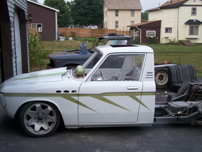

Here are a few, I'll get more probably tomorrow....
driver side view

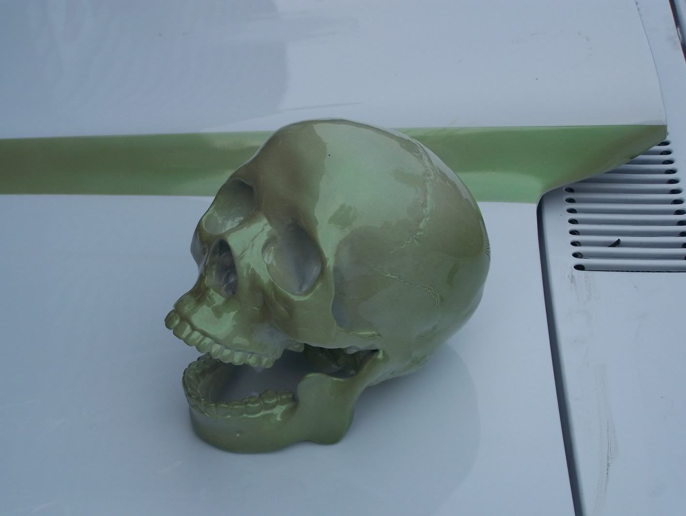

pearled skull that my switches are goin in

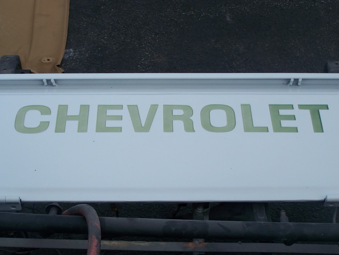

tailgate w/letters pearled
still need to do some touch ups, wet sandin & buffin......

I'd like to hear the details of the hood. The cowl looks modified.
PostPosted: Sat Aug 26, 2006 5:55 pm
Posts: 440
Location: Bowling Green, Ky
its modified, good eye 8O
It is actually a fiberglass corvette cowl, my dad and i cut a section out of the hood, tucked the cowl underneath, between the outter skin and the reenforcements. We then put it as close as we could to the windshield for the race look, then glassed the inside and outside. An old skool trick for an old skool truck.

the blue that was on it before was so cheap primer, whoever sprayed it was horrible, runs everywhere.
I'll try and get some pics over the bed, the front end. The suspension pics will be later cuz I gotta fix the 2-link, but when done def. get some pics up

how low can you get that front to lay out?i am baggin mine soon and was thinking of flipping the lower ball joint......also do those wheels tuck?i was thinking of using chevy fullsize 17" wheels off of the 06-07 and they have the same backspacing as the cadi wheels
PostPosted: Thu Oct 19, 2006 9:42 pm
Posts: 440
the wheels tuck perfect, not sure on the backspacin though. heres a side shots of the truck with front down, it lays on the tie rod brackets, still gotta cut them, plus its sittin on my carrier bearin bracker which I need to make a new one.....
