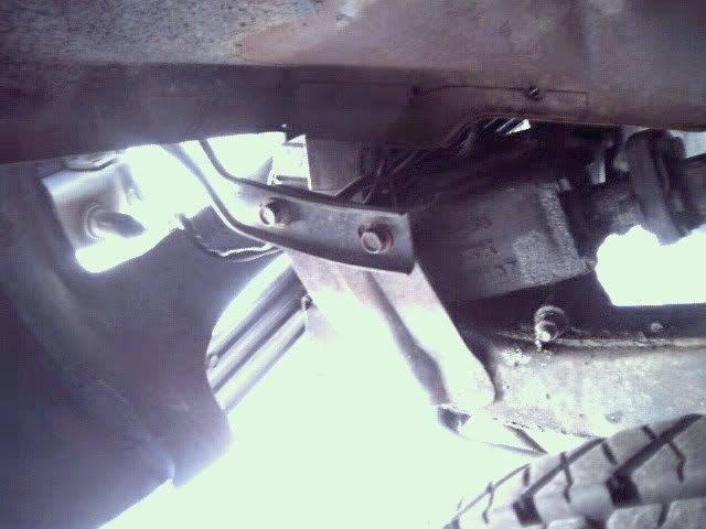

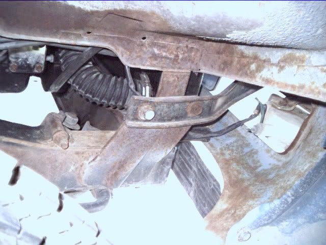

ok, so I am swapping over my 72 headlight/grill to the 76 two headlight set up. So I pulled off everything from the 76 and was gonna put it on the 72, and theres a problem when mounting the bumper. These things are welded on the frame (see pics). I know I'm going to have to grind them off, shouldnt be too hard just time consuming, but Am I going to have to drill the 3 holes and what not for the bumper mounting brackets, because I didnt see any, but I was wondering if anyone else has run into thie problem and what they did or found to be easiest. Thanks

I think you're the first to come across such a problem. Looking at the pics, it shows that the mount brackets are destroyed. Here's what they look like:
Either find some at the junkyard or fab some new ones.

I see what they originally looked like now. I am swapping on the 76 bumper, so I am just going to grind the welds off and take those brackets off since they are screwed anyways, and just go get the 76 brackets welded on since it will be easier to weld them on than try and drill 3 holes in the frame for them to bolt onto like they did in 76. Thanks for the pictures :D
