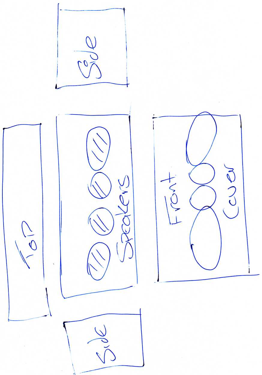

With the box installed theres no room left for the jack, tools etc. The front panel is double thickness, two pieces of board glued together. The speakers are screwed into the the second piece, the top piece has holes larger than the speakers cut out. Im running the speakers off a 400watt 4channel amp, im very happy with the sound quality. The box isn't sealed so i havn't added a port.

oh okay so there is no back. cool cool. thanks a bunch :-) and i appreciate the fact that you even sketched it out for me!! :-)

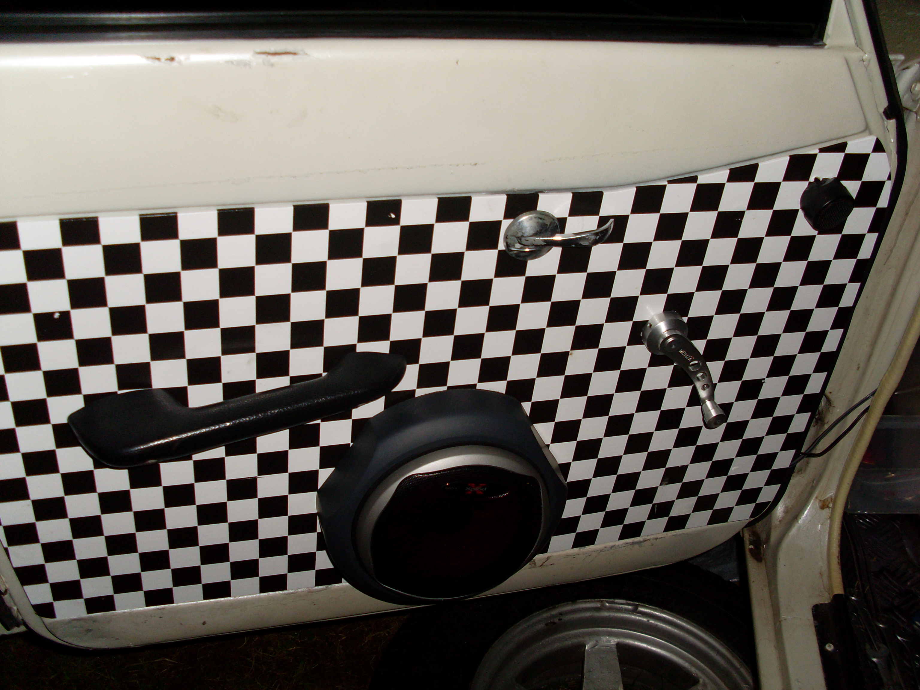

I thought id add my 2 cents worth and I went for the install in the door (see attach) which is not a goods photo but you should be able to get the general idea. I used a spacer and 6.5 speaker and just simply drilled em in and they sound great. Plus the other way iinstalling into the door would mean a lot of cutting metal and measuring and dodging the door glass window. I was gonna go the rear seat install but figured it would drown out the quality of the speaker sound (it would be good for a sub as its all low frequecy going through but with mids and highs I dont think it would be a good quality sound (just put a pillow over a 2-3 way speaker and see what it sounds like)...but thats just my view and not intented to offend anyone who has gone to great effort to install behind seat. I like the above the head install as it would give great sound as there is nothing in front of it. Also I have installed a few sub and speaker systems in my time and realise there is a lot of space under the glovebox area and i have had my eye on those cylinder type subwoofers (with inbuilt amp) and it would tuck up nicely under the glove box (plus this would allow for the passenger to still stretch there legs out in an already not very big leg room). or the the other spot i was considering for my sub was removing the heater and fan control unit (dont know if thats what its called...) which divides the driver and passger leg room. cheers hope this may help someone. Also I might add that i used splits and this is ideal because you can then control where the treble is best situated to get those beautiful highs...

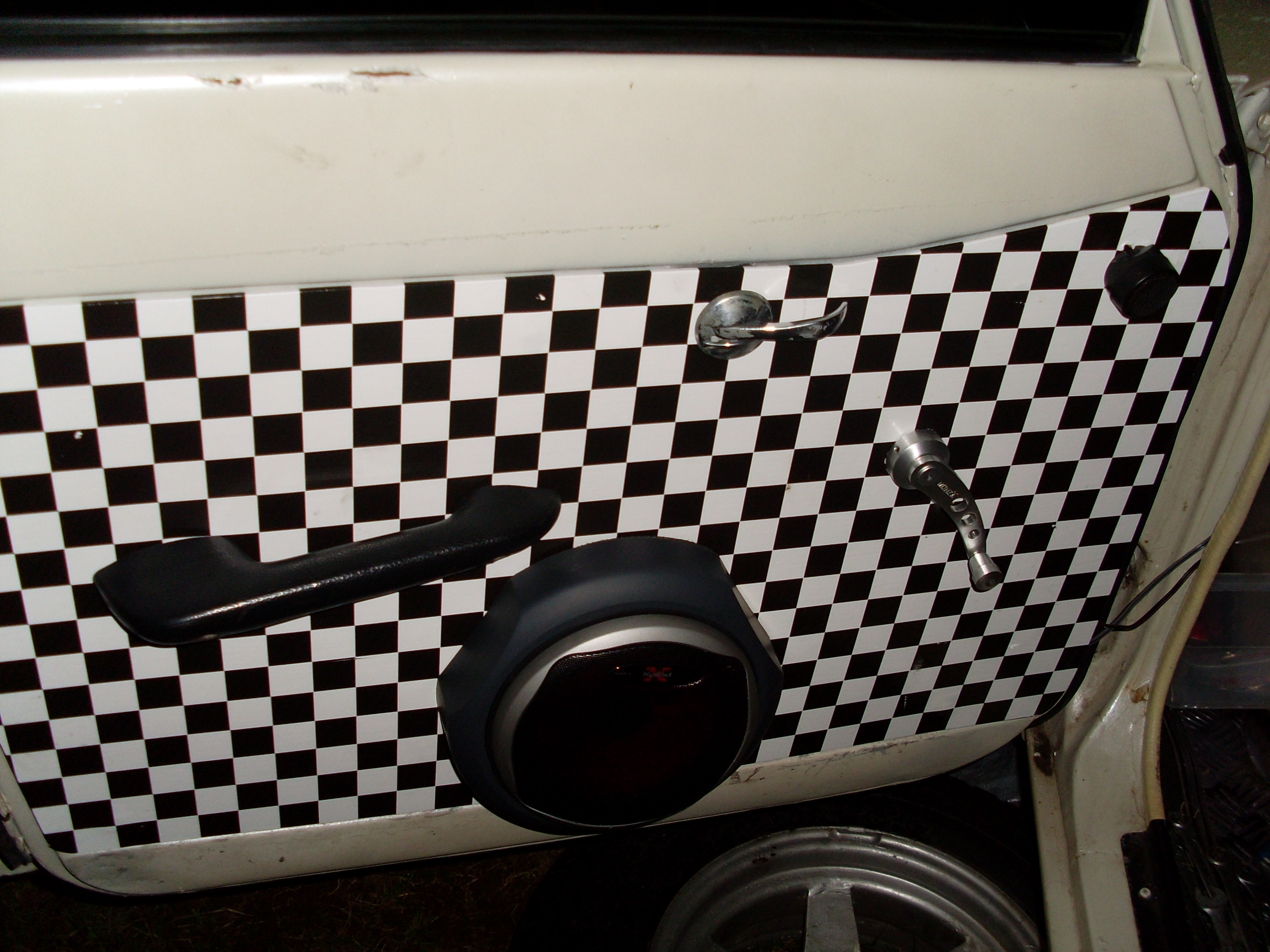

Better pic of me speakers below :D
