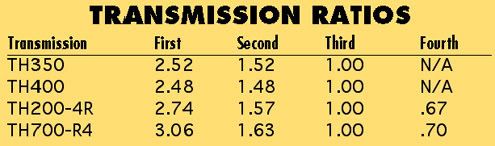

Don't know if you've seen the Luv V8 Engine swap article listed on the main page, but it is a budget swap, and will give you lot's of help. One thing of note is with the th350, you can use a Camaro driveshaft and will not have to make one. The other thing is for gas mileage you want the 700R4. It has a much lower first gear. You can come off the line and have a better 60 ft. time than a th350. You will also get about 33% better gas mileage than a th350.

Hey luvstruck. With sticky tires and a nine inch rear i break aftermarket racing parts. As to the choice between a 700R4 & a turbo 350, I would go with the 700 in this build. The dimensions of the trannies are about the same. Much better performance and mileage over the turbo. I would use one that came from a V8 application. At 300 horses it should hold up. Just make sure the TV cable is properly adjusted. This causes a lot of the 700's problems. It should be a fun ride.

Im with you luvit80, big thumbs up for the 700R. Three point something gears in the back and it will roll along the open road at a nice economical RPM. 3.08:1 was the common fit and from memory on 215/60/15 tyres that got you under 2000 RPM at 65mph. Id aim for 3.5 gears or pro stock look tyres under its bum, 4x4 tryes with highway tread would suit the job and they will carry a load too.

yes the 700R's have an extra clutch pack but unless you get one out of v8 car there know to slip under the torque, v8 ones can hold up to it as long as your not doing any hard launches with slicks

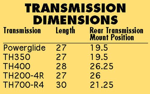

whoever said that the 700r4 is the same as a th350 with an extra gear is incorrect. the 700r4 and the th350 do not share any interanal parts that i know of. they are completely different transmission all together.
also, a 700r4 is pyhsically diffrent from the th350 also. the 700r4 is 30 inches long opposed to the th350s 27 inch length. also the tranny mounts spot is 21 1/4inches back, while the th350s is 19 1/2inches. in the early 90s the 700r4 was reworked in a sence. GM fixed alot of the little problem areas of the tranny and called it the 4l60. later on it was made a computer comtrolled tranny, called the 4l60e
now the 2004r is also alltogether a different tranny than other GM trannys. they all came iwth a universal case that made it so you could bolt em to any GM motor.(chevy, buick, olds, pontiac, cadillac) they do share the th350s length of 27 inches, butthey have the same tranny mounting position as the th400. it also have the 27spline output like the th350 and the 2WD 700r4.

Yeah I Never Meant The Gears Where The Same....If It Came A Cross That Way I Apologize ( Don't Think I Did Though )But 1st n 2nd Are Much Lower Gears In A 700R Compared To A TH350
