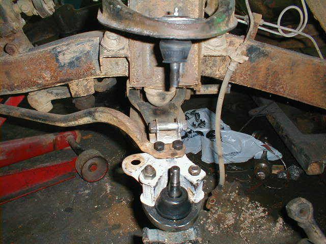

I am a little confused on your setup for your homemade 1/2 inch steel bracket that the ball joint presses into. What keeps the ball joint from coming out of it's pressed in location. Let me explain my concerns. Your pic shows it pressed in from the top. There is a flange on the ball joint that seats onto the bracket. This I see clearly. However what keeps it from coming out? If one is using coil overs then the coils are in effect trying to push down on the lower control arm. The lower control arm is trying to pull away from the ball joint, hence putting constant pressure to disengage the seated ball joint. that is how I see it. Hope someone that is an alignment specialist can explain away the security question I have.

Not sure but when the spindles are bolted in won't that in itself keep the ball joint from coming out since it is bolted in from the bottom up.

Well what keeps them pressed in on a s10...camaro...monte carlos and just about everything GM made with this style suspension...the same aspect would apply here the hole is a tight fit and has to be pressed in to make it work.......they is however ball joints with lock rings that I guess would work as well. If there still is a major concern you could weld the ball joint in the plate. This would be pointless in my opinion.

the lower ball joints on my 87 chevy 1/2 ton are pressed in from the bottom of the A-arm. the arrangement as shown for the s-10 mod for the Luv is in my opinion not safe. Unless there is a locking ring on the botton that is not being shown. If there is a locking ring to keep it from pulling out then that would be satisfactory. Welding should not be an option

Then This would mean every vehicle out there with lower ball joints pressed in from the bottom of a a-frame/control arm is unsafe, all of your camaro, novas, chevelles, monte carlos, s10, full size trucks, corvettes and just about everything out there with a A-frame or Control Arm style of front suspension is unsafe. GM....Ford.....and many others have used this style of pressed in Ball joints
Measurements were taken from both the s10 control arm and the ball joint to ensure tight fit and were double check roughly 10 times before they where cut at my friends machine shop.
Welding isn't a option just some people appear to not have faith in a product that has been used for years. But for the people who believe this they are the ball joints with lock rings which it wouldn't be hard at all to use them with this set up.
Would this also mean the pressed on pulley set up for power steering on a GM is unsafe as well? I mean what is keeping them from just flying off? Theres no bolt that holds them it just tension from being pressed on.
This would appear to mean that the term and the idea of press fit anything should be banned for unsafe reason and should be removed from everybody's memory of ever being a method of holding two things together.

Still disagree. it has to be pressed in from the bottom of the flange to be safe. the setup as shown is trying to be forced apart by the action of the spring and up and down forces from the road. hit a bump on the road the tire is going to be forced up....the spring is trying to keep it on the ground. the weak point is the ball joint. it's only force holding it in place is friction. it has no bolts or slip ring on the bottom of the flange. Unless of course this is not shown in the pics.

The ball joint is pressed in from the bottom of the flange/plate. Everything that was done to the truck would have to be done the same exact way on a S10.....this is starting to drive me nuts, but I am gonna keep my cool to try to make a understanding one way or another with you. I need to figure out how to understand you or you need to understand factory GM suspension.
I understand your point of view of what may or could happen, But I don't understand why you believe so when all that holds it in from factory is tension and friction. These parts where all bought for a S10 and where installed the same exact way you would have to if you installed them on a S10. Maybe we need to look into this a bit more, What keeps the ball joint from being the "Weak Point" with the GM application of this method on a S10.
There is no lock ring on the setup I used However they could be used. Fas as bolts I don't know of any right off hand of any that uses a bolted in lower ball joint that would work with a S10 spindle.
If you believe there is something I am over looking please explain because I still am not getting whats is the root of all your concern.
