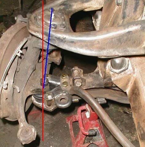

Thanks Again, Here Is I Guess A Very Poor Example of A Very Rough Example of SAI
This I Know Is Nowhere Near A Exsact Angle Nore The Best Angle For A Picture I Will Try To Get A Better Pic and Idea.

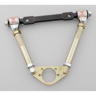

But You Could Slightly Change The SAI With The SPC Performace Control Arms. They Probably Make Something That Will Work With A LUV.
I Need To Do Some More Research But From What Jack, A Local Guy Who Is A Suspension Exspert He Says It Looks Like It Should Work "Lovely" He Doesn't Agree With Me Doing Away With The Torsin Bars. But He Seems To Like The Idea and Has Bee Working With It With Me
