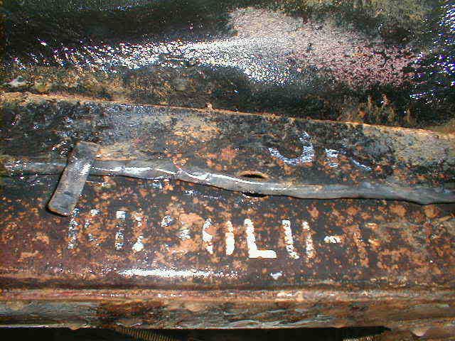

Anyone Know What These Numbers and Letters Mean On The Passenger Side of The Frame Just Under The Rockers.
Would Say It Says Something Like KB30LU-B With Something Else Above It.
I Wished I Noticed Them Before I Washed Part of Em Away W/ The Pressure Washer. :?

not sure what the lettering is, I dont have any on my 84 pup's(luv) frame. Sorry, but most likely its not significant for what your doing to the truck.

I Know The Numbers Really Aren't Very Important, Just Would Like To Know. May Be Getting Another Truck That I Would Like To Restore To Factory and I Thought These Kind of Tagging Would Add That Extra Bit of Authenticity.
Most likely these are #s used by the manufacturer to identify the frame for a particular vehicle build.
Frame was most likely made at a different facility vs the assembly plant where everything was installed onto that frame.
Just a frame ID # used by Isuzu.

Been Also Told Something Close To Tha Same From Blue Meanie
Blue Meanie wrote:
Hi...
Im thinking that the marking reads KB30LU-P. KB series trucks were sold with Isuzu emblems all over the world. And im thinking that they were KB30 series trucks. LU would seem to stand for LUV. The P is for Pick up.
This would make sense to distinguish frame types as they go to the assy line. KB's and LUV trucks were identical vehicles except for the Chevrolet LUV emblems. General Motors had controlling stock intrest in Isuzu Motors during the 70's. Shipping them to the U.S.A. with Chevy nameplates was the norm.
