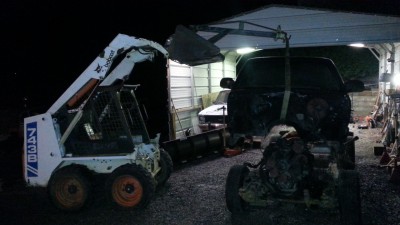

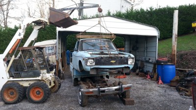

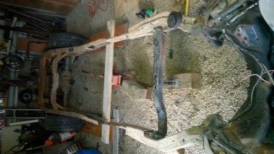

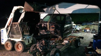

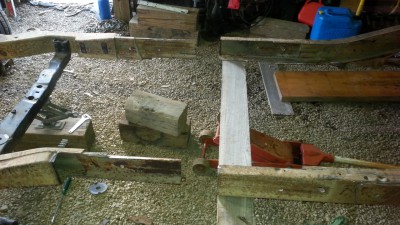

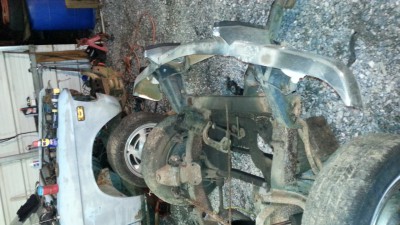

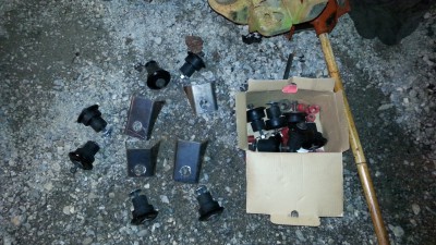

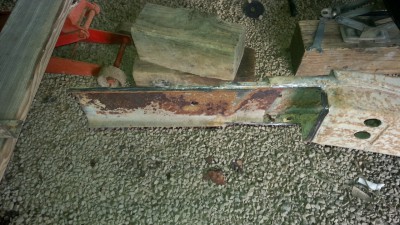

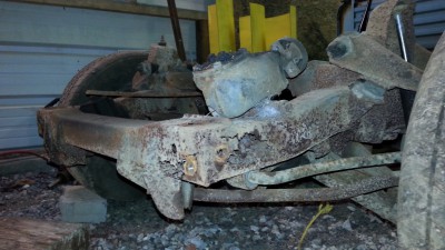

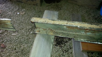

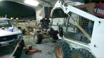

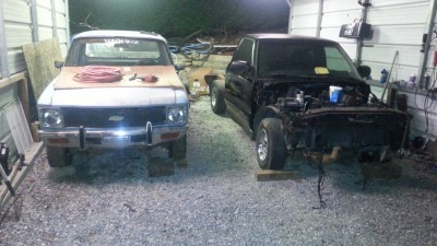

So I am gonna try and post pix as it goes along. Started a few days ago. Here is where it is Tonight. Gonna try to post from my phone. Hope it works.
PostPosted: Mon Dec 14, 2015 7:34 pm
Posts: 95
Pix

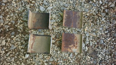

Found these in my parts stash today.

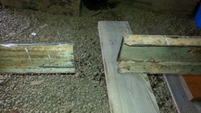

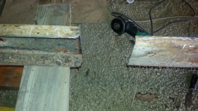

Gonna shorten it 5 inches in the next few days.

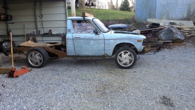

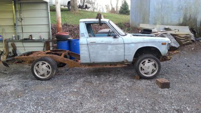

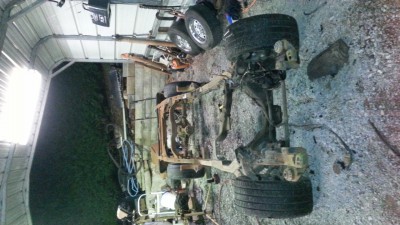

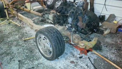

Got the Luv on the S10 frame to do some measuring. Needs to come down 2.5" in the rear and about 4" in the front.

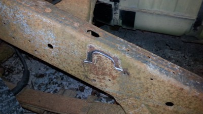

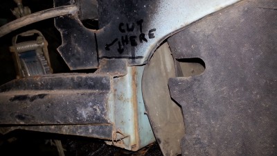

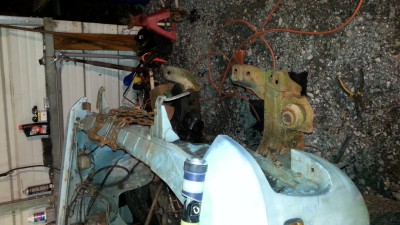

The steering column is 2" off to the left. No problem. And where l'm gonna cut the front support to lower it then make new mounts.

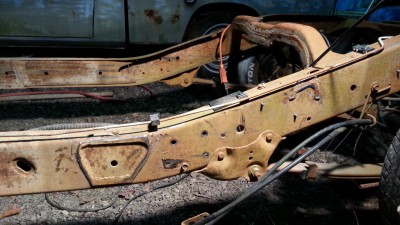

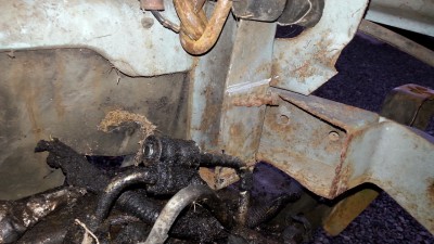

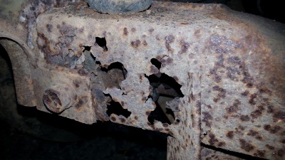

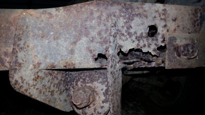

The reason for the frame swap. Front 2 frame mounts behind the bumper on the Luv frame. Plus all the other rust in it.

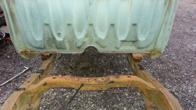

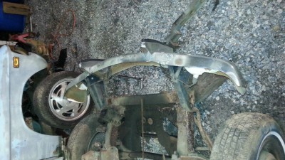

Bumper on Luv frame sticks out 10". Frame on S10 sticks out 10". Close nuff for me. I will cut the S10 frame to fit the Luv bumper.

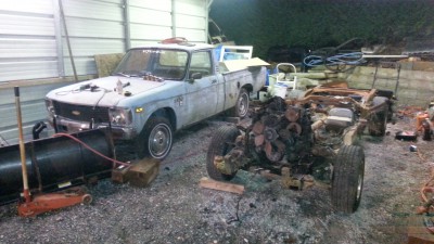

Was at my other place and moved a few Luv's to the back outta the way. And I got the Luv lowered on the S10 frame.
File comment: 79 Mikado 4X4 will be parts for sale soon
File comment: I Like It.
