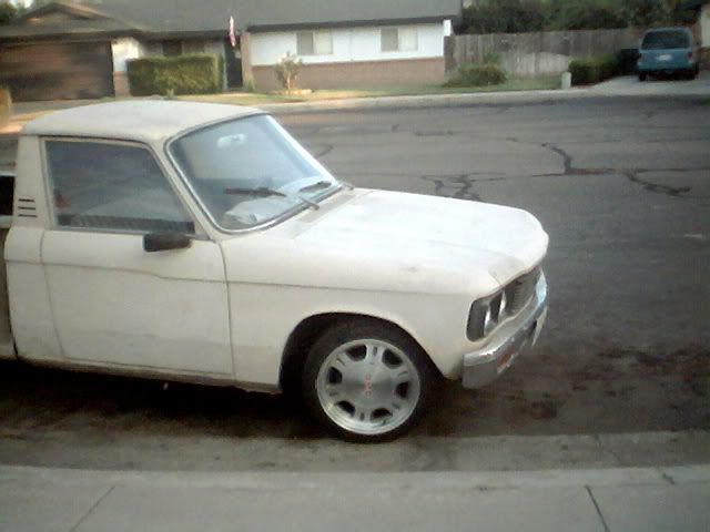

i have the GMC rims on my luv they are 16 with 205-40-16Image
Bigger picture please. I can not see anything... I guess because I am old.. :roll:

here you g oif it needs to be bigger lit me know no problumImage they are for sale if some one want them $350.00 o.b.o new tires on front

on my rims i did't have to for the luv i did have to put a 1/4 spacer on it and they fit good
