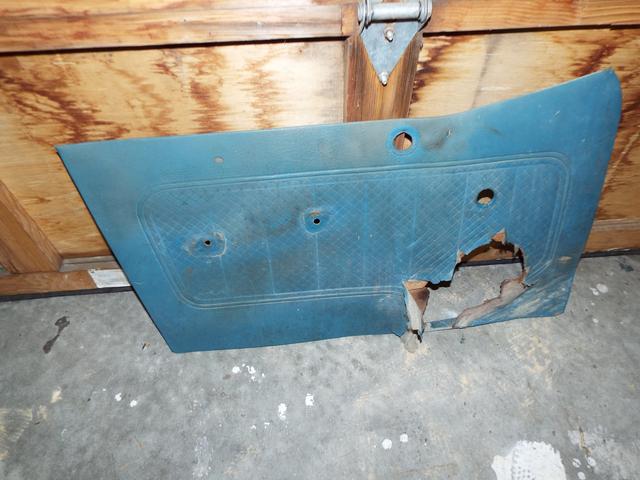

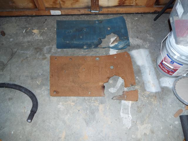

First, got the old panel out. As you can see from the first pic, it was pretty hammered. Got the outer fabric off it fairly easy. I guess the 40 year old adhesive was past its due date.
I then set the old panel board on the new wood and traced it out. Used my handy jigsaw and some 2.0 reading glasses from Walmart to see what I was doing (hey, I'm pushing 50 and diabetic, I'm lucky I can still see well enough to drive legally). 1.25" hole saw works quite well for the window crank and door handle holes.

File comment: Original panel. I think you can see why I'm redoing it. :)

File comment: Poor thing. Looks like a giant mouse took a bite out of it.
