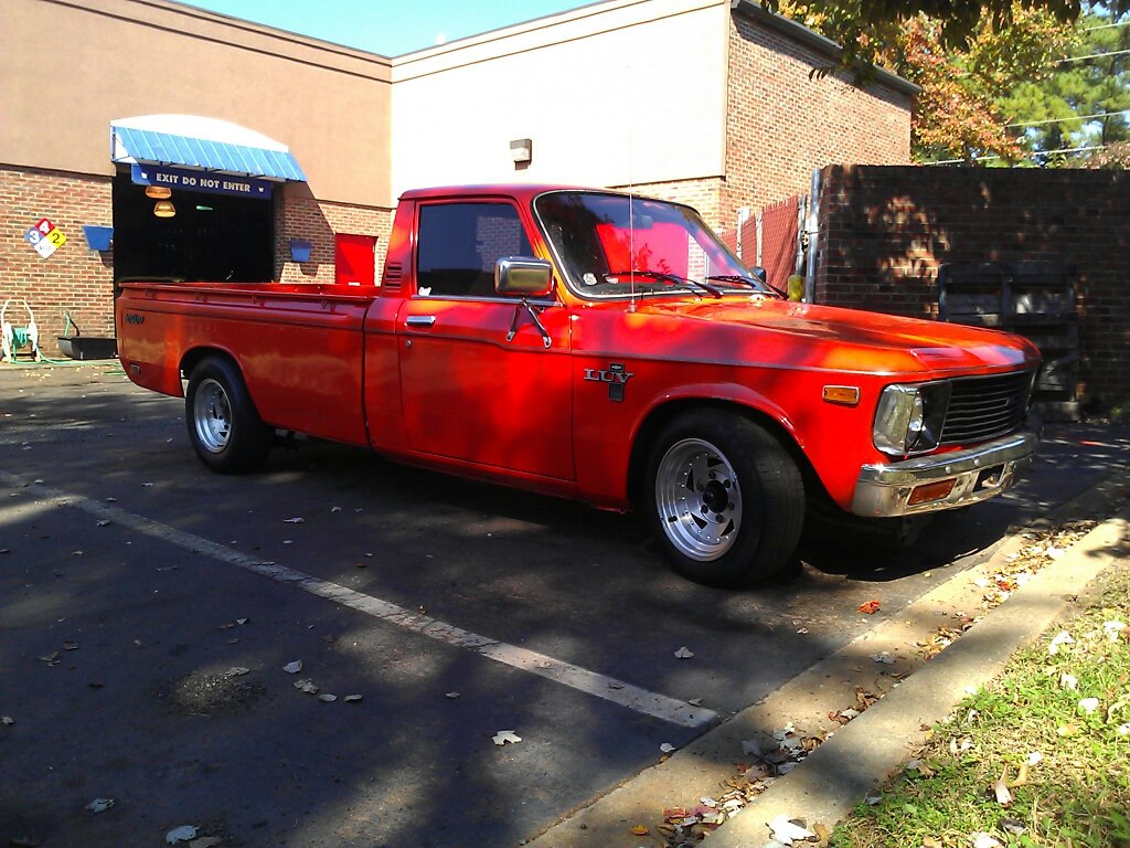

so as far as the mounting of the motor and the trans im not worried. im pretty damn good o fabrication and welding plus ive found all parts needed except trans crossmember for the 4l60e. ive been building and fabing cars and bikes for years and there is a couple sites and companies selling ls swap mounts for the 4.3 and i did find out that with any luv year make or model the s10 mounts will bold in place of the standard stock luv mount location. but you have to buy the ls engine mount brackets that are adjustable from stock to 1 1/2- to 1 1/2+ to allow for motor placement and clearance.
so where can i find the post or place on doing the coil over fronts bc i can fab that. all im looking to do is be able to get rid of the torsion bars for exhaust clearance and also bc this truck is going to end up as a dd with 9" wide front tires and 15" wide rears bc we are narrowing the chassis for 17" wide fitment and using a 78' 4spd camaro rear end with traction bars and new 3.73 posi lock gearing due to a trade.
also for anyone here who can point me in the direction of finding aftermarket wiring and performance parts for the 4.3 vortec i would be in your debt. luckily the only reason i so chose the 4.3 and 4l60e is bc im getting the ecu, motor, trans, and wiring all from the same wrecked vehicle for $500 and if built correctly should be in the 450-500hp range with a massive hp to weight ratio and it should run like a champ for everyday driving. just by using the 4.3 instead of a 5.3 youve had a motor weight reduction of close to 200lbs.
File comment: my 79' Luv Mikado
