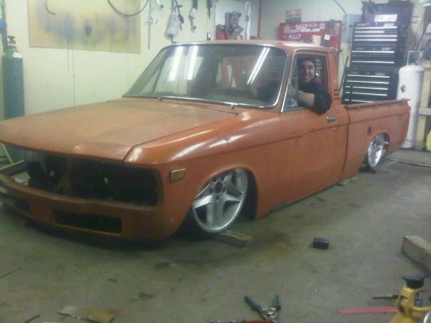

ok so i wanna do a rack and pinion upgrade. i have a 75 luv with dhp control arms in the front s10 spindles and brakes i wanna get rid of the manual steering and put in a power rack. i have noticed alot of talk about pinto stuff but being in canada i pinto in a scrap yard is as rare as finding a luv which is impossible wondering if anyone else has done this conversion and what rack would work. any help would be great thanks guys

dont have an engine in it yet, because a 3 inch body drop and had to z the front frame 2 inches to get it to lay on the ground the stock engine was threw the hood 4 inches even after dropping the mounts as much as i could it was still almost 2 inches threw the hood. i am looking for an rx7 rotary im thinkin that will be close to clearing the hood i dont wanna run a cowl hood

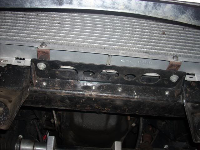

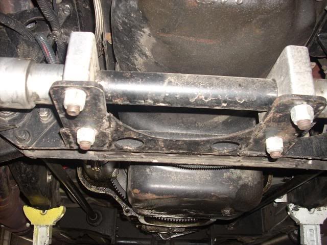

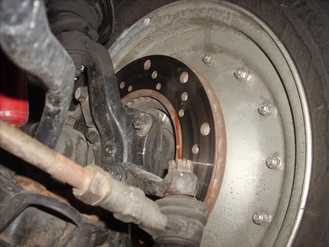

I installed a Pinto/Mustang II in my truck in my avatar by making my own mounts you might search my posts and finds pics of the mount.

would it be possible to see some pics of your rack and pinion setup? thanks!
PostPosted: Sat Oct 22, 2011 2:31 pm
this should help
