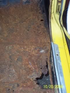

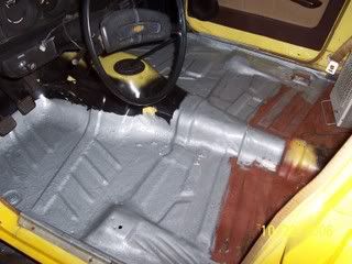

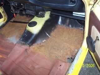

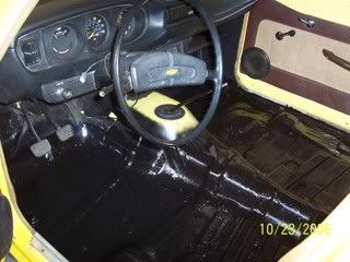

Hey Roadshow, sorry I didn't get to this sooner, but I wonder when you used POR-15 before, did you use a complete kit, or did you just try covering it with their finishing coat? No direspect here intended, it's just a price difference. I'm also concerned because I did a careful job on my cab floorpan, using a floorpan kit, which included several steps of all the right stuff to do the job well, and one member even mentioned putting the final coat on both sides which I did where the holes were. I'm expecting it to last for years and years. Is it your opinion that the product will not last?

i know this is way old, but did you use the fiberglass mat to fix the hole and if you did how is it holding up?

It's all but forgotten, perfect. Truck's running fine, too.
