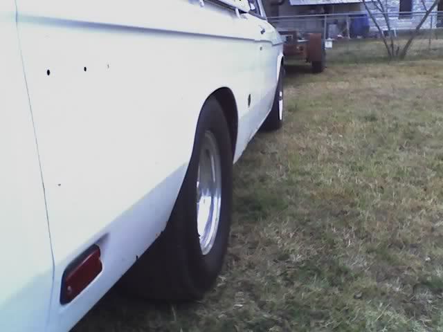

What wheel size/back space, do I need to go with to get the wheels to tuck under the fender on my truck?I have Rear Spacing: 1-3/4'' Do I need a 2-1/4'' Rear Spacing?

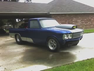

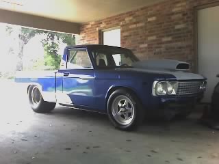

i have some other pics floatin around
16-8 5"bs rear
16-6 4"bs front
255/50-16 rear
225/55-16 front
looks like i coulda squeezed a 8.5" rim in the back with possibly a 265 50 but i know its gettin close to the leafs. that front size fit perfect with the front fenders on my set up. i probably coulda went 6.5 with 4.75"bs but i didnt and im still happy with the combo
i really didnt want that turtle look hence the rim and tire combo i am runnin

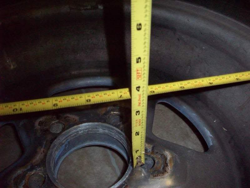

I cant find my reciept for my wheels but if ur looking for something like this I can jerk a wheel off tomorrow and measure one. And my front are stock redrilled Luv rotors.

Thanks my wheels stick out just a little, I would like them to tuck under the finder a little more.

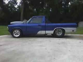

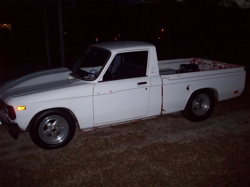

I want them to fit under the finder.I know it can be done just need the right back space.

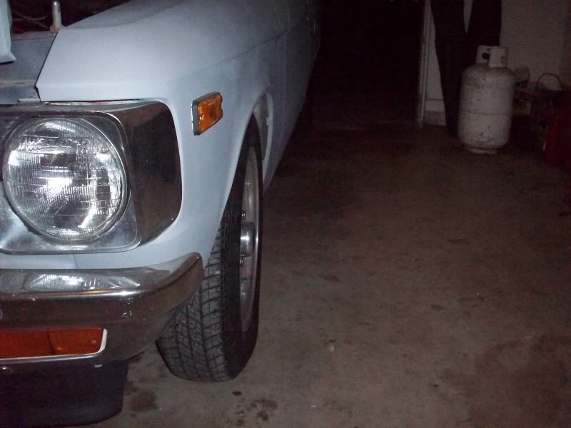

Hell no...Sorry about that man...Mine do tuck better than yours...but again mine are stock luv rotors that have been redrilled..

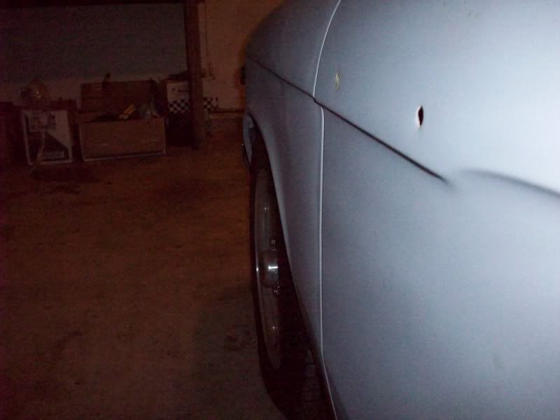

PostPosted: Wed Nov 04, 2009 2:00 am
Posts: 667
here you go 15x5 weld prostars on stock rotors...I have zero clearence problems but do run coilovers..I can take more pics if you think there might be a clearence problem....
