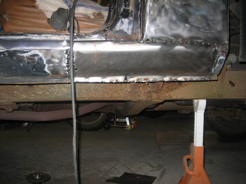

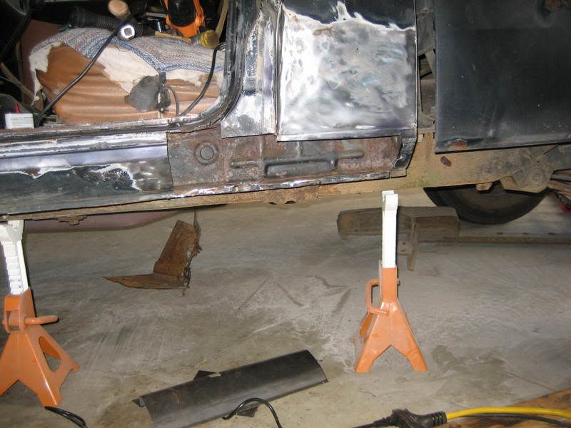

I built a patch for one out of flat sheet metal. I bent the crease using a 2x4. since the rocker is pretty much a strait bend. they are also in an inconspicuous place. the main thing is to make sure you wire wheel all the rust out and put a good weldable primer on the inside. next thing is to make sure you have a way to keep the watter form getting back in or make it easy for the water to get back out so your new panels don't rust.
Here are some pics of my fix. Mine was on an 80 luv Not sure if they are the same on your truck

Gs11x, you did an awesome job on that. I just got a mig welder. Although it's real easy to burn holes in sheet metal. :wink:
