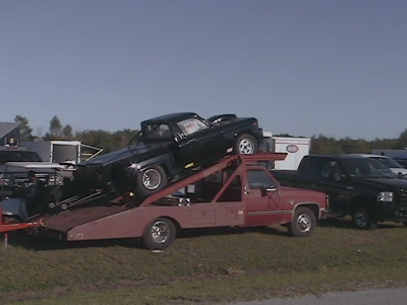

 Post subject: truck
PostPosted: Fri Nov 02, 2007 7:35 pm
Posts: 502
Location: Baytown ,Tx
Hey CT NICE TRUCK!
PostPosted: Sat Nov 03, 2007 8:30 pm
Posts: 727
Location: SPRING,TX
i wish i coud say it was mine but i cannot, it was at baytown for the texas vs the world and S&S race.
