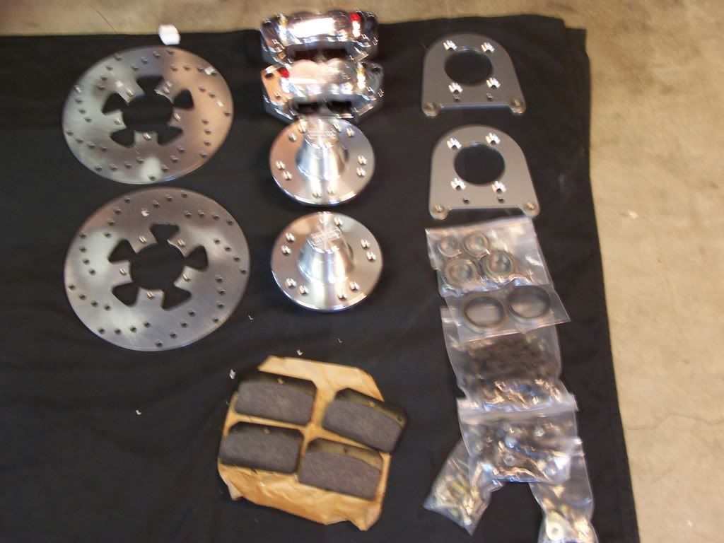

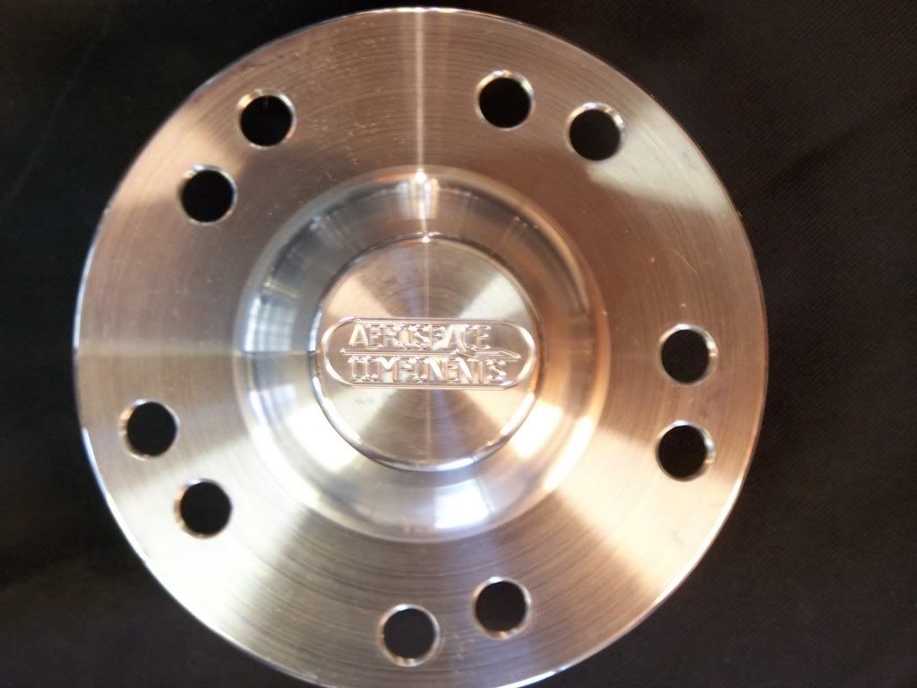

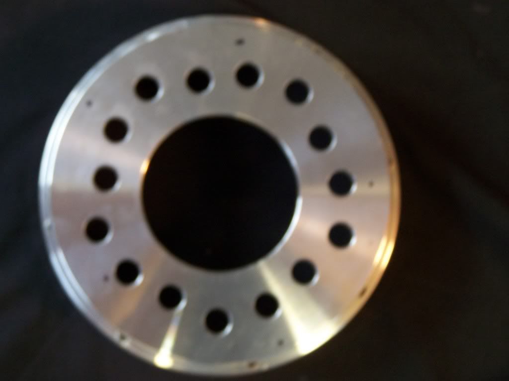

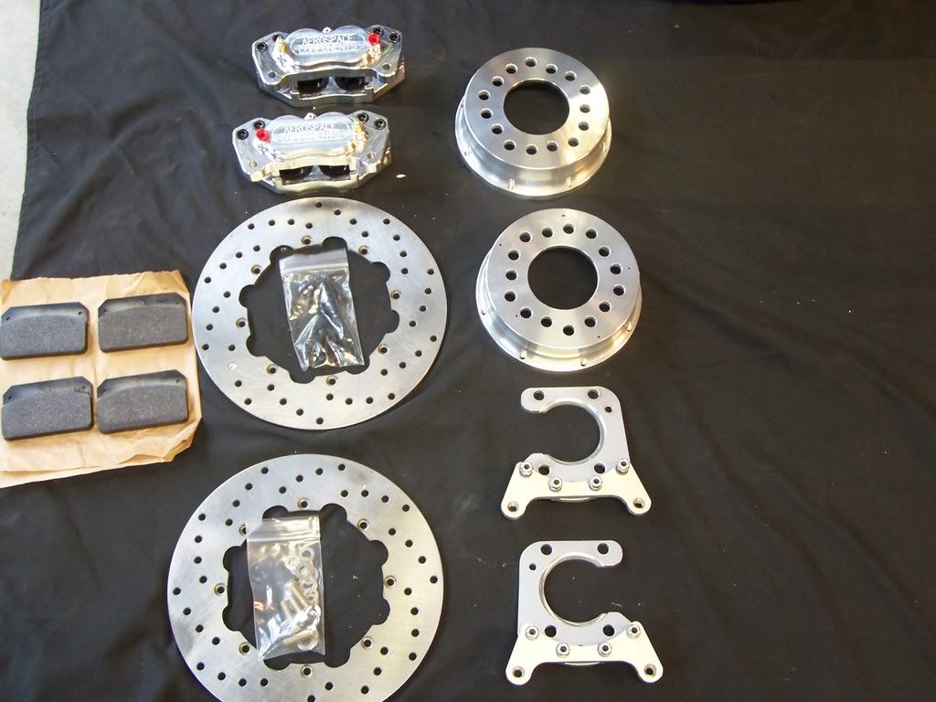

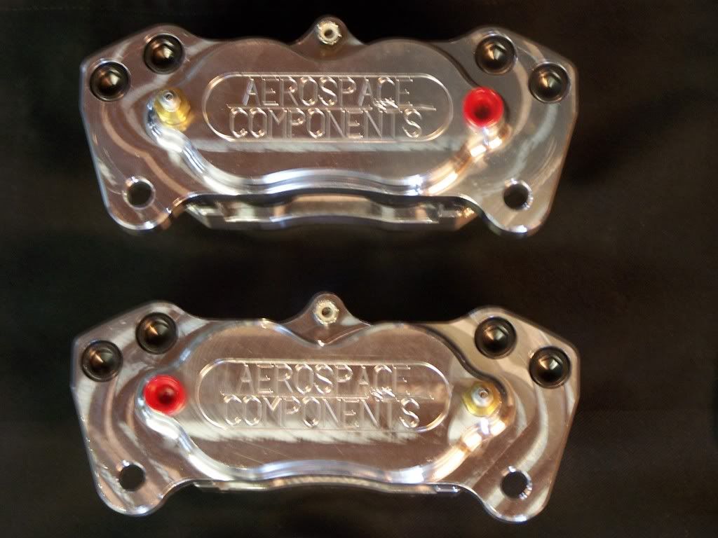

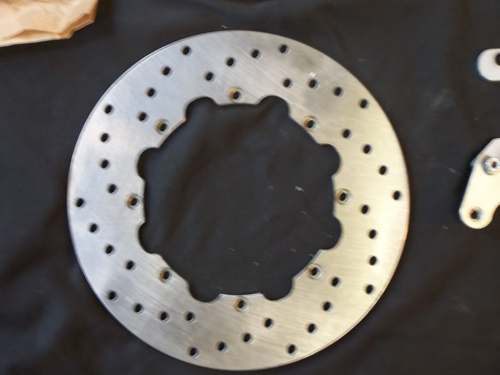

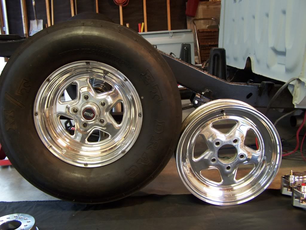

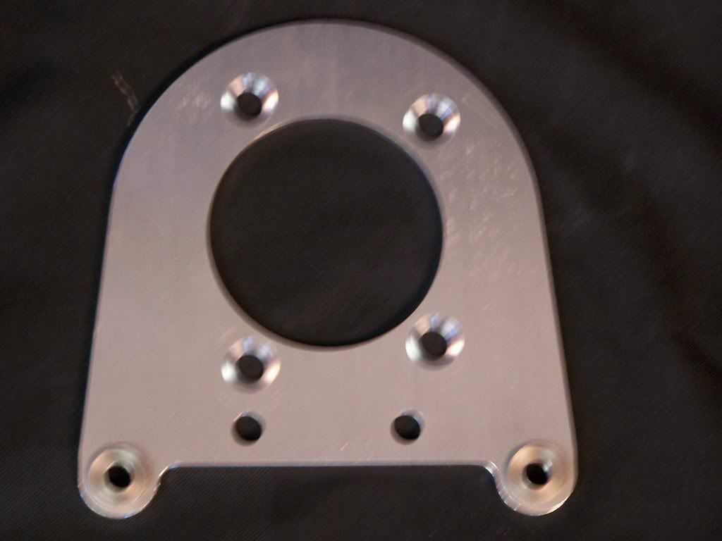

got my stuff in today and here is the aerospace drag kit front and back for the luv's :D :D :D
sorry bout the blurry pic's i was to 8O :D
front kit
rear kit 9 inch old style big bearing

i drive my truck strictly on the track with no problems, i could see this kit working on a weekend type truck but not sure about everyday driving. aerospace make a street kit for the luv truck but it's a little more than the strip kit, the strip kit has a single rotor (it's like a motorcycle rotor) and the street kit is a dual vaned setup for the needed cooling for everday braking heat.

Did all this go on the stock spindle?
PostPosted: Tue Mar 25, 2008 7:42 am
Posts: 727
Location: SPRING,TX
yes it goes on the stock spindle.
