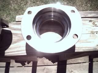

I just received my axle housings today. Man, talk about some stout parts! These things weigh a ton. I think the axle tubes will need to be cut down a bit to fit them corectly. If i can, i'll compare the old ones to the new ones. I'll post some pics to show the difference.

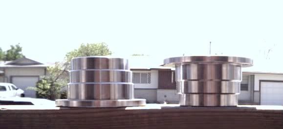

Here's the small bearing Ford housings i got.

Well, i've hit on a problem. The new axle bearing housings are bigger than the axle tube diameter. My axle has tapered tubes. It looks like i'll have to change out the tubes to be able to use the new housings. Bummer.
