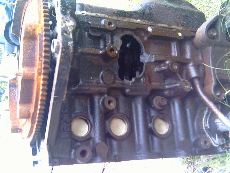

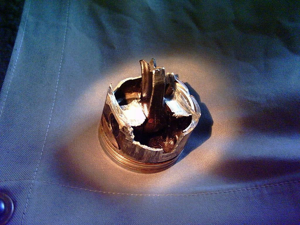

i never really thought about the powerband when i considered doing the swap that way, i spent 2 years playing with the FXE1 block, ran it SOHC and DOHC on a bank 1/4 mile asphalt oval track against bigger domestic 4 cylinders, chevy 2.2, ford 2300s etc. and laughed at them when i laped them with alittle 1.6 rice burner, i know the 4XE1 inside and out, even got to see what happens when you play with a lightend crank and flywheel on stock rods, also the head had about $1400 of work done to it, slung one piston clean through the front of the block and the rod from another one through the oil pan
i had 3 blocks laying arond and a transmission but i got rid of it all along with the car so i cant do any testing myself but i do plan to one day, im also thinking maybe i can convert a FWD storm/impulse to RWD with the LUV drivetrain, and alot of fab work too ofcourse
i have to many plans, i already have a yard full of toys, i need to learn some restraint.. some day
http://i8.photobucket.com/albums/a31/Re ... et3004.jpg
http://i8.photobucket.com/albums/a31/Re ... CT0005.jpg
block and piston :oops:
