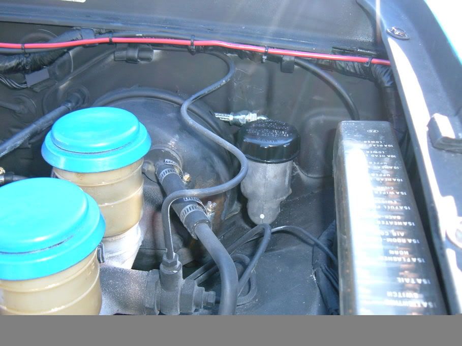

oh and do you have any pics of how the clutch master cylinder is mounted? id like to see how that works out with the wilwood MC. i looked at the pic of the unit on summit, and it looks to be small enough to where there not gonna be any clearance problems.

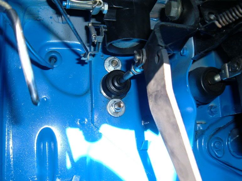

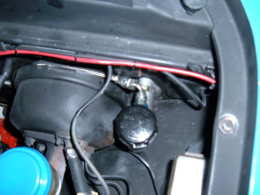

PostPosted: Sat Dec 10, 2005 4:29 pm
Posts: 722
Location: Marysville,WA
Here you go! 8)

PostPosted: Sat Dec 10, 2005 11:31 pm
Swap Specialist Mod
Posts: 2831
sweet. that just fits right in there! thats pretty cool
thanks for the pics!
