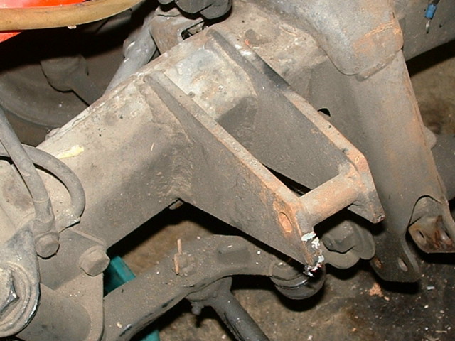

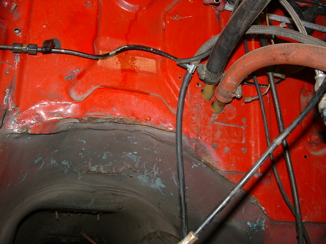

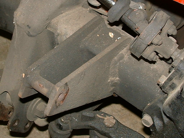

Not sure if I've posted these before. Here's a couple shots from last time I had my engine out.
Passenger side motor mount:
Driver side motor mount:
Firewall "massaging":
The firewall needs to be clearanced to provide room for the top of the transmission. You would have to set the engine too far forward if you didn't do this.

Looks like you pounded it up so it would fit. Or did you cut out and weld a patch in there. It isn't totally clear, but it looks good.

PostPosted: Wed Feb 18, 2004 11:35 am
Customized via sledge hammer.

It really does not look like it was that bad. Maybe a 8Lb sledge 8-)
It looks as if it had to go up an inch or so?

PostPosted: Wed Feb 18, 2004 11:48 am
Ya, about that much. All your really doing is folding over the seam where the firewall is spot welded to the cab floor.
