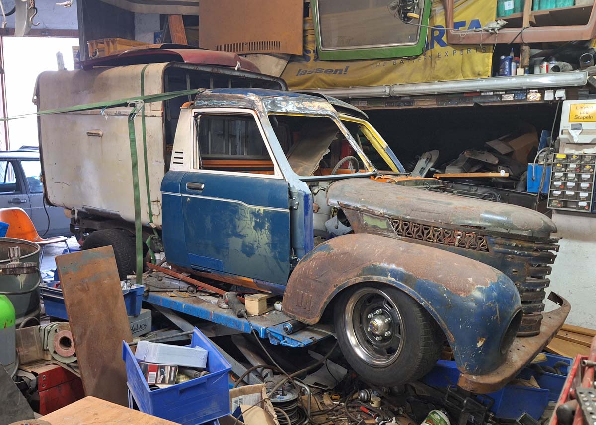

Hello from Germany. Everything is a bit more difficult to get street legal here. I have installed an Opel engine with 115hp and the authorities want me to install the brake system from the Opel Frontera (identical to the later Isuzu Trooper). Brake disc diameter 257mm and 60mm brake pistons. Unfortunately these brakes do not fit on the steering knuckles of my 1980 LUV Series 10.
Does anyone have experience with other brake calipers on the LUV, what fits and do you have pictures? The brake calipers must be from a production vehicle. Custom brake systems from the USA are not tested in Germany and are therefore not legal in Germany.
