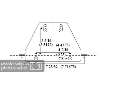

And by the looks of a Hooker trans mount the holes for mounting the trans to mount I am still back about 1" to 1.5" to the rear of the truck. There is no more room to move forward to attach the bolts in the trans mount. Measurements on the Hooker mount are 5.3125 from cross member frame to the trams rubber mounting hole and I am back a inch or better on the mount. Header tube is against the front control arm cross member. I will get some pics to make a better understanding.

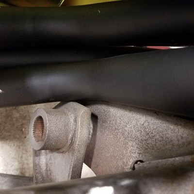

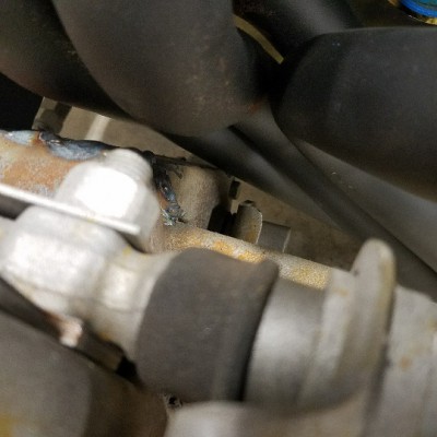

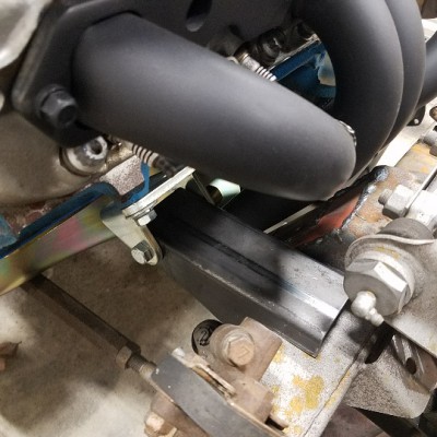

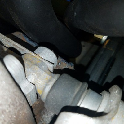

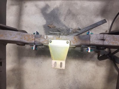

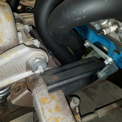

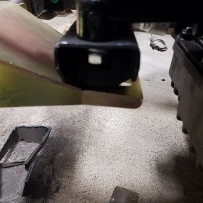

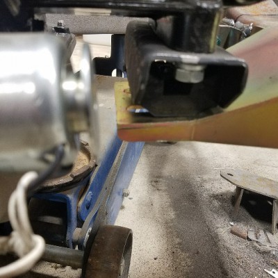

Maybe these will give some idea. I am thinking the whole setup is to low!

Widetrack, as I noted the other day I am finding your posts/topic of interest and appreciate the info too. I don't know if it will help your cause and maybe you have already seen the drawing for the Hooker HOK-12606 mounts. I found the drawing under LUVTruck opening page under the Information tab in the Miscellaneous category, drawing A of the Hooker V8 swap motor mounts. I realize you are building your own which look really good but thought the drawing might give a height measurement based on the info in the drawing. Again, maybe you already seen the drawing but thought I would mention it.

Yeah, your motor mounts are too low. Here is a pic (if you have the photobucket fix) of mine. I have 2-1/8 tubes now, but originally, the Hooker headers were installed with the mounts as they are.

I know the motor is low now. When I took the pics the hoist was relaxed (bled off) and it was sitting low. I will raise it and see if I can get it higher and forward.
Is the Hooker trans mount flat on top and is it flush with the top of the cross member? Thanks!
That pic helped me out! Thanks
