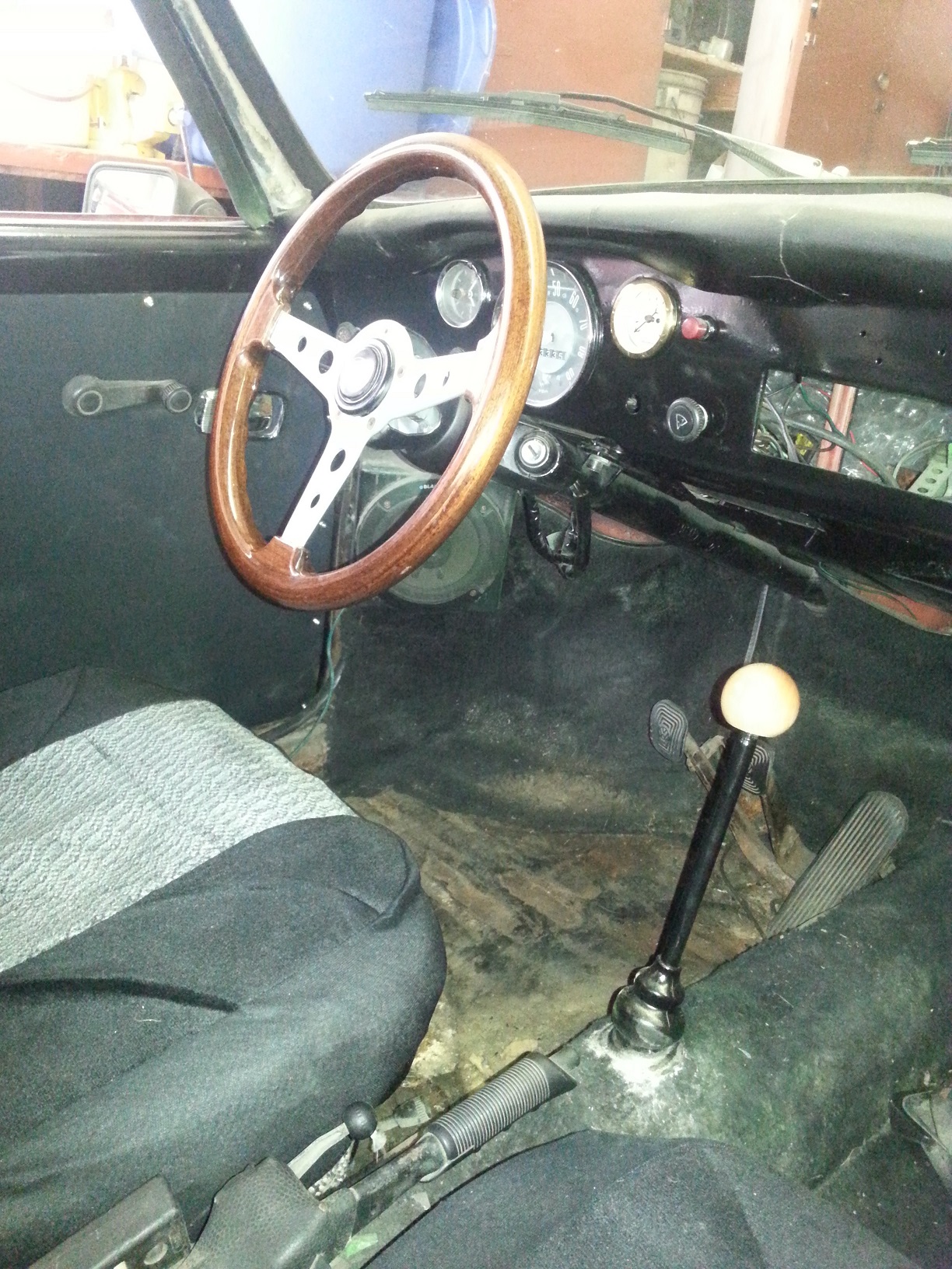

Anyone happen to know which steering wheel adapter from Grant our trucks use? I can't seem to get the correct search terms to find out. I'm wanting to put a wheel like I had on my Ghia in my truck.
