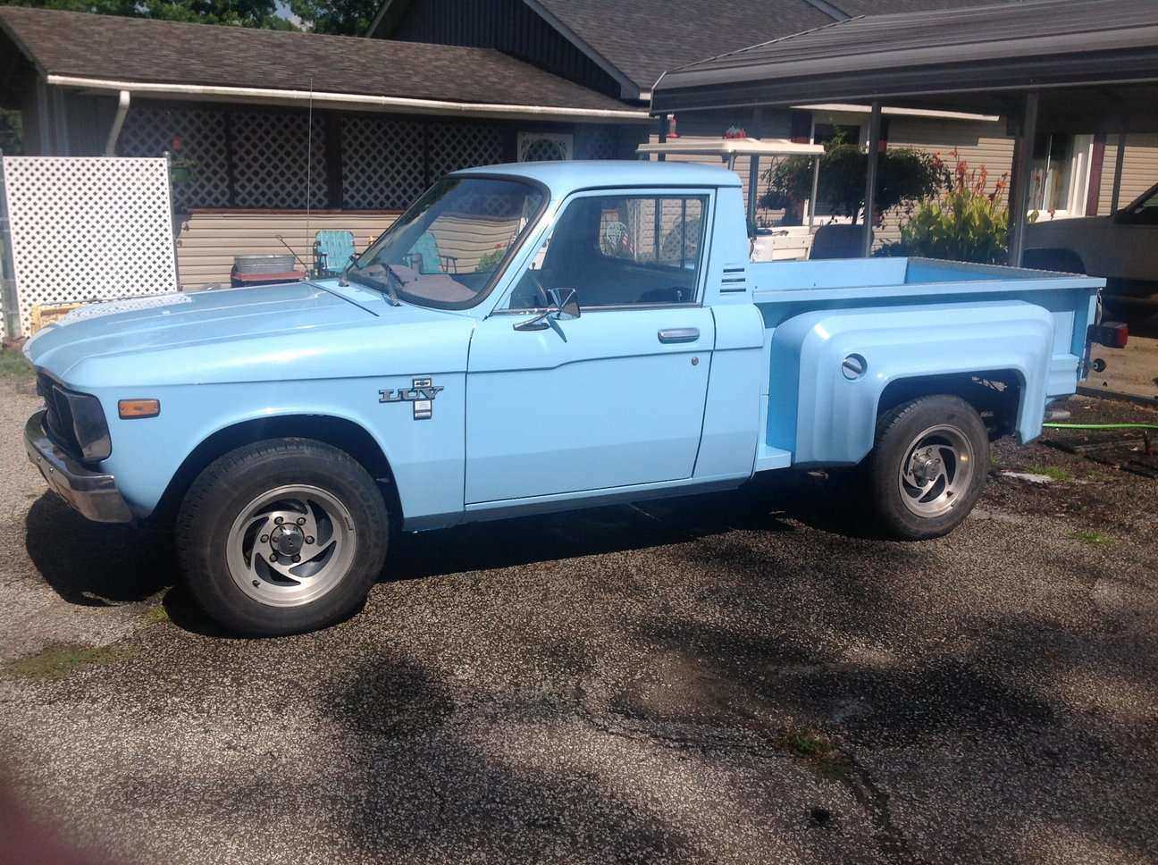

I'm installing a 91 4.3 V6 into my 80 Luv 2wd. I'm changing the heads to the Vortec from an 01 truck. Will my stock roller cam and lifters work alright with these newer heads. I'm going with a carb setup and eliminating the TBI setup. What distributor will I need to run an HEI unit.

Hello Bobb; Looks like you have the same project I had a while back( 1 Yr). I have a 1980 LUV stepside like yours. I put a 4.3l V6 from a 1995 Blazer in mine along with a 700R4 tran. The V6 swap fit so much nicer than the V8 I originally planned. I was having much trouble getting the EFI and computer hooked up, I almost traded for a carb setup, like you mentioned. Several guys here said to keep the EFI (not a throttle body, separate nozzels, forgot what its called) so I did and it works great now. I was told I would have to swap to a regular distributor as the EFI dist was computer controlled. Sorry I can't be much help there! I would think there would be a lot of assistance here on whether your cam/lifters will work with Vortec heads. I would think they would. My '95 engine says Vortec on it but it is not true Vortec. Good luck on the project!

Great looking truck too :smt023
