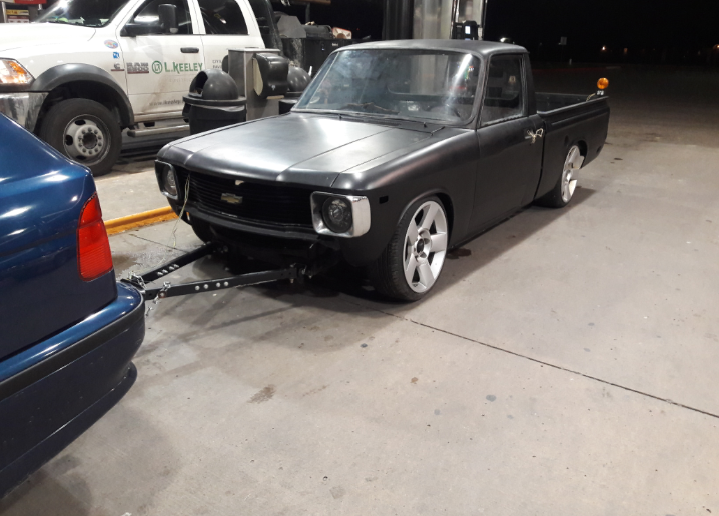

Does anybody knows whats the fuel cell size i can fit om the back of a 2wd short bed luv? What would be the correct size of fuel.houses from.the tank to the carb? I have a 350 carb with mechanical fuel pump.
My luv project

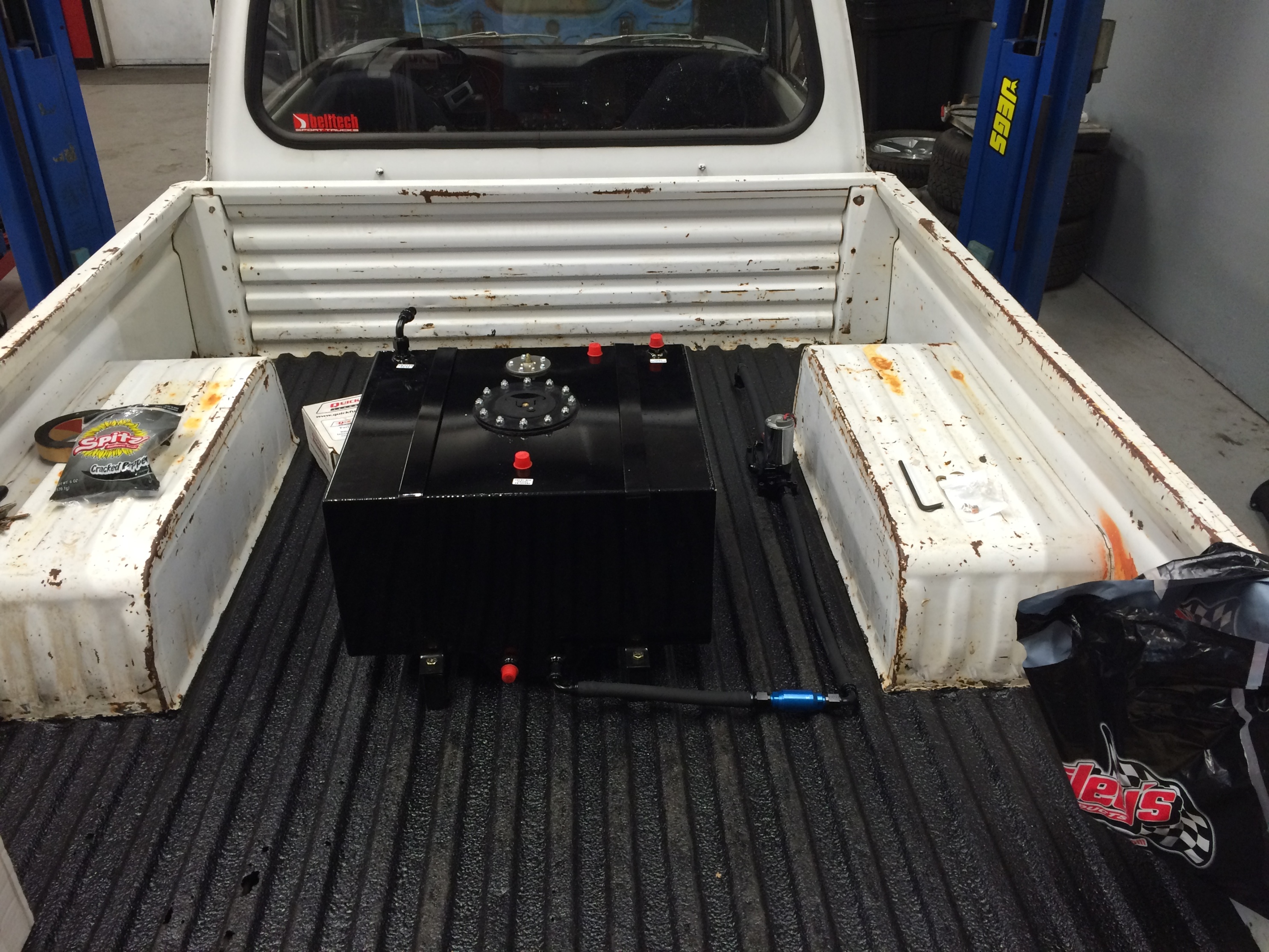

We used a 15 gallon cell from summit with an electric pump with AN10 lines to the regulator. It was a summit brand. We made two inch spacers out of 1'' square tubing to put it up off of the bed floor. I did not want to cut a hole in the bed for the sump part of the fuel cell.
 Post subject: Re: FUEL CELL SIZE
PostPosted: Sun Mar 26, 2017 8:22 pm
Posts: 727
Location: SPRING,TX
here it is mounted.

CT'S LUV wrote:
here it is mounted.
Whats the part number? Will this work for a mechanical pump??
My luv project
https://youtu.be/wd5eCjrNL6U
PostPosted: Wed Mar 29, 2017 6:36 pm
Posts: 727
Location: SPRING,TX
SUM-CSUM293215SB is the part number, this is a kit with the mounting straps and yes it will work with a mechanical pump. This cell has a return inlet, sending unit 90ohms,vent outlet and two -8 outlets for fuel. You may not need this specific cell with all the inlets/outlets and sending unit. I needed but look at the others they have.
