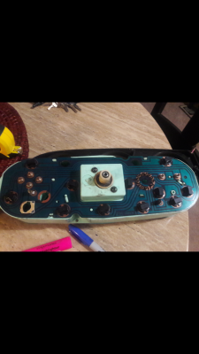

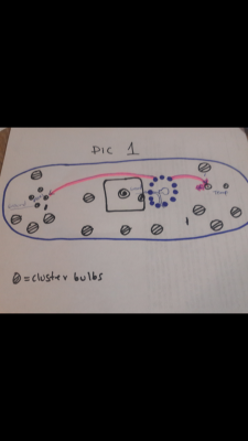

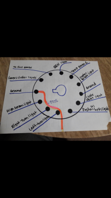

I hope this helps to hook up your sbc swap to tje factory cluster. Cluster is from a 1980 luv 2wd.
