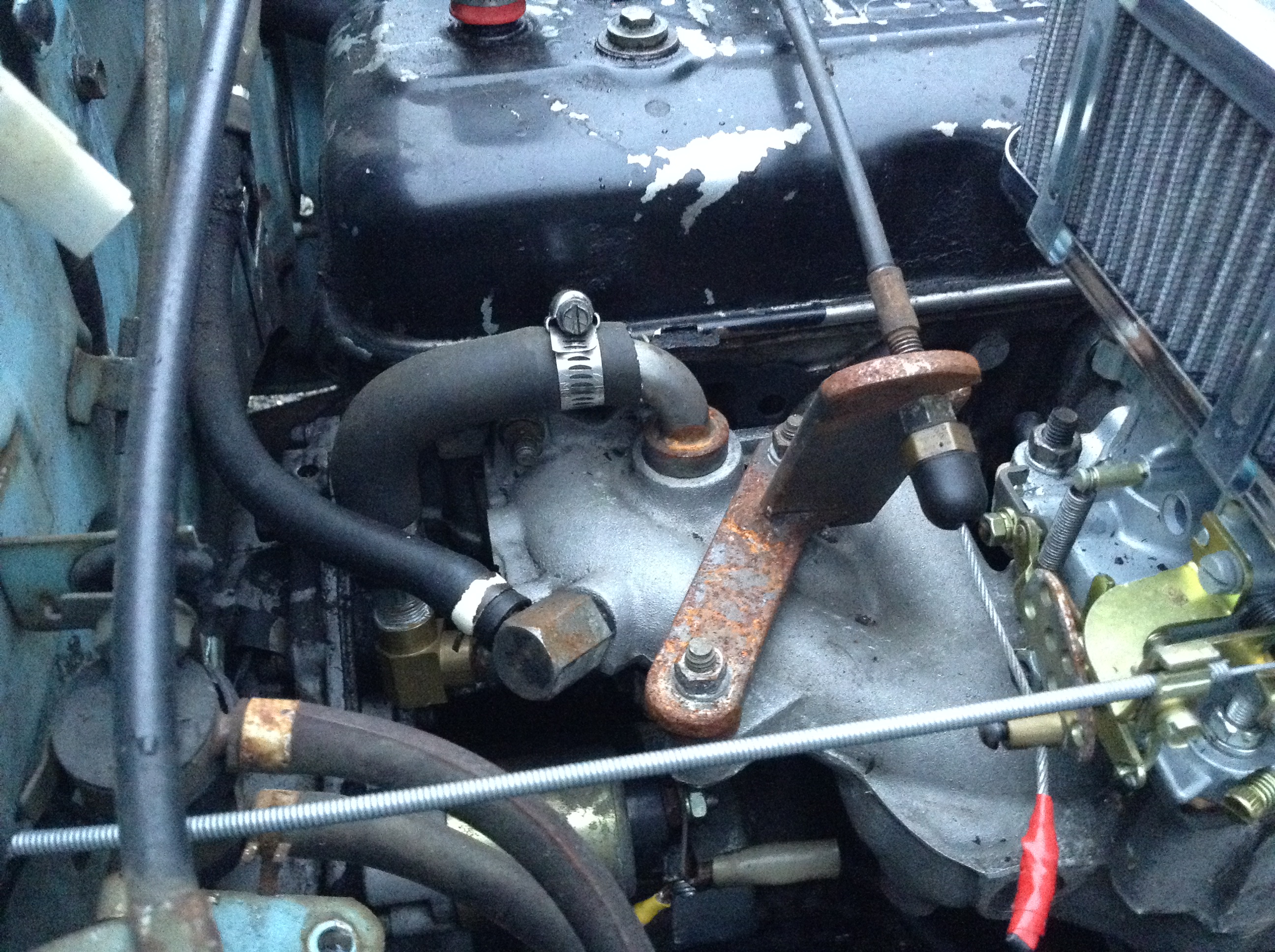

Bought a weber to replace my busted hitachi. got it installed but as i already knew the kit supplied cable bracket does not work. I saw the vid on bolting the old bracket to it and low and behold my stock bracket is nowhere to be found!. I intentially put it aside knowing i may need it but alas it is MIA.
Im at a stand still now. anyone know of a bracket i can order the will work?? or have a stock one they would part with??? Any help on a solution is greatly appreciated
I did use the stock bellt crank also instead of the weber
Can you weld,or know somebody who can? A couple welds and a few holes drilled and you can make a simple,stout,custom bracket to align and hold the cable.
