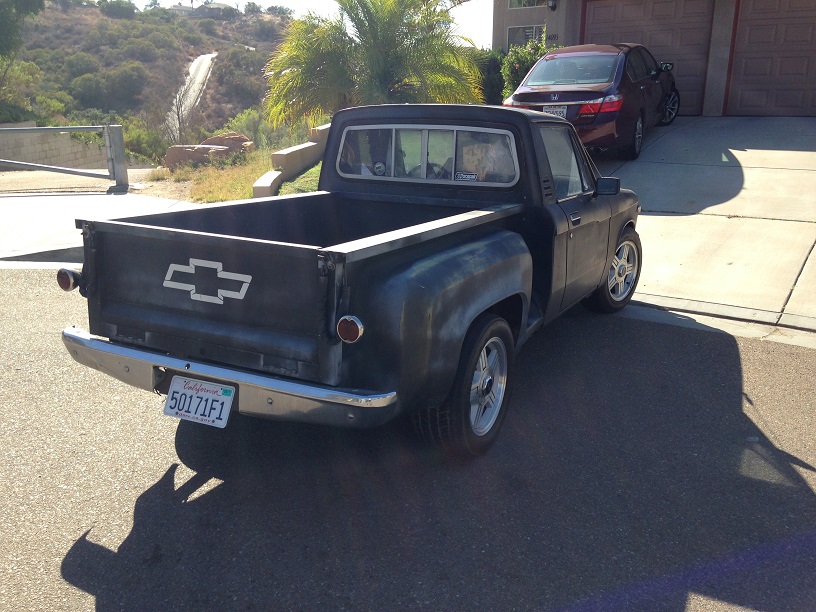

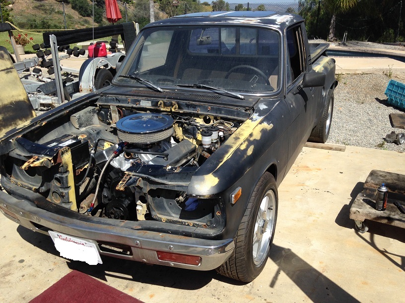

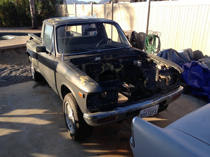

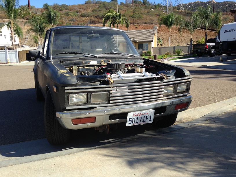

Hi all,
Well I had this for sale in the classifieds, couldn't sell it so hey now I am finishing it!
73 Luv stepside.
came with a complete 1985 350 corvette engine and trans.
Has a 5 lug chevy disc brake conversion in the front, newer Luv disc's redrilled.
removed the TPI system for another project, using the 350 base motor with a 4bbl, alum intake and Pertronix ignition in a stock vacume advance dist. left over from my other car project.
The vette 700R4 has a unique case and trans mount...wont work.
I put in a fully rebuilt 700R4/4L60 not an E though.
02 S-10 Blazer 3.42 rear end w/disc brakes.
Tried the Ace kit, motor mounts bolted in nice, set the motor too far back in the truck.
When I cut out the old stock mounts...wow they are weak.
Came with the hooker kit, modded the th350 trans mount cut it shorter worked great. Front mounts are nice need to be welded but it fits better.
using block huggers they will work for now @$88.00
The tunnel was already cut out unfortunately gotta fix that.
Truck is 98% rust free and the body is really nice.
We may try it at the Barona 1/8 mile drags soon!
Here are some pics

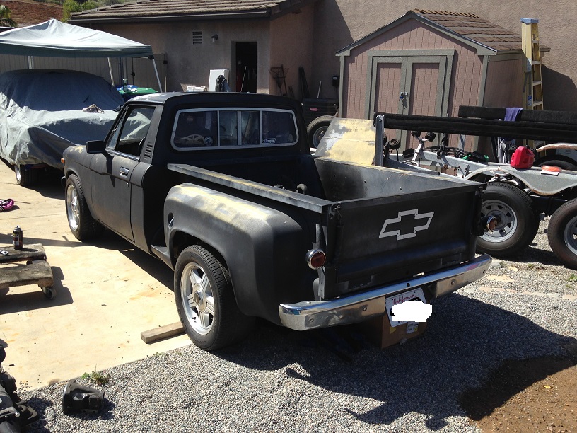

So I am working on it, new water pump (short), pulleys, alternator mount, cool summit aluminum stuff cheap too.
hope to have it running in a week or so, still needs a re-wire and radiator + a fan, probably gonna use an electric fan. I have a large late model alternator and the wiring skills to do it right. Exhaust system too....wish I could weld good, need the mounts done.
Oh it has the cool 70's sunroof, rear slider window, old pioneer stereo, and probably a "stull" square tube grill with quad headlights, I remember all this stuff when I was young...kinda nostalgic. Wheels are 16 x 8 from a 1991 Camaro Z-28 or RS.
I rode in many of my friends Luv's back in the 70's and 80's.
I was selling it because I have too many projects to work on...now its too far along to stop.

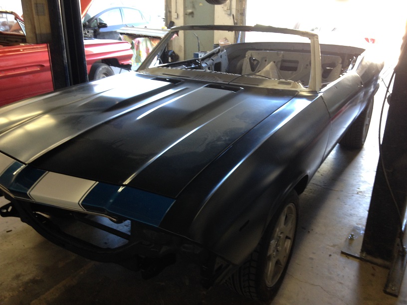

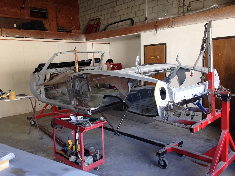

I already have a major project going on...my 69 Chevelle restomod...LS1/6 speed and all the goodies..
It received new floors firewall to trunk, quarters, wheelwells, new doors, fenders and SS hood.
A semi rusty convertible from back east.
I am a major gearhead, doing the swap and chassis myself, body is at the body shop still.
I Hope to make this LUV a cool cruiser and parts runner. Make a pass at the drags occasionally.
I am very open to your suggestions or ideas as I am experienced but am always learning.
The exhaust system is a challenge, maybe a single turbo would be easier with one pipe in the stock location?
I like that idea!....my wallet doesn't...:( I almost bought a 3.8 V6 and put a turbo on it to be different.
Thanks for the comments!

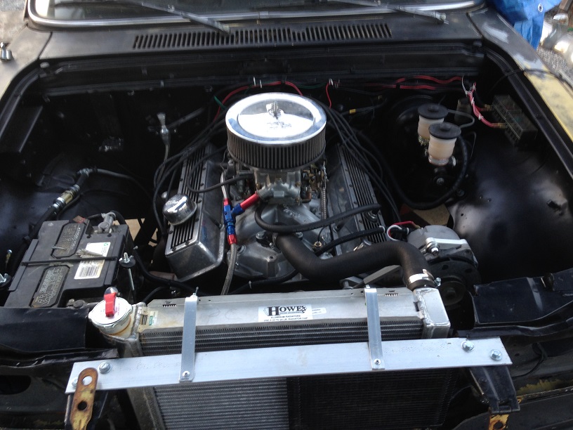

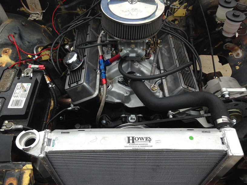

Oh yeah, it actually runs!
The 1985 350 TPI motor that came with the truck actually runs pretty good.
Can't run it too long though! no cooling system.....
Ordered the 342B Howe radiator.
I could sure use some advise on some molded hoses, I like to use them instead of the flex ones...
Suggestions anyone? The Ace suggested Dayco M30 and M21 are not a correct part number locally.
Gotta hook up the 700R4 trans, I always slide the torque converter back and leave out the bolts until I am sure the motor runs good and isn't coming out again....
So I need a dipstick (I'll use a flex Lokar) kick down/shift cable.. I have some left over hard fluid lines and a nice B&M cooler.
as for the driveshaft I have a couple....I'm sure Ill have to mod one of them though there's 2 good driveshaft shops here locally.
I have to re-wire the entire truck, and find a nice electric fan set up..plus the exhaust system....
Suggestions on a fan to use??
Thanks to all!!
I have read so many articles on the site dealing with a new fuse box, engine swap, headers/manifolds, trans choice, rear axle choice...etc...
tons of info here!
Hope to drive it in July.

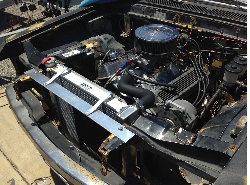

Well its getting there...
Check out the radiator hose fit..., I used stock hoses from a 69 Chevelle 350 or any sbc, cut them down to fit.
I started out by looking at the top hose from my former Chevelle/sbc package, I used my original top hose and bought a new lower one.
I put a little grease on the bottom one to get it too fit on the radiator outlet due to cutting it back.
Now I am re-wiring the truck, and getting the trans cooler, lines, dipstick and cables hooked up.
not sure what to do about a fan set up yet....
suggestions? advise anyone?
Thanks!

PostPosted: Wed Jun 08, 2016 5:09 pm
I just re-did my radiator a week or 2 ago. I had to replace the flex fan at the time due to a cracked blade on the old one. It looks like you have almost enough room now and I think with a steel pulley would sit back a little more. The fan said it should be 1.5 inches from the radiator.

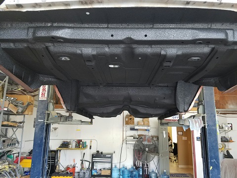

So some progress made, radiator mounts all done, B & M trans cooler installed, bought a flex fan from Summit works really well and pulls a lot of air. I did the paper test and it pulls a lot of air thru, even tried to suck it thru the radiator as I revved it up. That's a good cost saving solution.
Disassembled down to the long block to weld in the motor mounts, sold the shorty headers in a day on C/L.
New (used) Hooker headers and exhaust going in, bought here on luvtruck.com
driveshaft and pinion seal done.
Bell Tech Nitro Drop II shocks front and rear.
Lokar trans mount 700R4 shifter this weekend, should be on the road in 2 weeks....need to fix the trans tunnel, it was cut out by the P/O. looking for a replacement in the classifieds.
69 Chevelle coming along and draining my cash and time.....
Once the truck is done I will paint the exterior. Then maybe after I drive it for a couple months or a year and decide I really like it I will take it apart and restore and paint it in and out, detail the engine compartment.
One car at a time....there's another one under the tarp outside to finish before the LUV gets the resto.

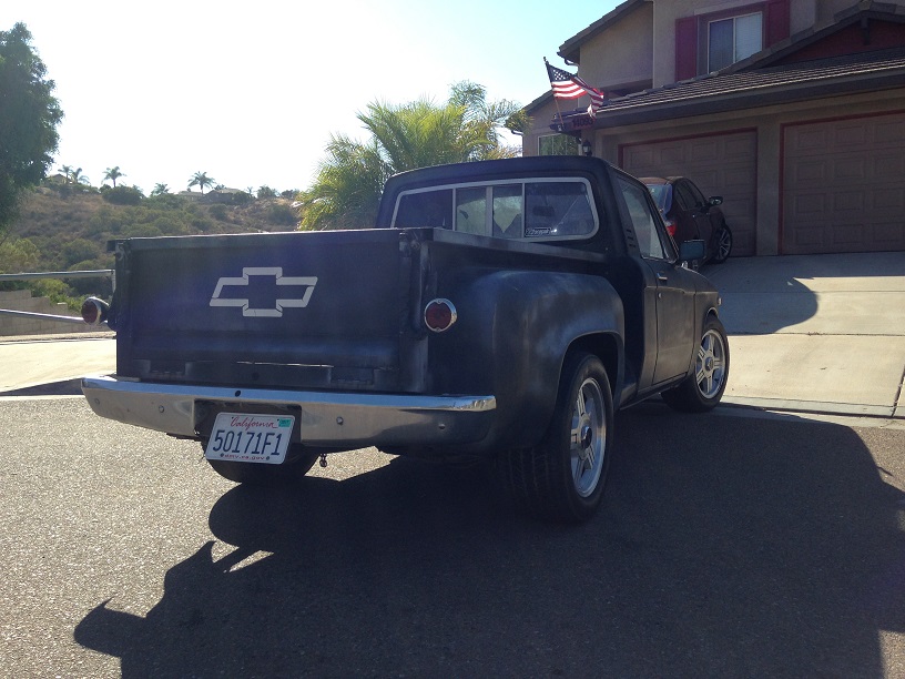

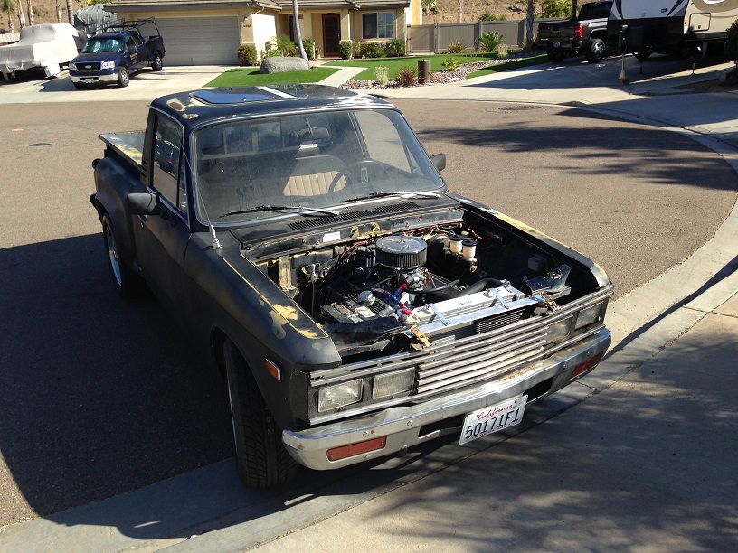

1st test drive around the block today...wow its been a while since I brought it home.
Rides nice, steering is easy for the front weight and no power steering. Rebuilt trans shifts good, didn't get over 30 mph though.
Needs the alternator hooked up, (done tonight and tested) brakes bled again, 4th gear lock up solenoid wire connected, volt gauge hooked up, and a few minor things.
Hooker headers clear nice, radiator set up is great, welded on new brackets for the tube grill and mounted it. Need to replace a couple lights and align them.
I have looked around for a nice complete stock grill to replace this one, but they are rare and expensive. Seems like a nice set up is like $300-500.00 (bezels, buckets & grill) You can buy a whole Luv truck for only $1,200....??
I will re-chrome and re-paint the one I have, make it like new.
A fuel gauge would be nice too, I installed an adjustable marine sender in the stock tank, so I will need a new matching gauge. I have read the posts about the original ones, hard to fix and get parts. Seemed easier to put in a marine set up. I had an extra one while working on a boat recently.
I don't know about the rest of you all, but I do get some satisfaction when a vehicle I buy, which has been sitting for a long while, (like 10 years)
gets driven again. Seems I have done this too many times before...
I will drive it more this week.
your comments and recommendation are welcome.
Thanks for all the tips and info on this site!

Truck is back together, engine compartment painted, looks much better.
700 R4 was fine but the torque converter failed...trans shop warrantied it, flushed and cleaned, replaced converter.
flushed lines and cooler added a cooler filter as recommended by the shop. Never heard of that, Wix makes a nice little in line filter kit easy install on the return leg from the cooler back to the transmission.
So a good test drive made it back to the house fine this time!! Shifts great to 4th and lock up, cruises great at 65+ just loafs along plenty of power, a little loud though, rides and drives very nice.
It was low 90's Sunday out my way no overheating problems, good oil pressure, 13.5 volts charging, almost made a hardware store run.....
So far so good! Now for the trans tunnel completion. Fiberglass may be the way to go with some glue on insulation.
Gonna put on a drop base air filter and see if the hood fits/works.
The front is a little low, will adjust the torsion bars up a little.
Prime the body etc....still needs a marine gas gauge too.

Thanks love4theluv, it's getting closer....hope to drive it more this weekend. Hook up a fuel gauge etc...that would be smart..
I really like your set up..vortec V6 with the NV3500, plenty of power and O/D..gotta have the 5th gear or O/D these days.
I'm gonna try to get a hood on it also this weekend...
