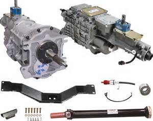

I have used the TKO 600 in the past for a resto on my old 71 convertible Corvette LT1 383 sbc combo and it is an awesome trans. It transformed that car into a 75 mph freeway flyer and easy daily driver. (3.70 gears) sold it in 2010.
I do know that it is larger than a Muncie or a Saginaw trans and required trans tunnel mods for most cars. I cut/modded the tunnel in the vette.
Back in 2004 the TKO600 trans was about $1,600.00 wholesale cost to me, they have gone up in price.
I have a resale number in Cali but now in 2016 I could not get anyone to sell me one at a wholesale discounted price.
They are $2,395.00 everywhere....Summit/Jegs etc...but big, strong and excellent.
add in the hydraulic set up it's another $700+ or so with the pedal and clutch master cylinder, plus the slave cylinder or hydraulic T/O unit for the trans.

The picture shows the TKO on the right. My Chevelle in 2014, currently being restored
