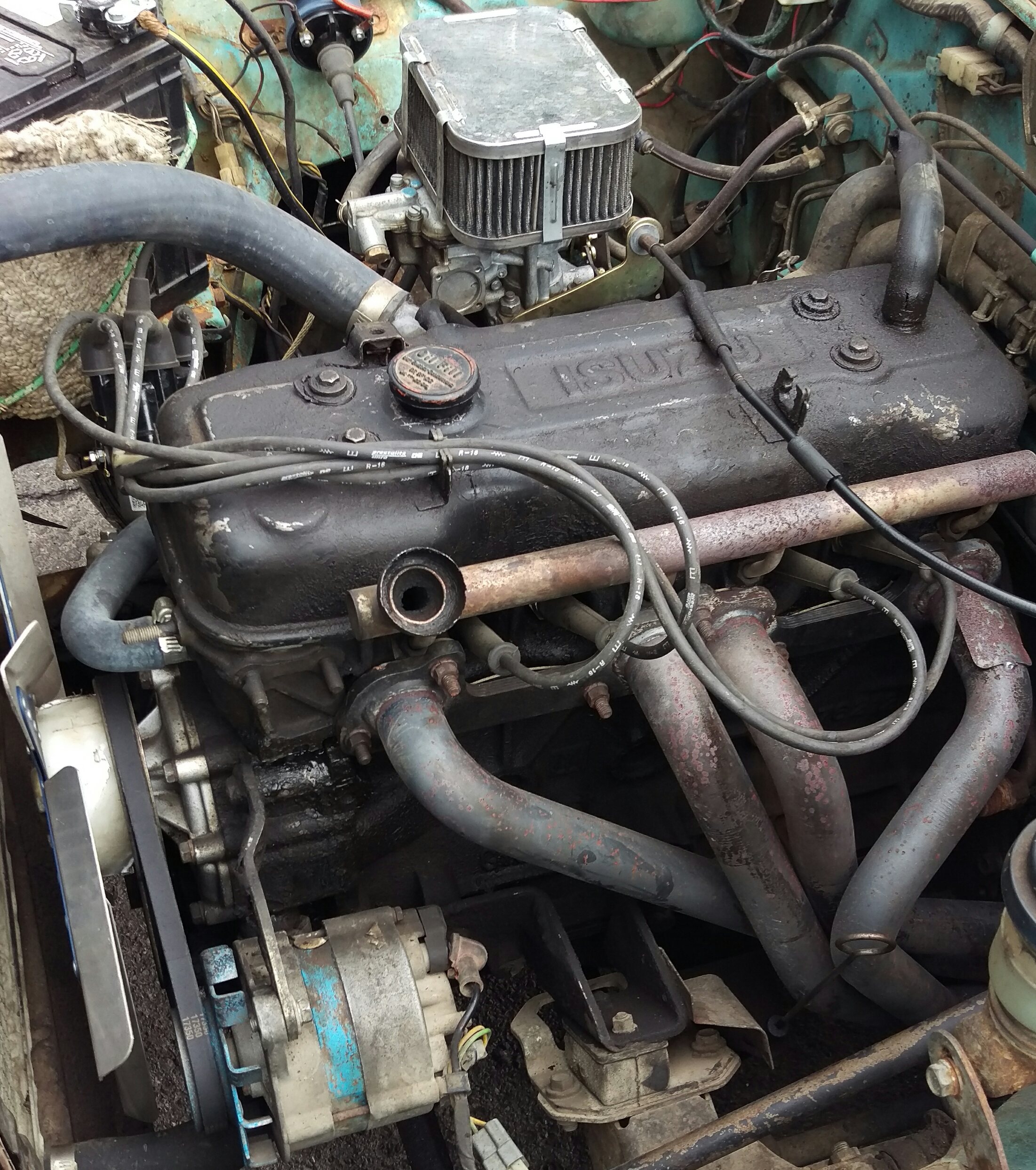

Thanks for the reply, I have a 76 I'll attach pictures because I'm not entirely sure. I have headers custom exhaust and a Weber 32/36 dgev plus some other random stuff. I assume Gemini is fairly expensive right?
PostPosted: Fri Oct 21, 2016 8:14 pm
That is the later cross-town engine and is correct for the 1976 model. Sincentives you have the header and the weber already, I would do a rebuild with a Delta cam upgrade and drive happily ever after...

Sounds good, does anyone know what that bar is above my headers?
PostPosted: Fri Oct 21, 2016 11:24 pm
That would be a A.I.R. tube. It's part of emissions. Looks like your pump and other emissions are delegated so if you rebuild remove the pipe and plug the holes.
