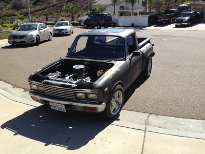

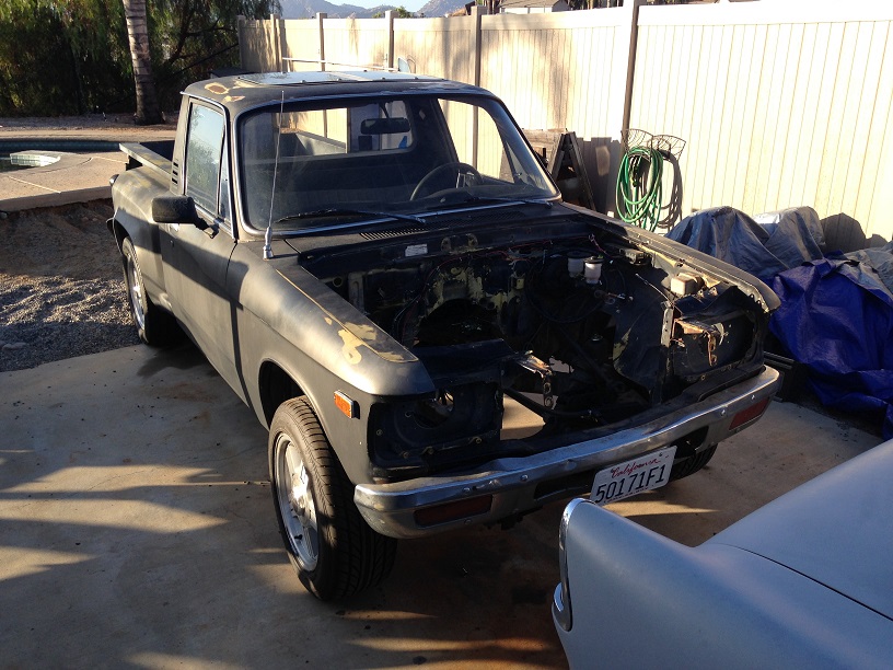

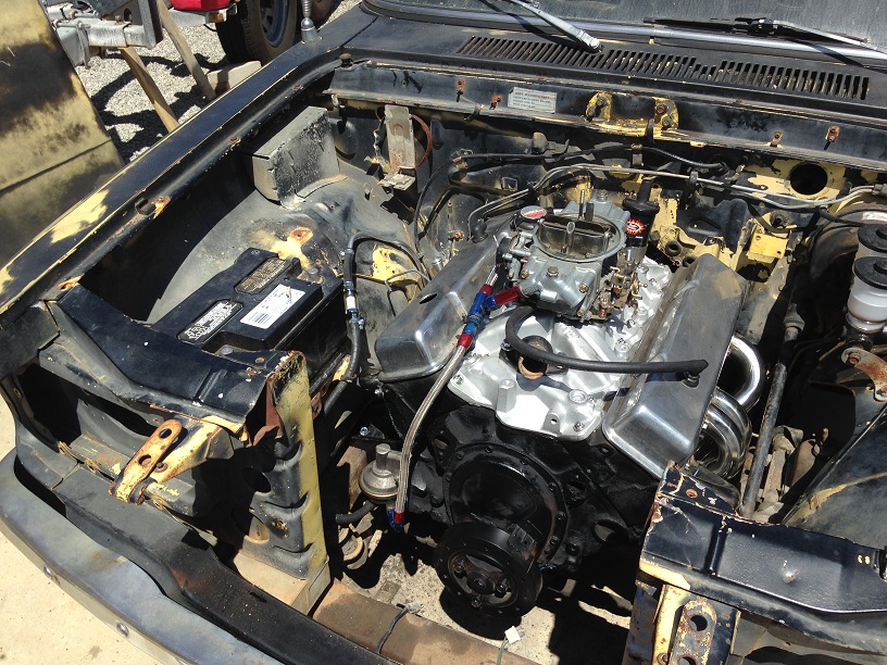

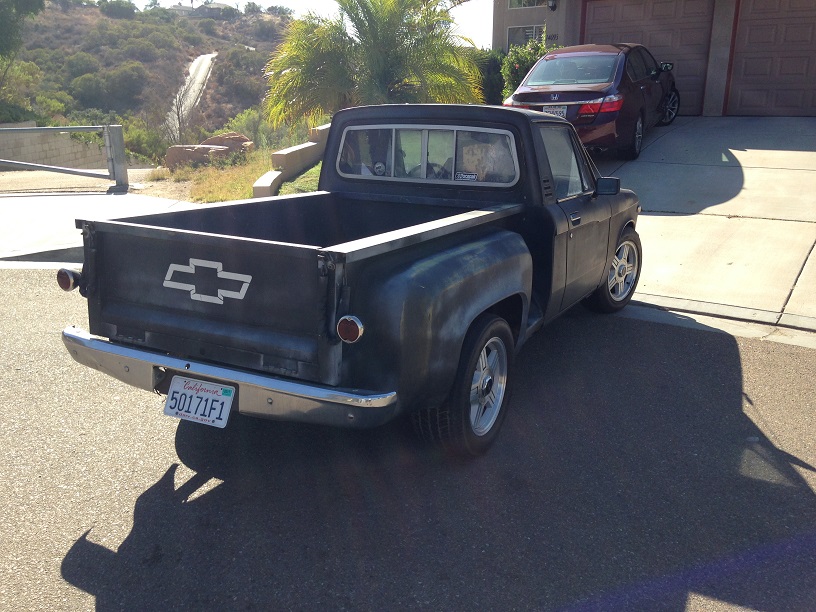

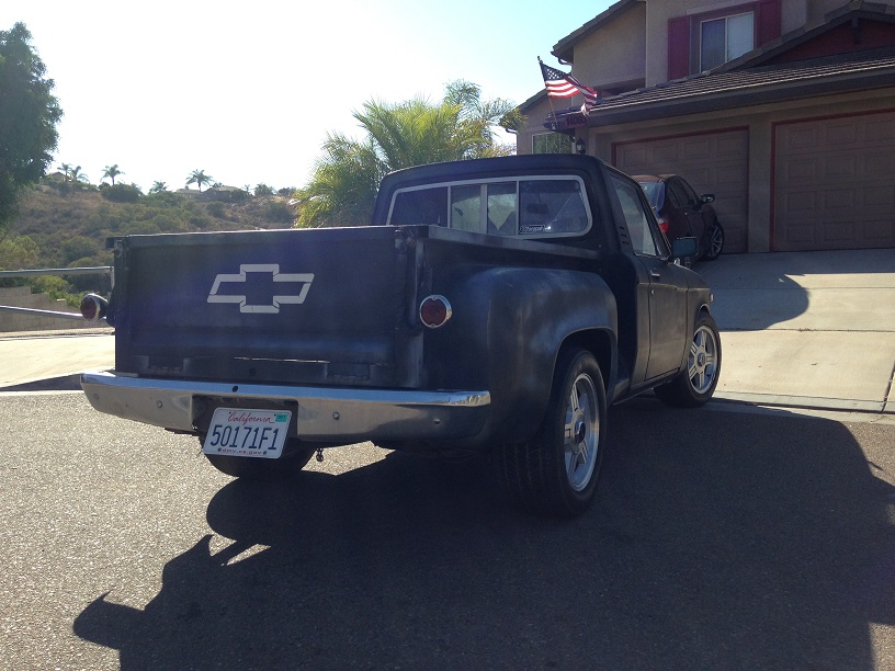

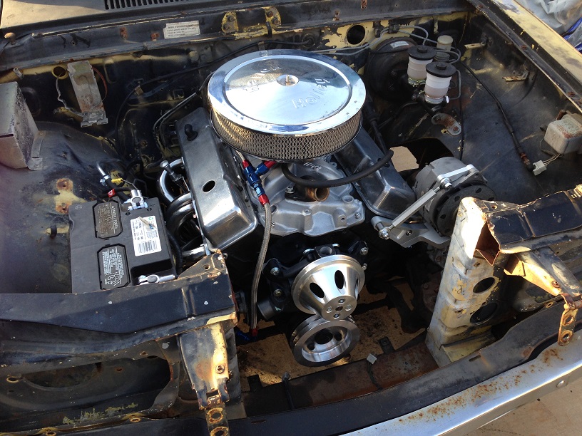

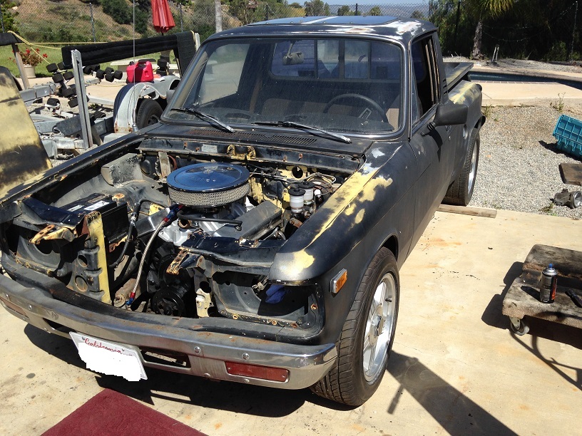

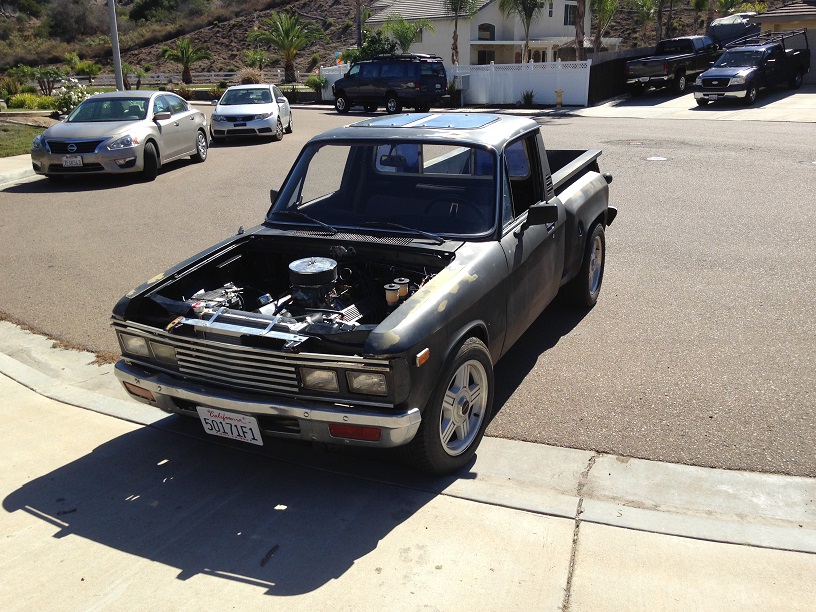

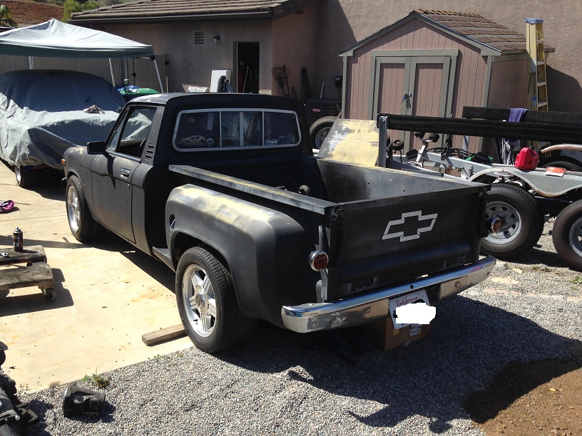

Hi all,
Well I had this for sale in the classifieds, couldn't sell it so hey now I am finishing it!
73 Luv stepside.
came with a complete 1985 350 corvette engine and trans.
Has a 5 lug chevy disc brake conversion in the front, newer Luv disc's redrilled.
removed the TPI system for another project, using the 350 base motor with a 4bbl, alum intake and Pertronix ignition in a stock vacume advance dist. left over from my other car project.
The vette 700R4 has a unique case and trans mount...wont work.
I put in a fully rebuilt 700R4/4L60 not an E though.
02 S-10 Blazer 3.42 rear end w/disc brakes.
Tried the Ace kit, motor mounts bolted in nice, set the motor too far back in the truck.
When I cut out the old stock mounts...wow they are weak.
Came with the hooker kit, modded the th350 trans mount cut it shorter worked great. Front mounts are nice need to be welded but it fits better.
using block huggers they will work for now @$88.00
The tunnel was already cut out unfortunately gotta fix that.
Truck is 98% rust free and the body is really nice.
We may try it at the Barona 1/8 mile drags soon!
Here are some pics

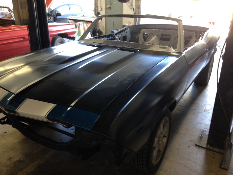

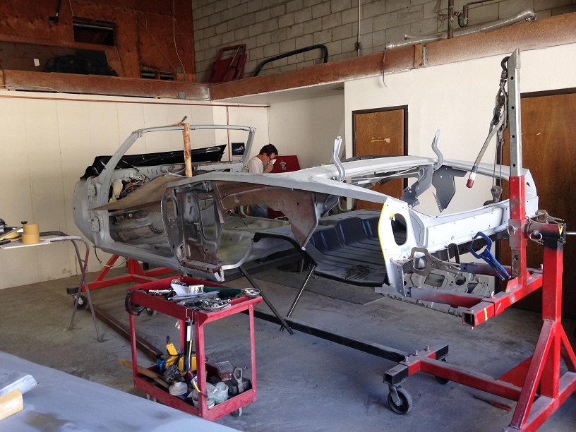

I already have a major project going on...my 69 Chevelle restomod...LS1/6 speed and all the goodies..
It received new floors firewall to trunk, quarters, wheelwells, new doors, fenders and SS hood.
A semi rusty convertible from back east.
I am a major gearhead, doing the swap and chassis myself, body is at the body shop still.

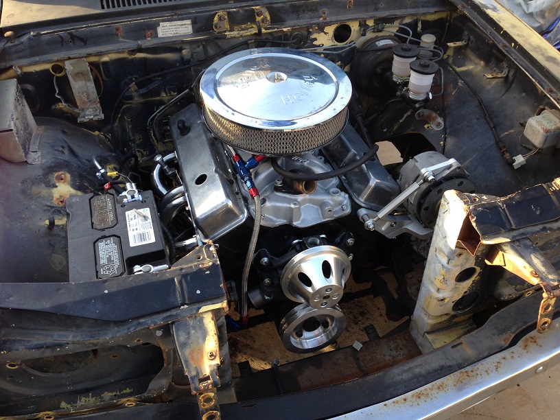

hope to start it soon, gotta massage the firewall to put on the distributor cap....

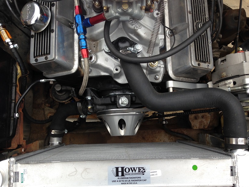

Oh yeah, it actually runs!
The 1985 350 TPI motor that came with the truck actually runs pretty good.
Can't run it too long though! no cooling system.....
Ordered the 342B Howe radiator.
I could sure use some advise on some molded hoses, I like to use them instead of the flex ones...
Suggestions anyone? The Ace suggested Dayco M30 and M21 are not a correct part number locally.
Gotta hook up the 700R4 trans, I always slide the torque converter back and leave out the bolts until I am sure the motor runs good and isn't coming out again....
So I need a dipstick (I'll use a flex Lokar) kick down/shift cable.. I have some left over hard fluid lines and a nice B&M cooler.
as for the driveshaft I have a couple....I'm sure Ill have to mod one of them though there's 2 good driveshaft shops here locally.
I have to re-wire the entire truck, and find a nice electric fan set up..plus the exhaust system....
Suggestions on a fan to use??
Thanks to all!!

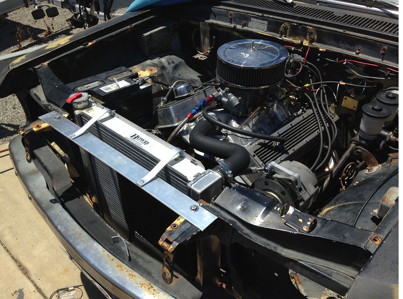

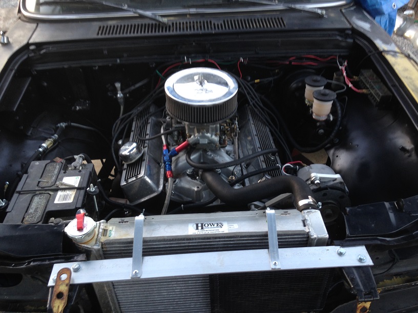

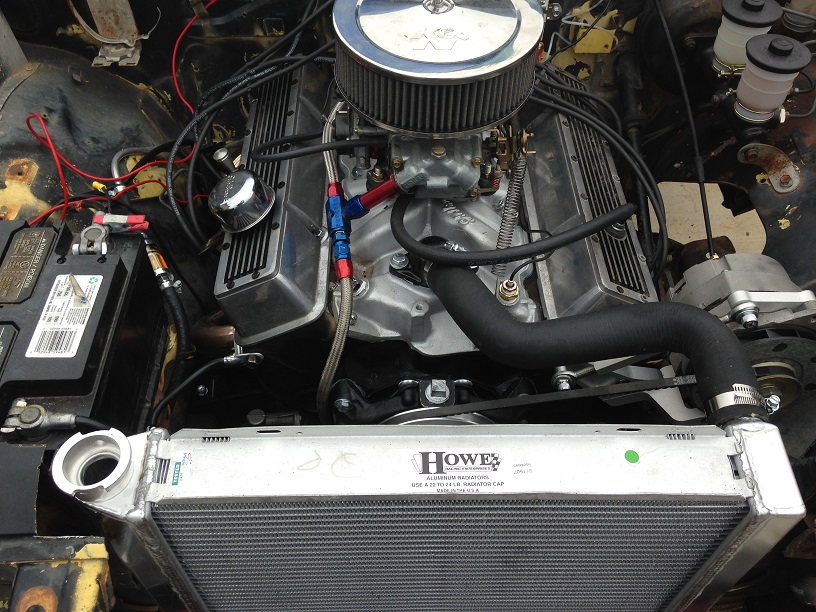

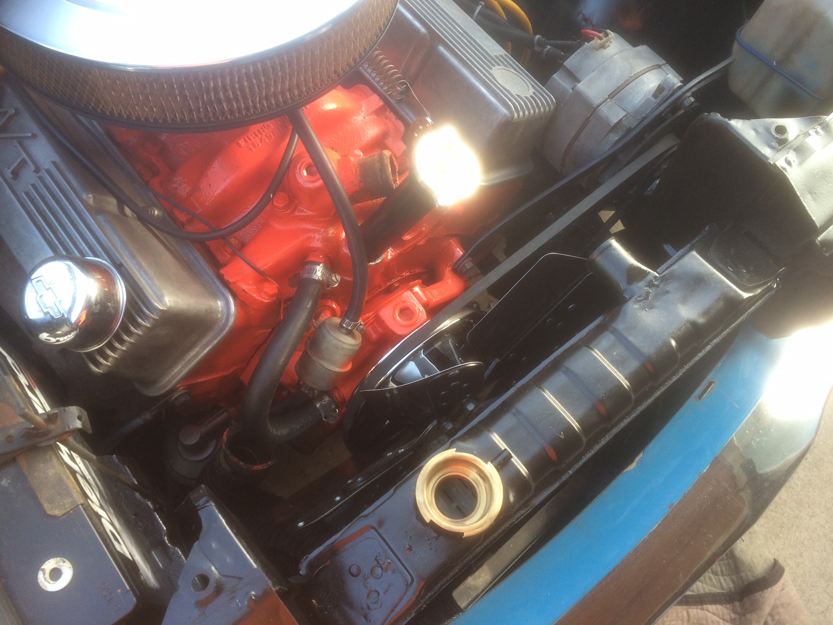

Well its getting there...
Check out the radiator hose fit..., I used stock hoses from a 69 Chevelle 350 or any sbc, cut them down to fit.
I started out by looking at the top hose from my former Chevelle/sbc package, I used my original top hose and bought a new lower one.
I put a little grease on the bottom one to get it too fit on the radiator outlet due to cutting it back.
Now I am re-wiring the truck, and getting the trans cooler, lines, dipstick and cables hooked up.
not sure what to do about a fan set up yet....
suggestions? advise anyone?
Thanks!

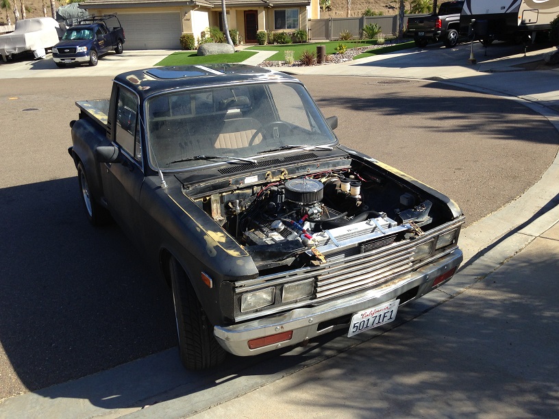

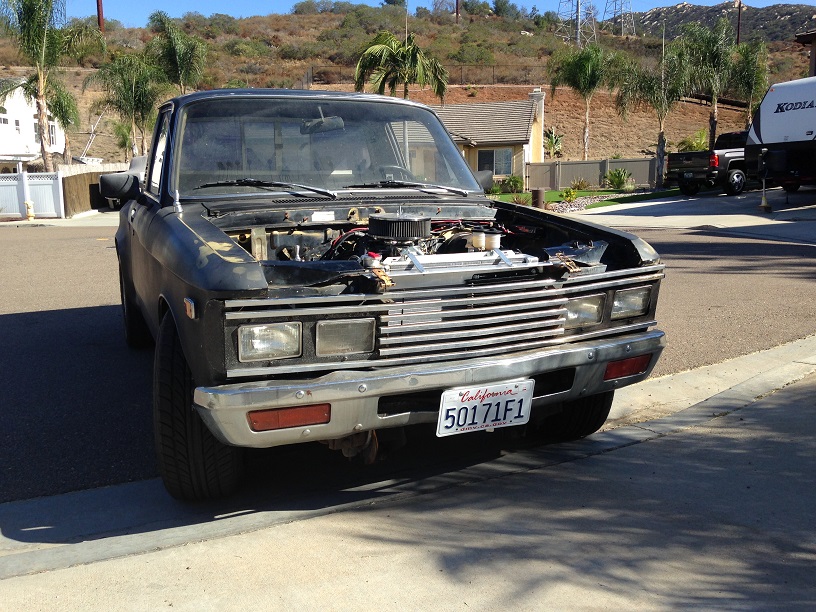

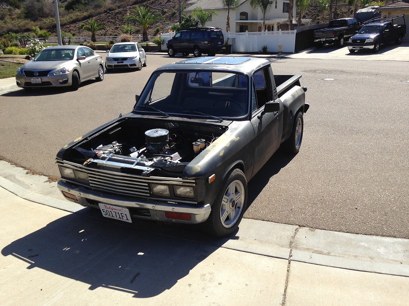

1st test drive around the block today...wow its been a while since I brought it home.
Rides nice, steering is easy for the front weight and no power steering. Rebuilt trans shifts good, didn't get over 30 mph though.
Needs the alternator hooked up, (done tonight and tested) brakes bled again, 4th gear lock up solenoid wire connected, volt gauge hooked up, and a few minor things.
Hooker headers clear nice, radiator set up is great, welded on new brackets for the tube grill and mounted it. Need to replace a couple lights and align them.
I have looked around for a nice complete stock grill to replace this one, but they are rare and expensive. Seems like a nice set up is like $300-500.00 (bezels, buckets & grill) You can buy a whole Luv truck for only $1,200....??
I will re-chrome and re-paint the one I have, make it like new.
A fuel gauge would be nice too, I installed an adjustable marine sender in the stock tank, so I will need a new matching gauge. I have read the posts about the original ones, hard to fix and get parts. Seemed easier to put in a marine set up. I had an extra one while working on a boat recently.
I don't know about the rest of you all, but I do get some satisfaction when a vehicle I buy, which has been sitting for a long while, (like 10 years)
gets driven again. Seems I have done this too many times before...
I will drive it more this week.
your comments and recommendation are welcome.

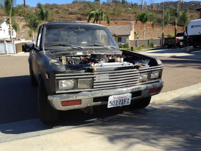

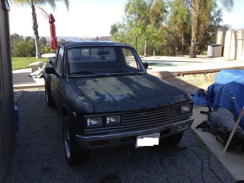

Thanks for the encouragement hotrod80, its been a long road...this truck was a mess when I got it...
Looking forward to an abundance of power! My wife says it sounds pretty "bad a _ _ " with the headers, straight 3" pipes and 3" bullet mufflers.
Gonna be a cool little cruiser when it's done.
I have seen your builds as well as mytmouz's plus the others here on the site, some of the fab skills and race prepped trucks you guys build are first rate.
I feel for the guys doing rust repair on their LUV's (I can relate) some of the restorations I see here are as good as it gets. I wish I had the skills to do it all...
I am learning as I go...more driving and updates to come!

Truck is back together, engine compartment painted, looks much better.
700 R4 was fine but the torque converter failed...trans shop warrantied it, flushed and cleaned, replaced converter.
flushed lines and cooler added a cooler filter as recommended by the shop. Never heard of that, Wix makes a nice little in line filter kit easy install on the return leg from the cooler back to the transmission.
So a good test drive made it back to the house fine this time!! Shifts great to 4th and lock up, cruises great at 65+ just loafs along plenty of power, a little loud though, rides and drives very nice.
It was low 90's Sunday out my way no overheating problems, good oil pressure, 13.5 volts charging, almost made a hardware store run.....
So far so good! Now for the trans tunnel completion. Fiberglass may be the way to go with some glue on insulation.
Gonna put on a drop base air filter and see if the hood fits/works.
The front is a little low, will adjust the torsion bars up a little.
Prime the body etc....still needs a marine gas gauge too.

Thanks love4theluv, it's getting closer....hope to drive it more this weekend. Hook up a fuel gauge etc...that would be smart..
I really like your set up..vortec V6 with the NV3500, plenty of power and O/D..gotta have the 5th gear or O/D these days.
I'm gonna try to get a hood on it also this weekend...
