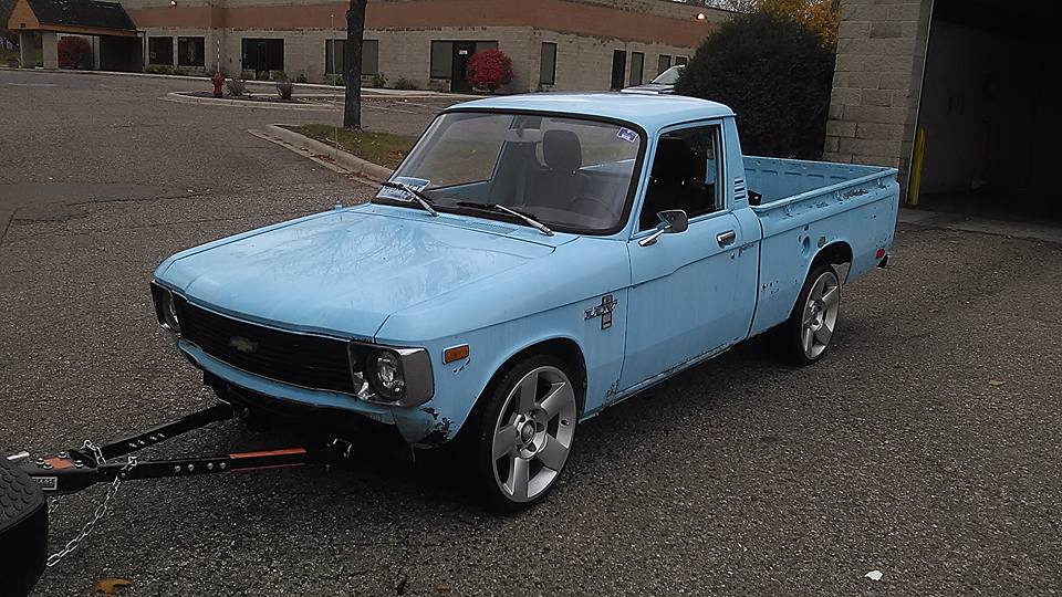

hi i have a 1980 chevy luv 2wd short box, i just bought a complete v8 conversion kit from http://www.powerbyace.com, also i have a 1998 silverado 2wd vortec 350 with 4l60 auto. my plan is to swap the motor, trany and rear differential from the silverado to the luv. i would have a custom made drive shaft. any ideas or opinions about the silverado rear differential?

The rear end will be much too wide.
PostPosted: Wed Oct 28, 2015 6:13 pm
By rear diff a am assuming you mean full axle because a Chevy diff won't fit an isuzu axle unless the rear axle is already swapped to a gm unit. And that axle will be way too wide to swap without being narrowed
but the engine and tranny swap should go very smoothly with the PBA kit
