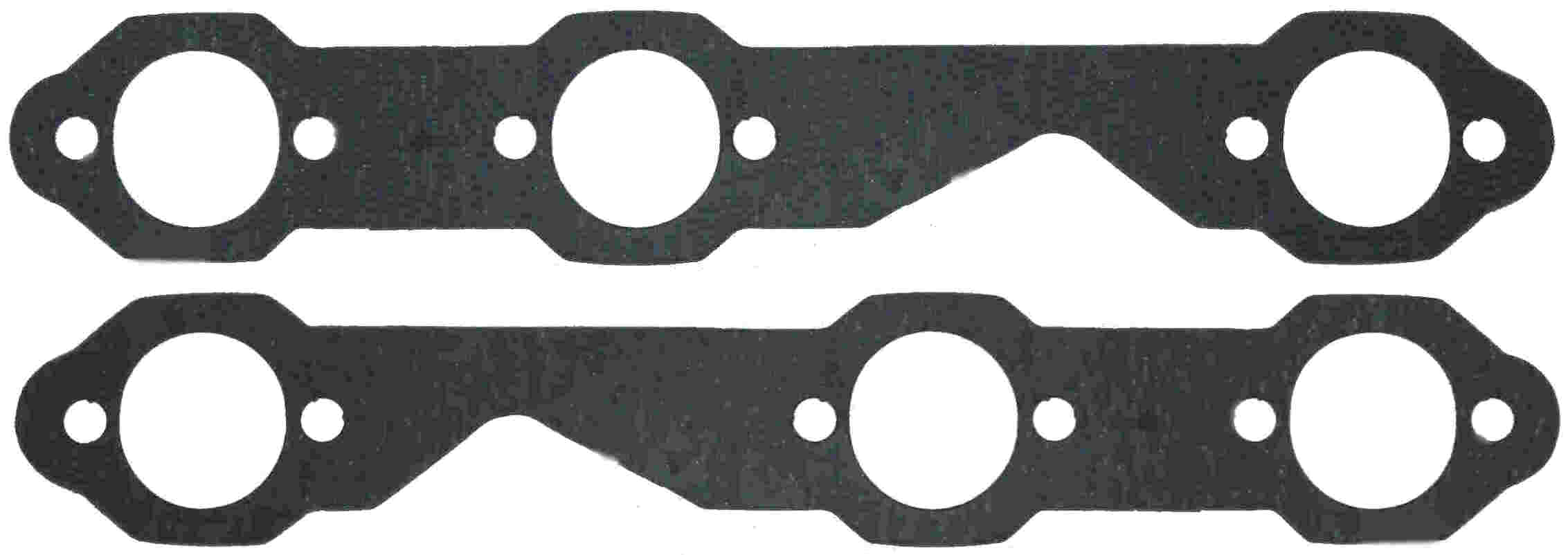

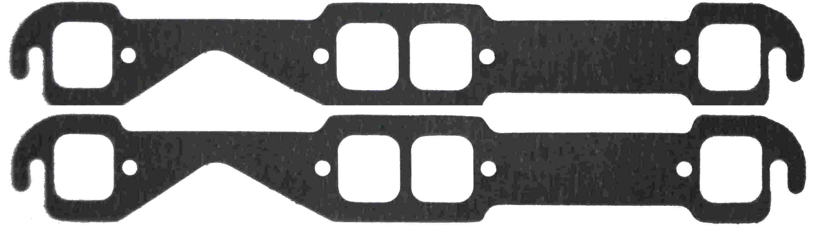

The cylinders that were removed were #5 & #6. These ports were rear of the two center ports. Just cutting the ports off of a V8 flange, you would also be missing a needed mounting bolt. The V6 has no conjoined ports as does the V8, it has three individual ports with two bolts per port.
If you can find a copy of "Chevrolet Power" 1994 GM# 24502488 has blueprints for the V8 and V6 heads, V6 pg# 158.
You also might find the inside cover to be very interesting reading.
1/2" for an N/A engine is extreme overkill. Due to the port separation 5/16" will handle anything you need. The thick flanges are need for the lack of cooling between the center ports. If you're thinking of hanging a turbo onto the flange with no additional support, you'll also want too use 14ga tubing to prevent cracking at the welds to the flange.

Ahhh I see I was thinking the v8 had the same spacing as the 2 close together v6 ports for some reason.
And I am considering a supercharger/lpg build later on down the line which is why I thought 1/2" would be ideal.
Thank you for the information I was way off
