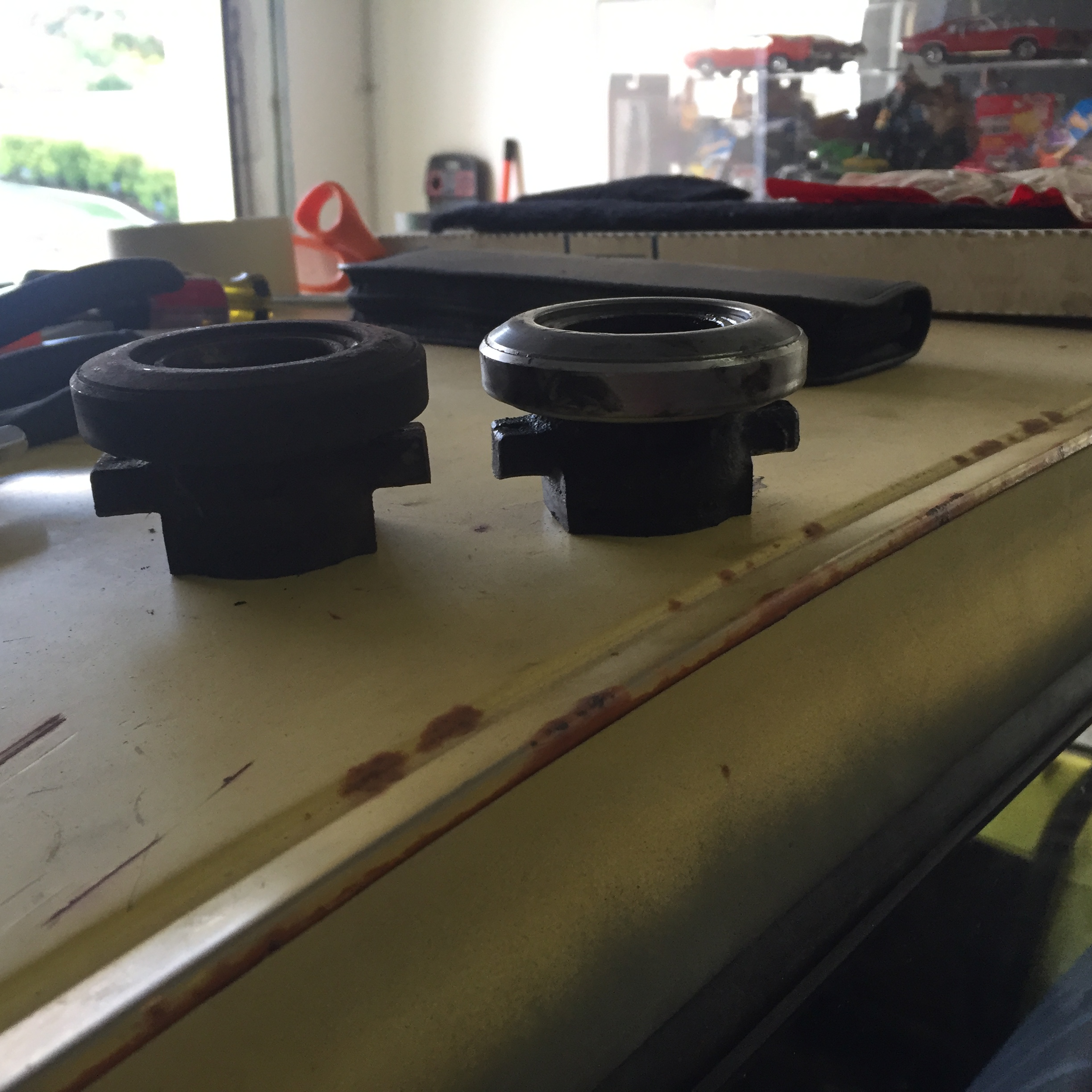

Look at a release bearing for a 2.3 gas engine, see if it is longer & will activate the clutch, that's the engine your tranny would have been bolted to. The clutch would have been the same 8.5" used with the 2.3, the 1.9, the C223 diesel and '80-'82 1.8 4x4 only. Your LUV has a 8" clutch, to upgrade to the 8.5" you need a 1.9 or '80-'82 4x4 flywheel.

Ok, I'll take a look. Bearing with fork arm or would the arm be the same? So as far as the clutch goes, I should be able to use the stock 78? I also got the flywheel with the transmission and the are the same size as the 78 Luv. I don't know that I could fit any larger flywheel even if I wanted to, there is no more room in there.
I took out the trans, it got stuck on me so it took me all day. Tomorrow I will take a look at it to see what the difference is. Thank you for your help.

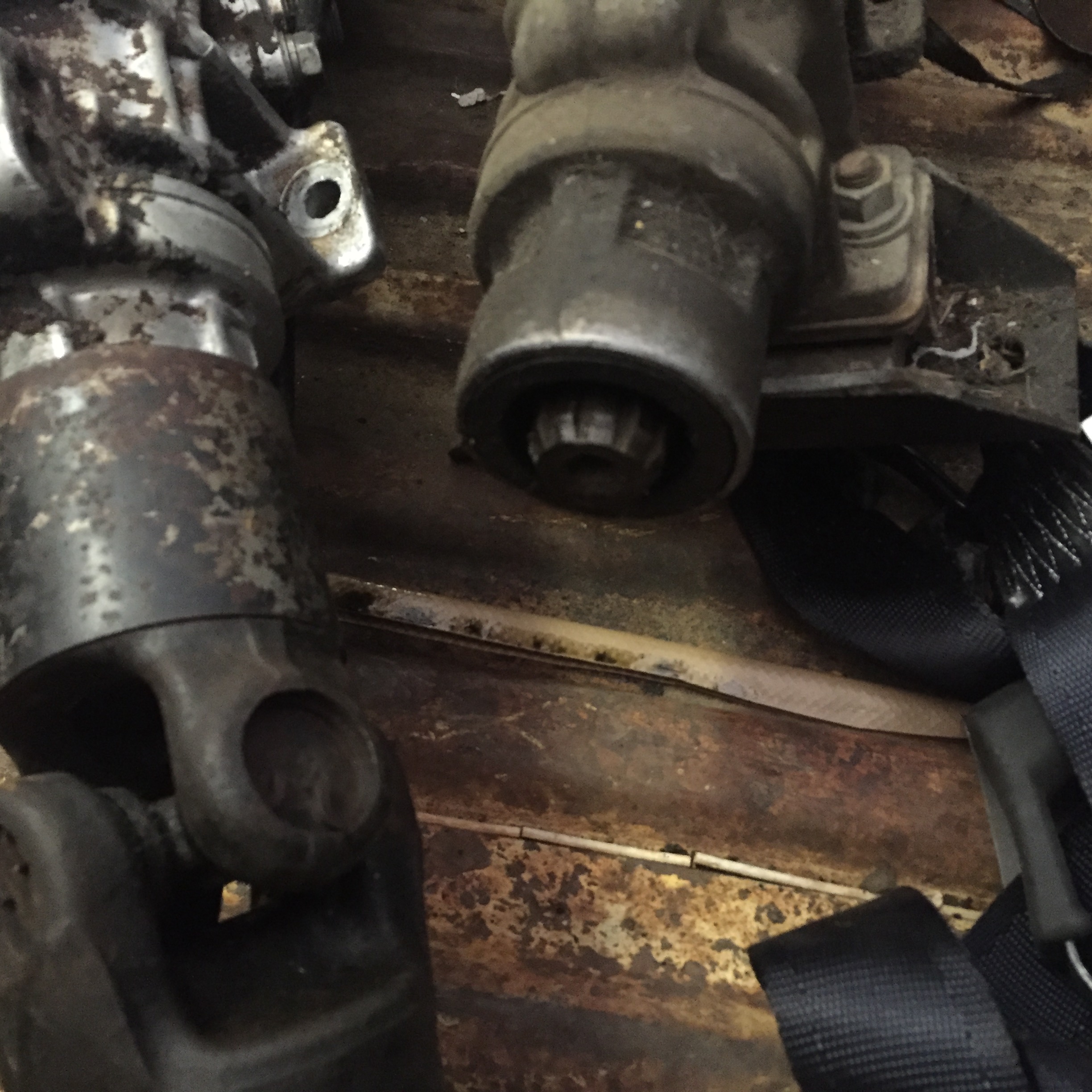

Have you counted the tailshaft splines on your new 5sp? This will indicate whether it's a early or late version, then you'll better know what parts to look for. The late trannies have something like 23 splines, your LUV has about 17, so if you do have a late tranny you'll also need the correct slip yoke to mate to your LUV driveshaft.

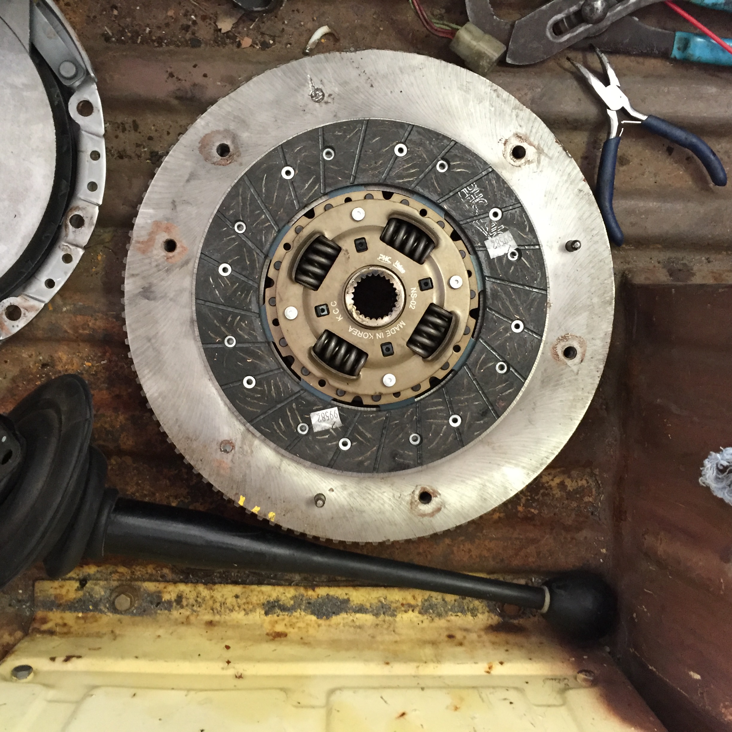

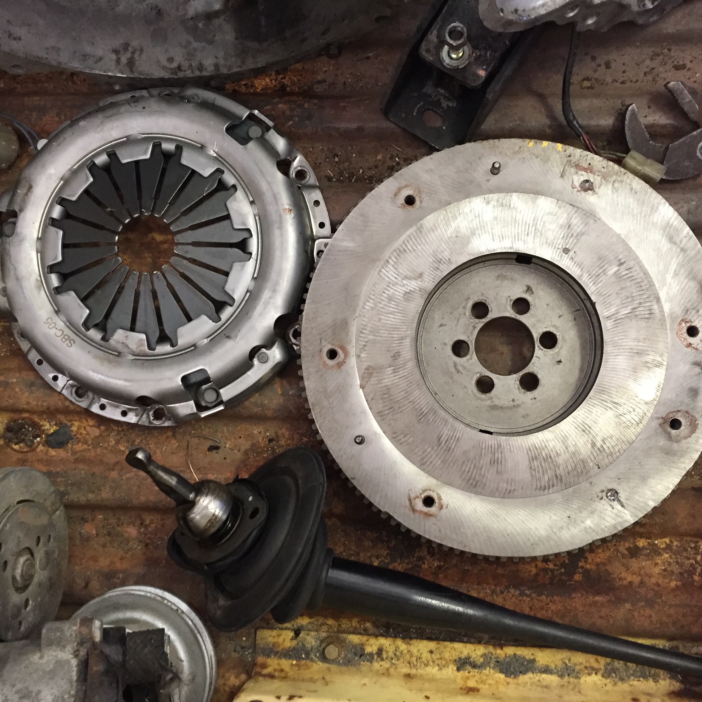

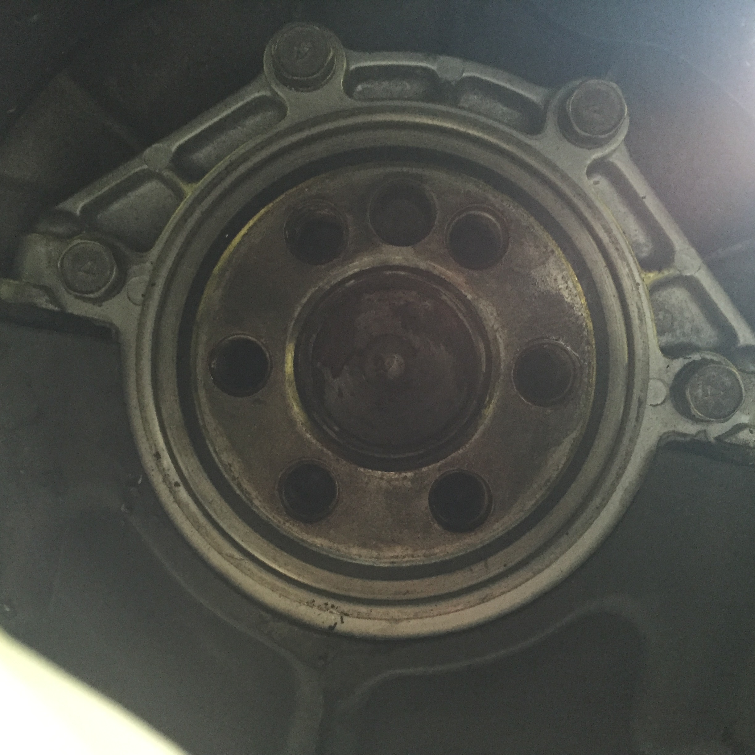

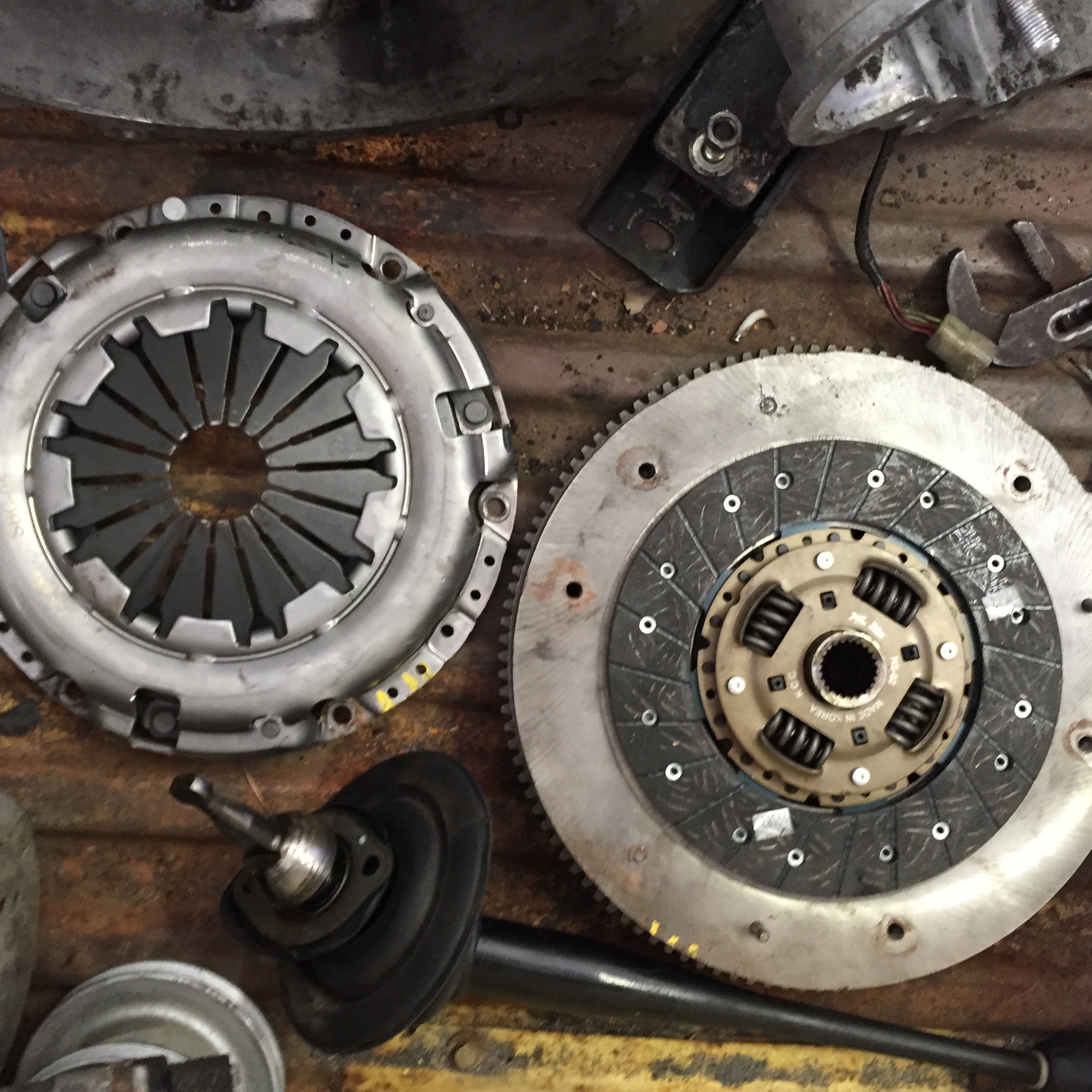

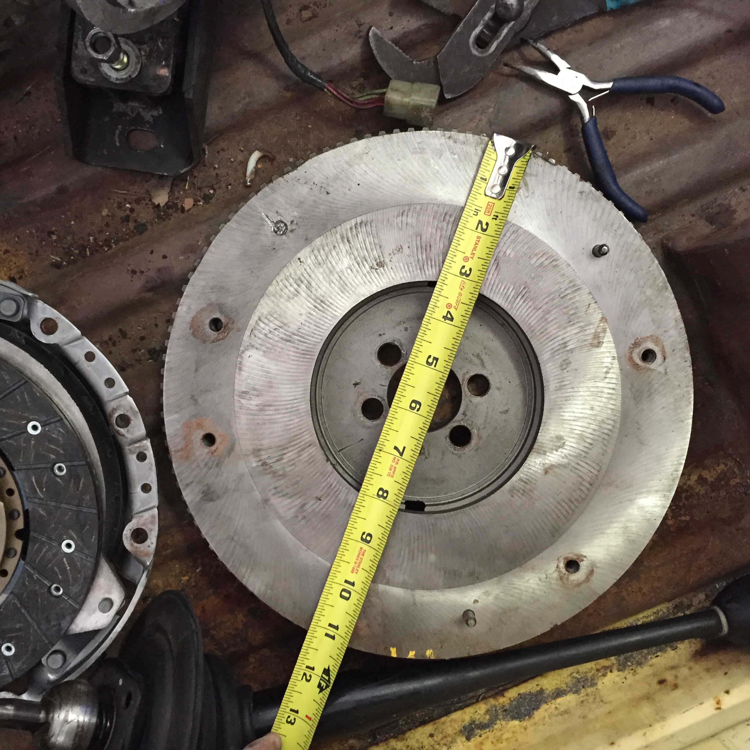

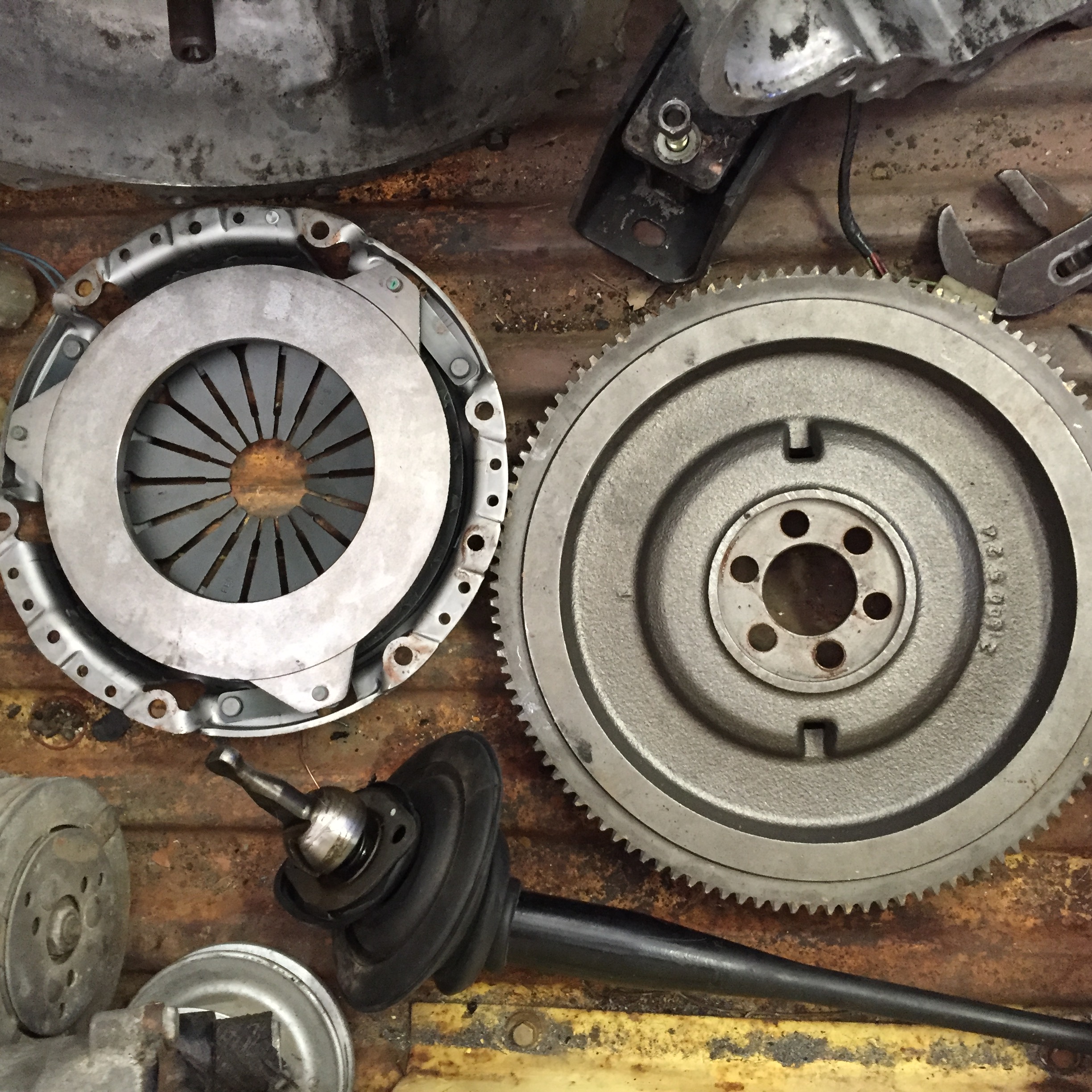

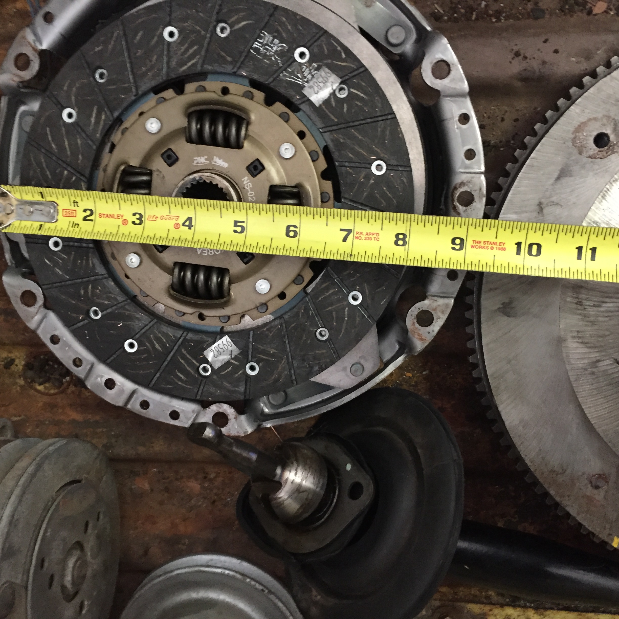

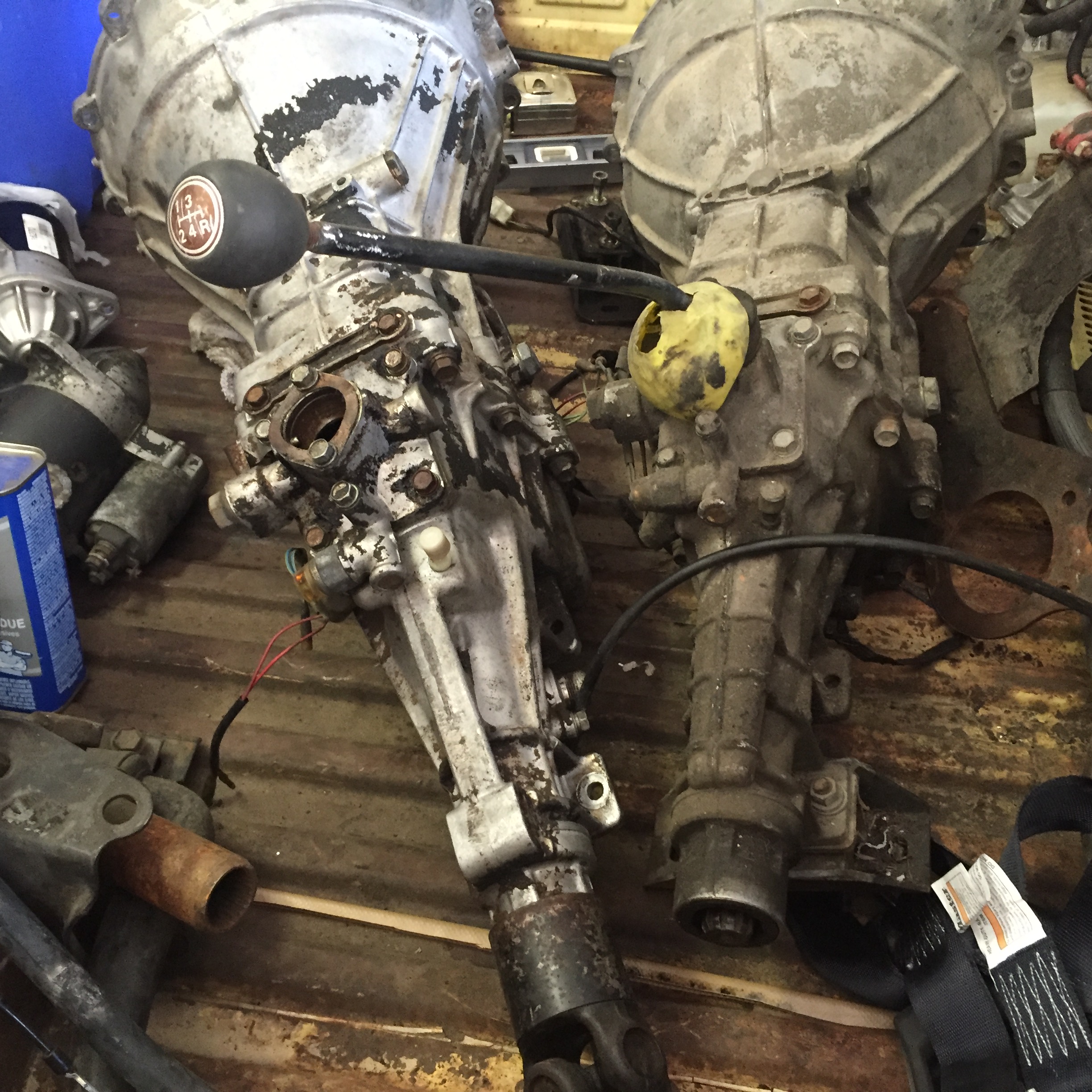

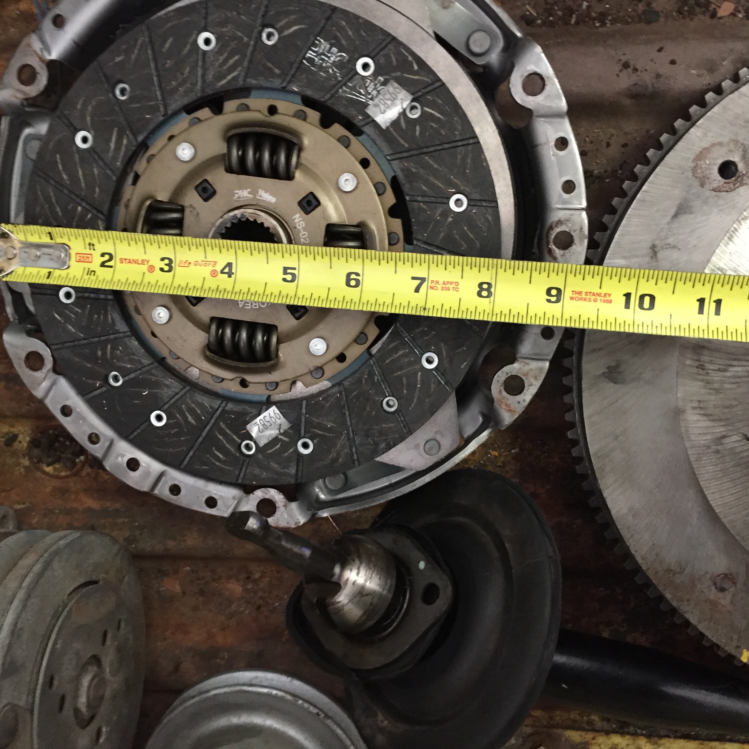

All measurements look the same to me. I believe the 4 spd spline count was 10 and the 5 speed was 18.
I broke a couple of pressure plate bolts on the flywheel, fixed one. When I took out the clutch/flywheel, the pilot bearing fell out.
 Post subject: Re: 5 spd Swap Problems
PostPosted: Sat Jan 09, 2016 4:56 pm
Posts: 262

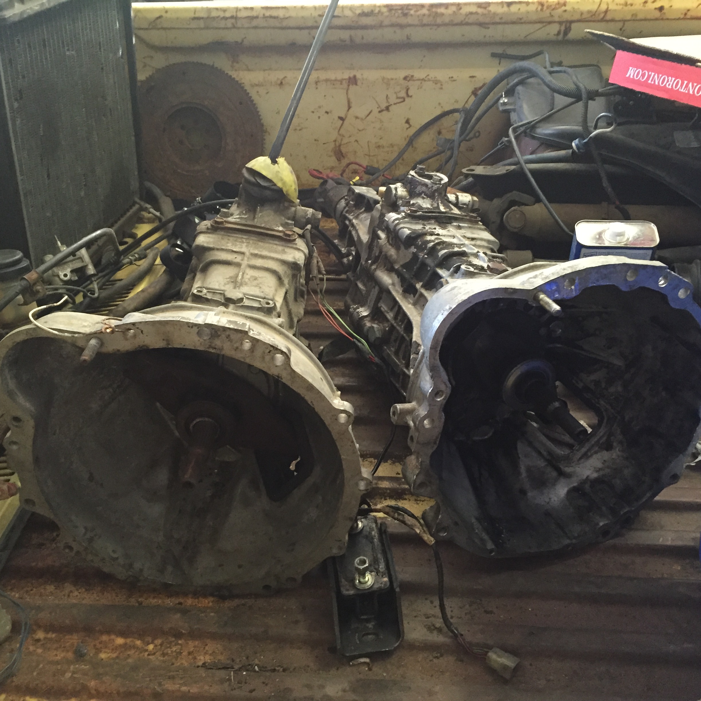

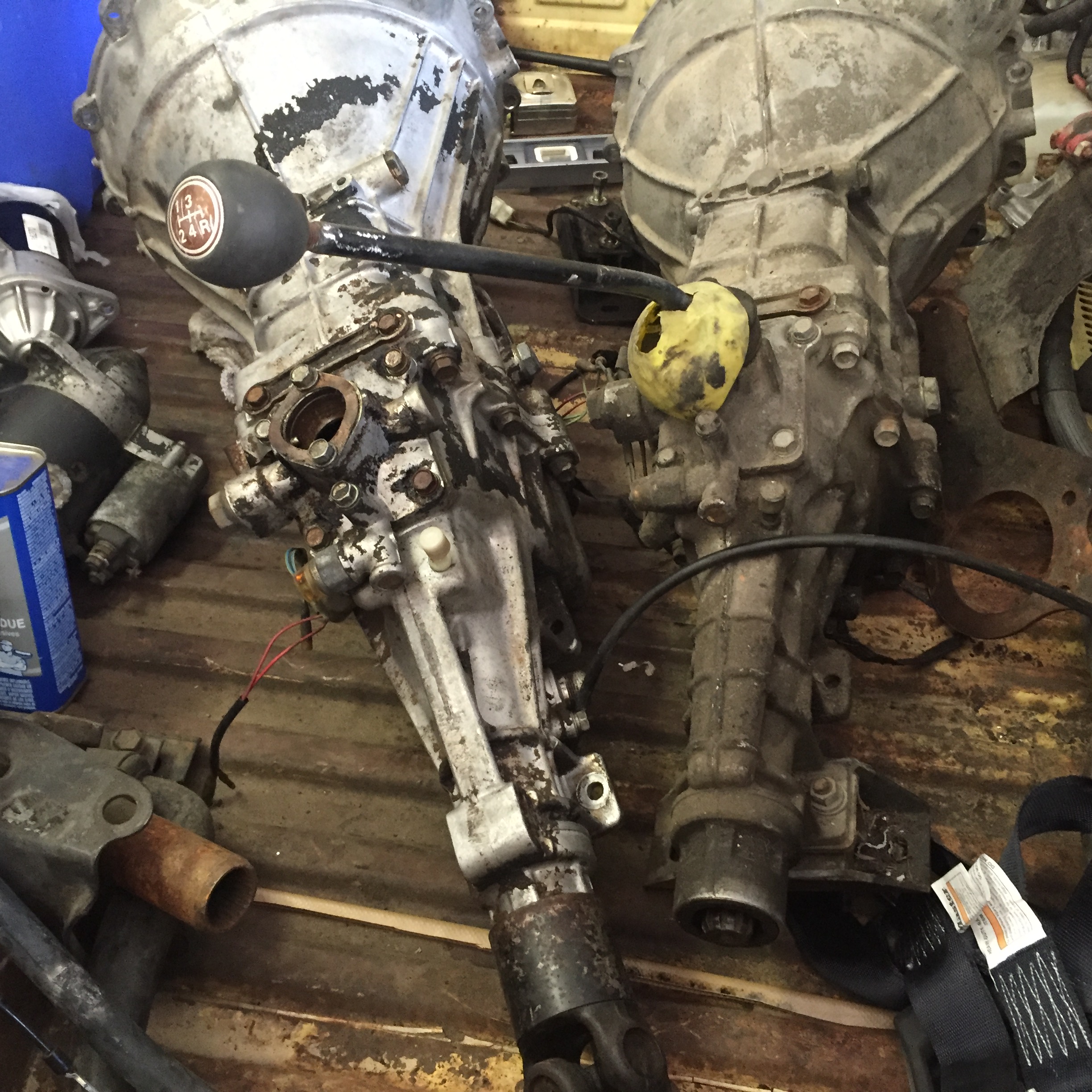

Trans
PostPosted: Sat Jan 09, 2016 4:58 pm
Posts: 262
Trans
PostPosted: Sat Jan 09, 2016 4:59 pm
Posts: 262
Trans

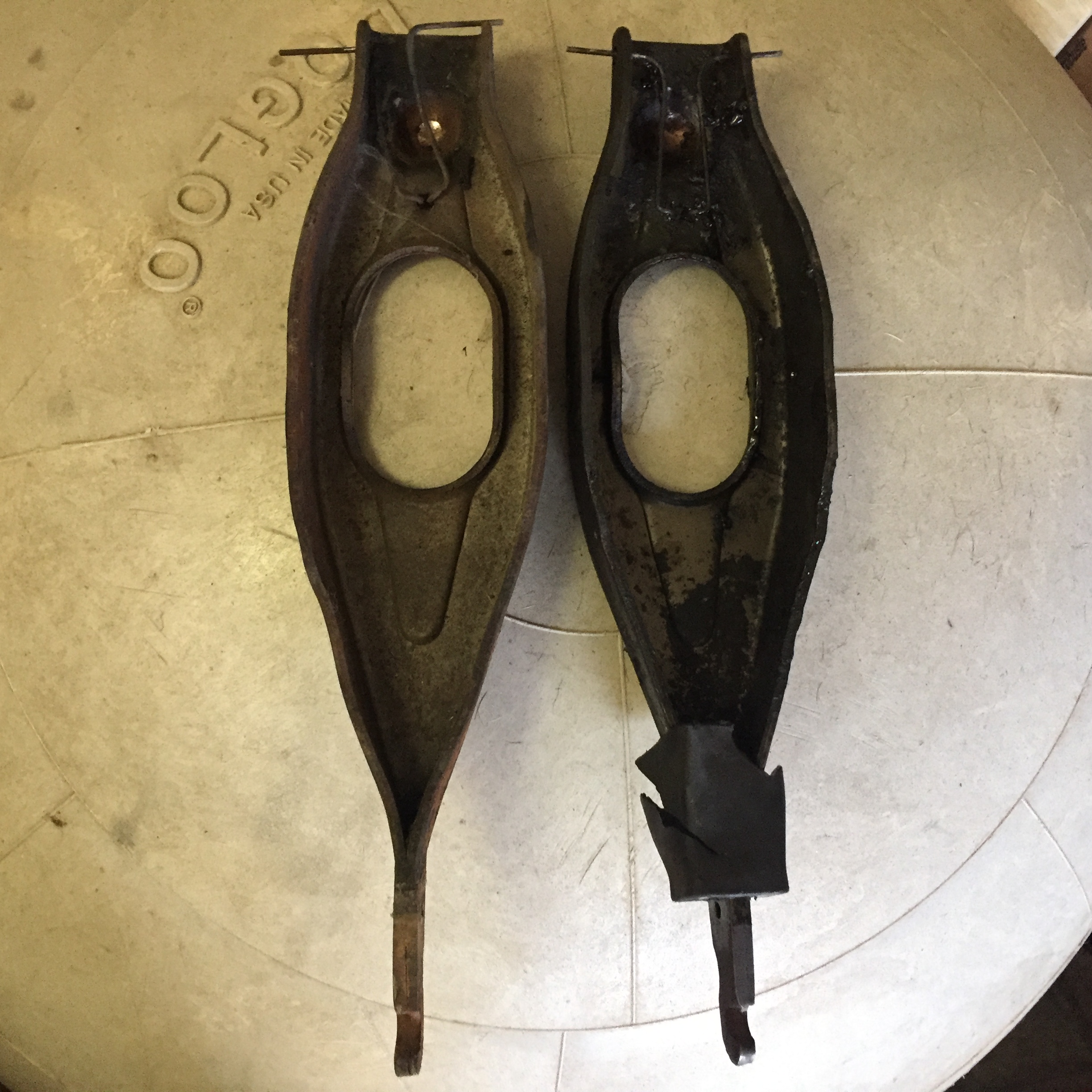

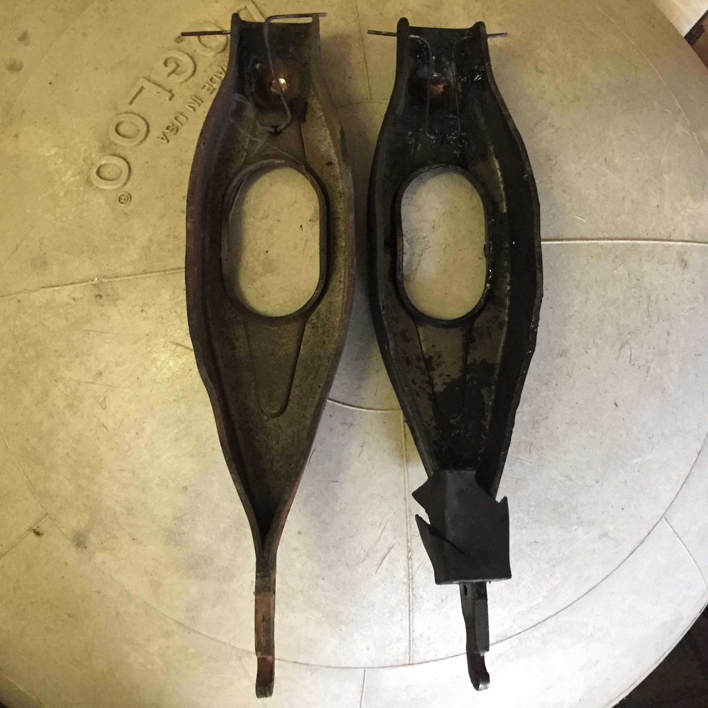

When you say it was "at the end of it's travel" was the clutch arm actually hard against the opening in the tranny? Are the two clutch arms identical, they look to be in the pictures? Will the 4sp clutch arm swap to the 5sp or is the pivot ball in the wrong place? If the travel measurements are the same and the 4sp worked I'm not seeing where the 5sp won't also.
One thing to try, put the 4sp back in, move the clutch arm in the same manner & see if it also looks like it's not engaging. If not report back on how it's different.

Yes, the fork hits the opening of the transmission. The clutch arms do swap between the 4spd and 5 spd, they are the same.
My brother looked at everything, said everything was the same and we began to install the 5 spd. As we put it on, there was about an inch and a half left before attaching to the trans to the engine completely. He looked into the fork hole and saw that the throwout bearing was not close to being where it should, 2+ inches out. His thoughts are, its the pressure plate. The pressure plate needs to be taller, we have the wrong one. I called numerous Autoparts store but no luck. Some places don't even have part numbers in order to order them.
I'd like to take a look at different pressure plates, impulse, pup, and Luv. The pressure plate I have measures about an inch and a half from bottom to top. I don't know what the others measure.
