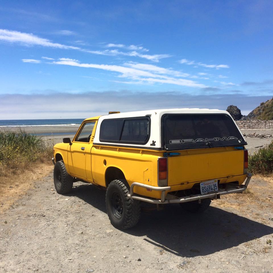

my 1.8 has serious issues and I was wondering what engines can easily be swapped. I am not a mechanic or anything but I read that an isuzu 2.6 from a trooper will work? could anyone send ideas or advice it would be appreciated. I feel the 1.8 although slightly built is pretty under powered. thanks

All Isuzu 4cyl engines have the same bellhousing bolt pattern, so all will bolt to your tranny. Use the oil pan from a 4x4 version to clear the front differential. For a 2.6 swap also use the intake, carb, distributor & flywheel from a 2.3 to eliminate the EFI/computer & allow you to use your stock fuel pump & clutch. This swap puts out about 115hp with no engine mods, a stock 1.8 is 80hp. Expect clearance issues at the firewall & possible cooling/radiator mods. You'll need to use all the 2.6 engine accessories & brackets.
