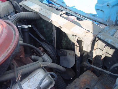

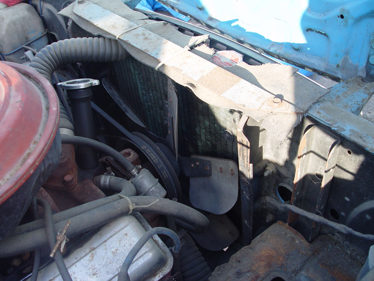

The size sounds right. My radiator is in front of the core support. My support was cut back in the day using the article in Truckin' magazine but didn't have to be. I have 1-1.5 inches between the fan and the Radiator.
This is a brutal picture from when I bought my truck but shows where everything sat. My radiator is a stock Luv made into 4 row.

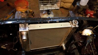

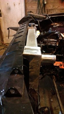

here's some pics. would rather not ditch the hei but I don't want to cut up anything else. I just started redoing the engine mounts today to push the motor back 1"

Cut out the arches under the top of the core support and move the radiator down and under the top piece , if that makes sense .

Thank you for the help guys! Got the radiator in today, pics will be in build thread. but still need a little more room. Will be working on getting the mounts to push back the motor 1" tomorrow. While we are on topic of v8 swaps, what are you guys running for throttle linkage/cable setups?
