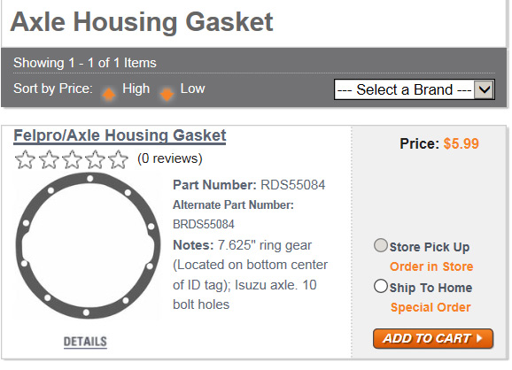

My local Autozone had the gasket in stock, it looks like you have to order it now.

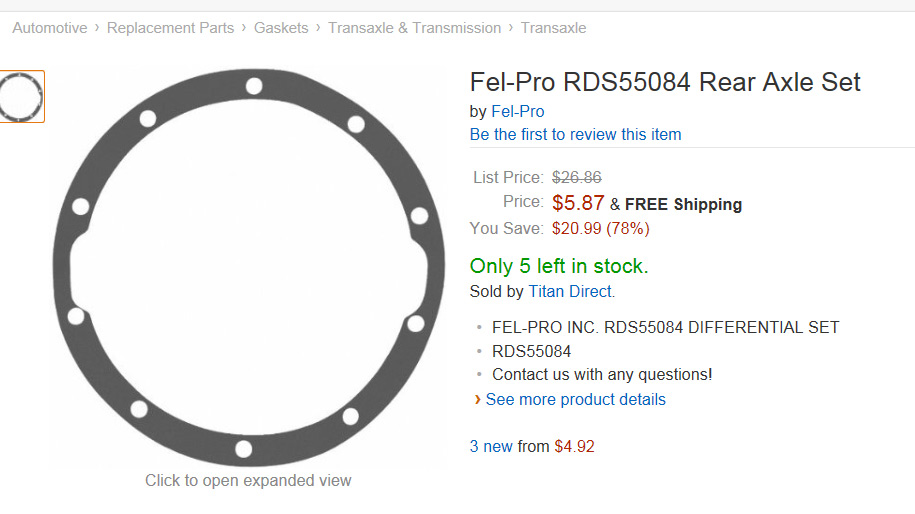

They are on Amazon too

I appreciate it guys! Our local Advance Auto has the gasket, as well. 8)
