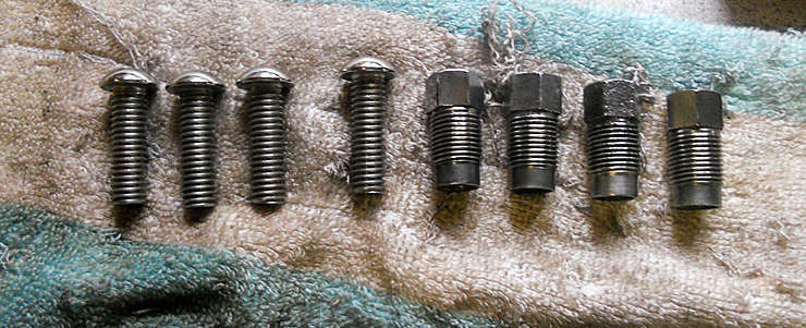

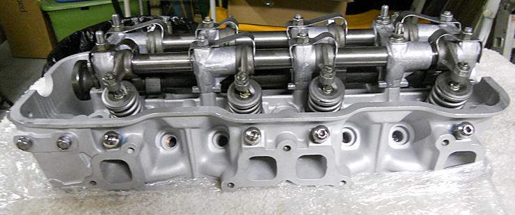

I REMOVED THE AIR RAIL AND CUT THE FITTINGS OFF OF THE TUBES. I TAPPED THE FITTING TO 3/8" AND SEALED AND THREADED STAINLESS CAP BOLTS IN THE FITTINGS. THE BOLT ENDS MATCH PERFECTLY WITH THE FITTINGS.

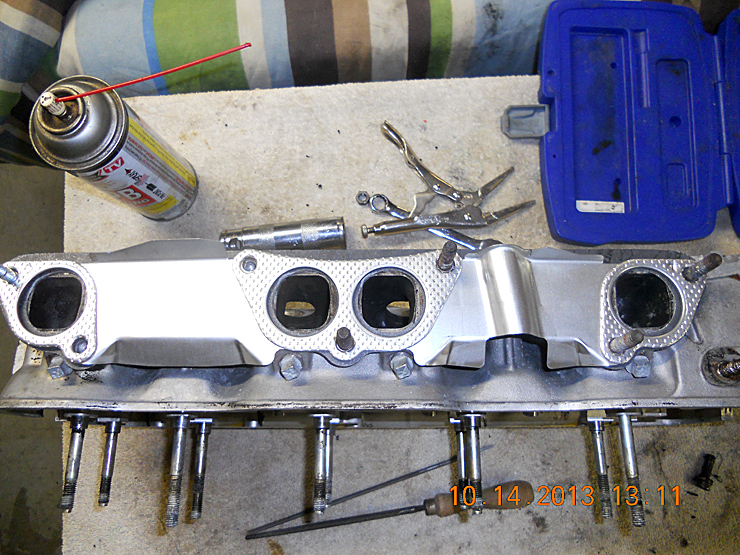

THE FIBER GASKET THAT CAME WITH THE HEADER WAS NOT, BY ITSELF, ACCEPTABLE TO ME SO I SET OFF ON SEARCH FOR A BETTER OPTION. I WENT TO NAPA AND THEY HAD NOTHING IN STOCK, NEITHER DID O"REILLY. ADVANCE AUTO WAS THE LAST CHOICE I HAD AND ARMED WITH "CROSS-OVER" YEARS AND MODELS. I HAD THEM LOOK UP GASKETS FOR 1.9, 2.3, 2.6. THE 2.3/2.6 WAS THE OPTION I WENT WITH. I WAS, INSTALLING THE HEADER (ROUND-PORTED) DESIGNED AND SOLD FOR THE 2.3/2.6.
THE GASKET THAT "PACESETTER" SENT NEEDED TO BE CUT A BIT TO FIT THE EXHAUST PORT. THE COMBINATION OF THE PACESETTER GASKET AND THE FELPRO IS A PERFECT FIT. I HAD TO MODIFY THE FELPRO JUST A BIT BY CUTTING THE METAL FLANGE AND REMOVING A SMALL AMOUNT OF MATERIAL. I DID NOT INSTALL THE SPARK PLUGS UNTIL THE HEAD AND HEADER WAS INSTALLED AND HAD NOT NOTICED THAT THE METAL FLANGE WAS CONFLICTING WITH THE PLUG WIRES. i HAD TO USE TIN SNIPS TO REMOVE PART OF THE FLANGE. IT LOOKS LIKE CRAP NOW ( SEE PICT.), BUT A 1/2" SANDING WHEEL ON MY DRILL WILL TIDY THAT UP.

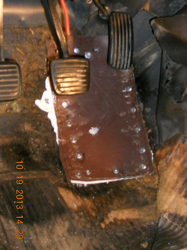

I WAS SO HAPPY THAT THE HEADER WAS INSTALLED AND I WOULD WORRY ABOUT THE E-BRAKE LATER. WHILE WORKING AT THE COLLECTOR, I THEN, SAW, THAT I HAD MISSED THE ISSUE, THAT I WAS ABOUT TO BEGIN PLANNING, HOW TO REMEDY. THE HEADER WAS ONLY 1/8" AWAY FROM THE FLOOR BOARD, DIRECTLY BEHIND THE GAS PEDAL. NOT MUCH ROOM FOR CUTTING TOOLS WITH OUT REMOVING THE GAS PEDAL ASSEMBLY ( I DID NOT WISH TO DO THAT) I USED AN 1/8 DRILL BIT AND DRILLED AN OUTLINE OF THE PORTION OF FLOOR I HAD TO REMOVE. I MADE A PATCH OF TRIPLE LAYERED FLASHING I HAD LAYING AROUND AND ATTACHED TO FLOOR WITH WITH RIVETS AND SCREWS. HIGH TEMP SEALANT WAS USED BETWEEN METALS. IT TOOK A WHILE (MOST OF THE DAY), BUT I WAS ABLE TO INCREASE THE CLEARANCE TO 1 1/2". I INSTALLED INSULATING PADDING AND RE-INSTALLED FLOOR COVERING

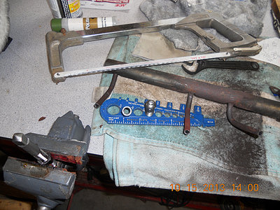

THE COLLECTOR IS ABOUT 7 INCHES FROM THE CROSS MEMBER. THE PIPES/CONNECTION SHOWN ARE TEMPORARY. I USED A DOWN PIPE FROM MY OLD JEEP 258 FOR THE TEMP. INSTALL. IT HAS THE PERFECT DEGREE OF BEND TO FIT BY THE CROSS MEMBER. THE ENTIRE, 2" SYSTEM (CAT, MUFFLER,DOWN PIPE) TEMPORARY EXHAUST IS OFF THE 1986 JEEP CJ7 258. ALL IS VERY QUITE BUT THE BACK PRESSURE IS INADEQUATE
