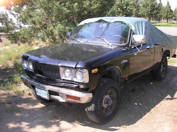

Probably only lifting body 1"
Looking at a Luv 4x4 on the internet today for $550. So ya never know what tomorrow might bring.
