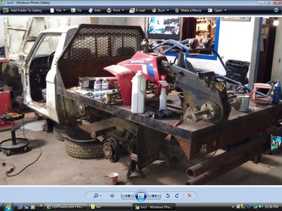

just some info somebody might like. I had to pick all the parts sepretley. the kit with the same parts is $65 plus shipping. but if you piece everything togeather its around $35. Its my first luv its a 1980 4x4 stake bed. I will post some pics. also I've been looking on the best way to tackle the job. I'm using the forum search function. and I think pulling the motor and trans is what I'm going to have to do. I dont know if all 80 4x4's have a welded trans cross member but mine does.

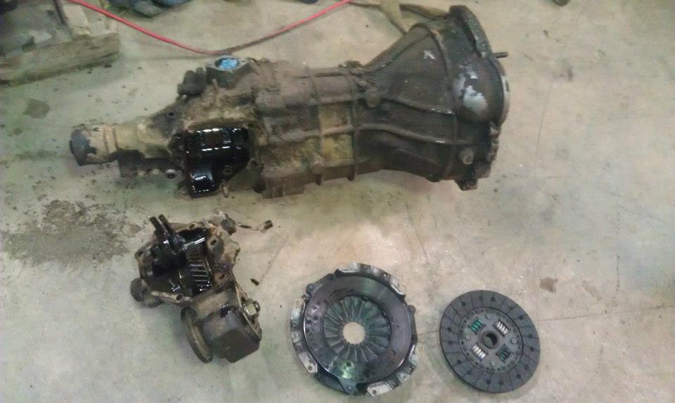

thanks for the help it really does have to spin 90 degrees to come back far enough.
